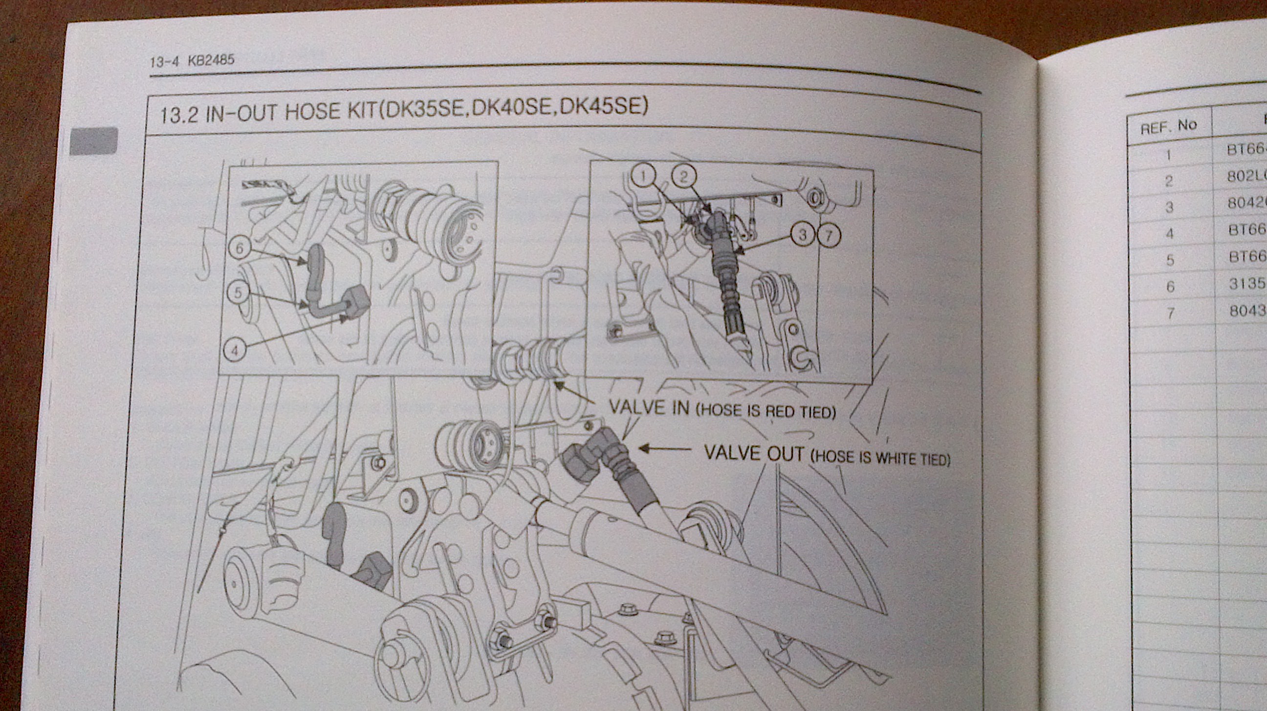

Would it be possible to get some pics of the installed kit? You know what they say A picture is worth a thousand words!

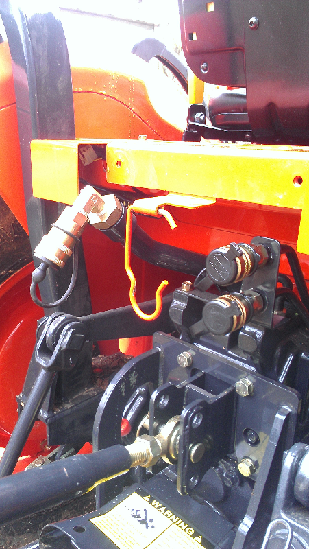

This is the factory kit on my CK 35HST.

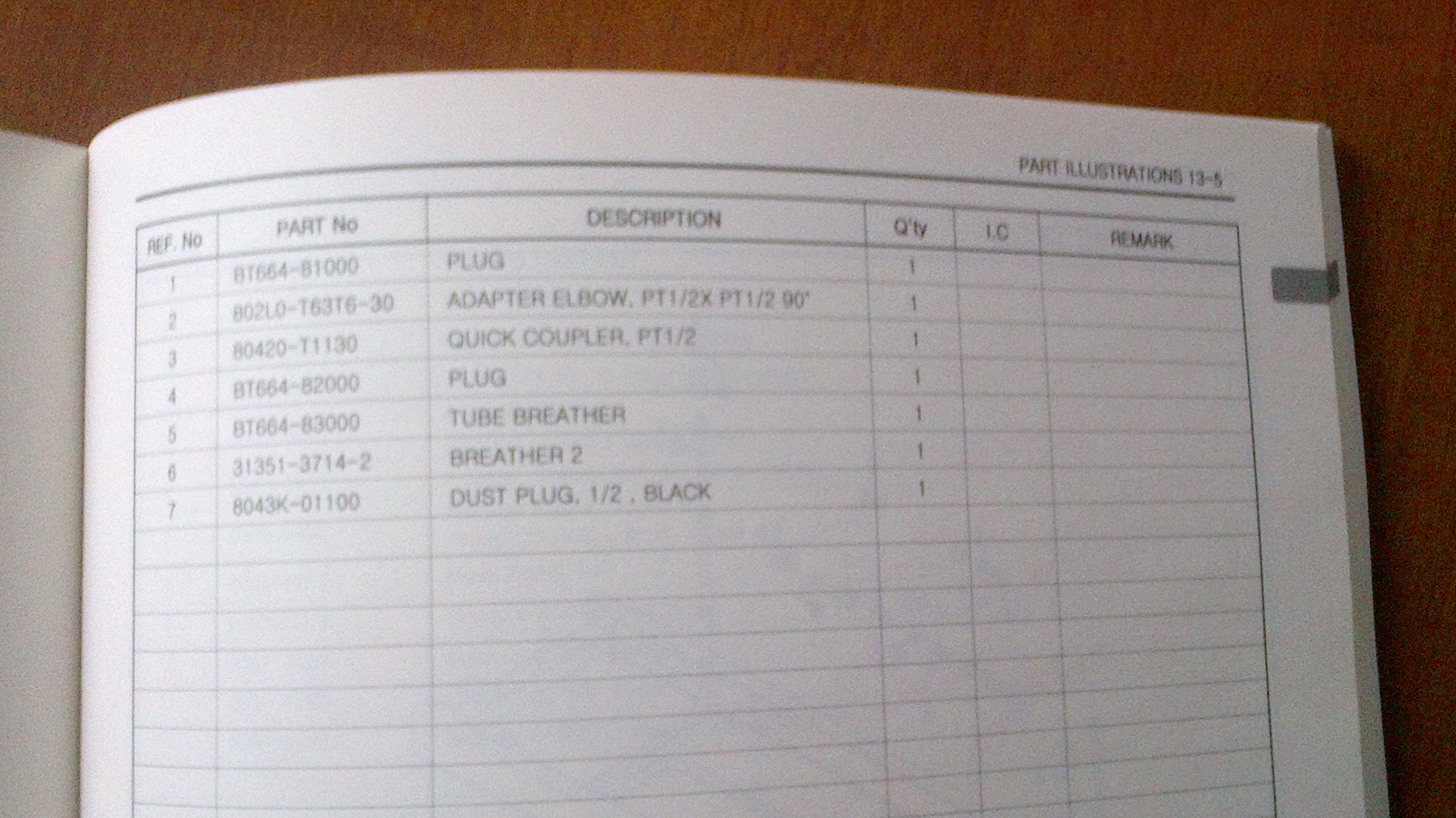

It's in the Backhoe Manual on page 13-4 and the parts list is on page 13-5. Hope this helps.

That's a good pic, and on the DK series it's on the opposite side of the tractor. And the relocated breather shown in the backhoe manual, in the post after yours, is similar but somewhat updated as to where/ how it connects to the side of the tractor.
If it were me I'd talk to the parts dept guys instead of the salesman, especially since he doesn't seem to know what you want....
