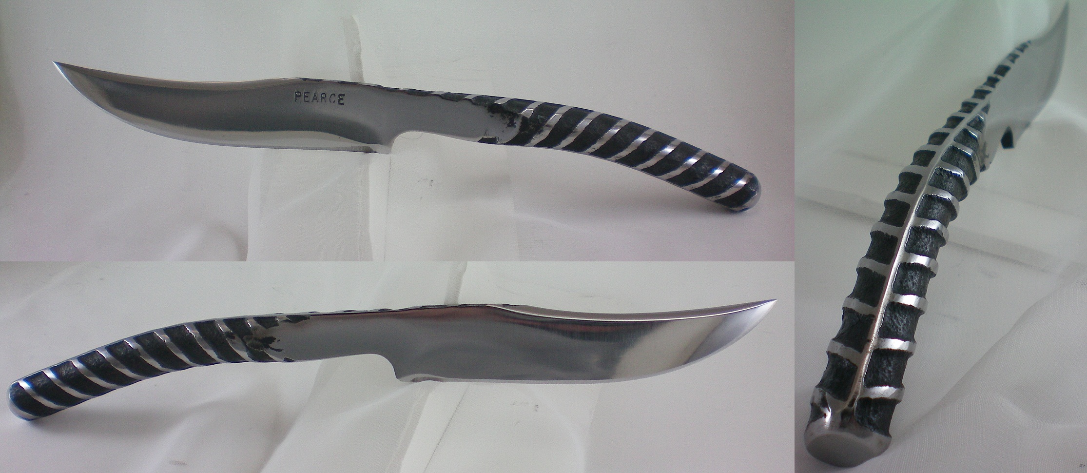

To deviate a little. Here is something else one can make out of rebar.
i'm planning on making a knife and a small hatchet with a hammer hear rear out of 2 railroad spikes I have. just waiting for some spare shop time.
