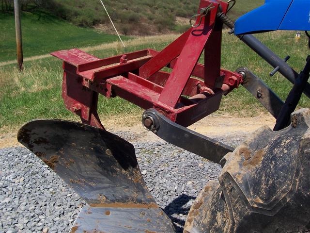

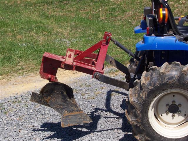

Here are some pics of an International 12" plow. When I bought this for a friend two years ago it was $250.

Thanks for the pics!!! Something I will look in to....
