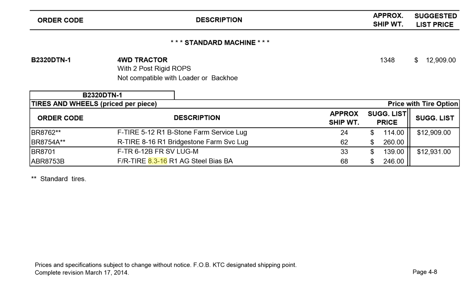

Below is an example from the Wholegoods price list for a 8.3-16 tire/wheel assembly albeit for a B series tractor. As you can see, the price list is from March 2014, so it should be fairly accurate. (see wholegoods picture below)
Wholegoods: Kubota 8-16 Wheel.png

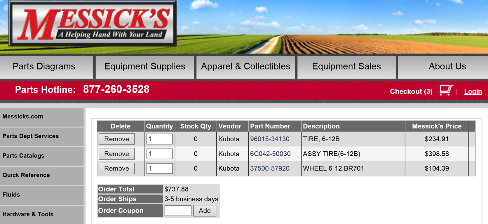

If a tire and wheel assembly was sourced from Kubota through their parts department the tire assembly would be $398 versus $248 through wholegoods. (see parts below)
Parts (from Messick's website): Kubota 8-16 wheel via parts.png

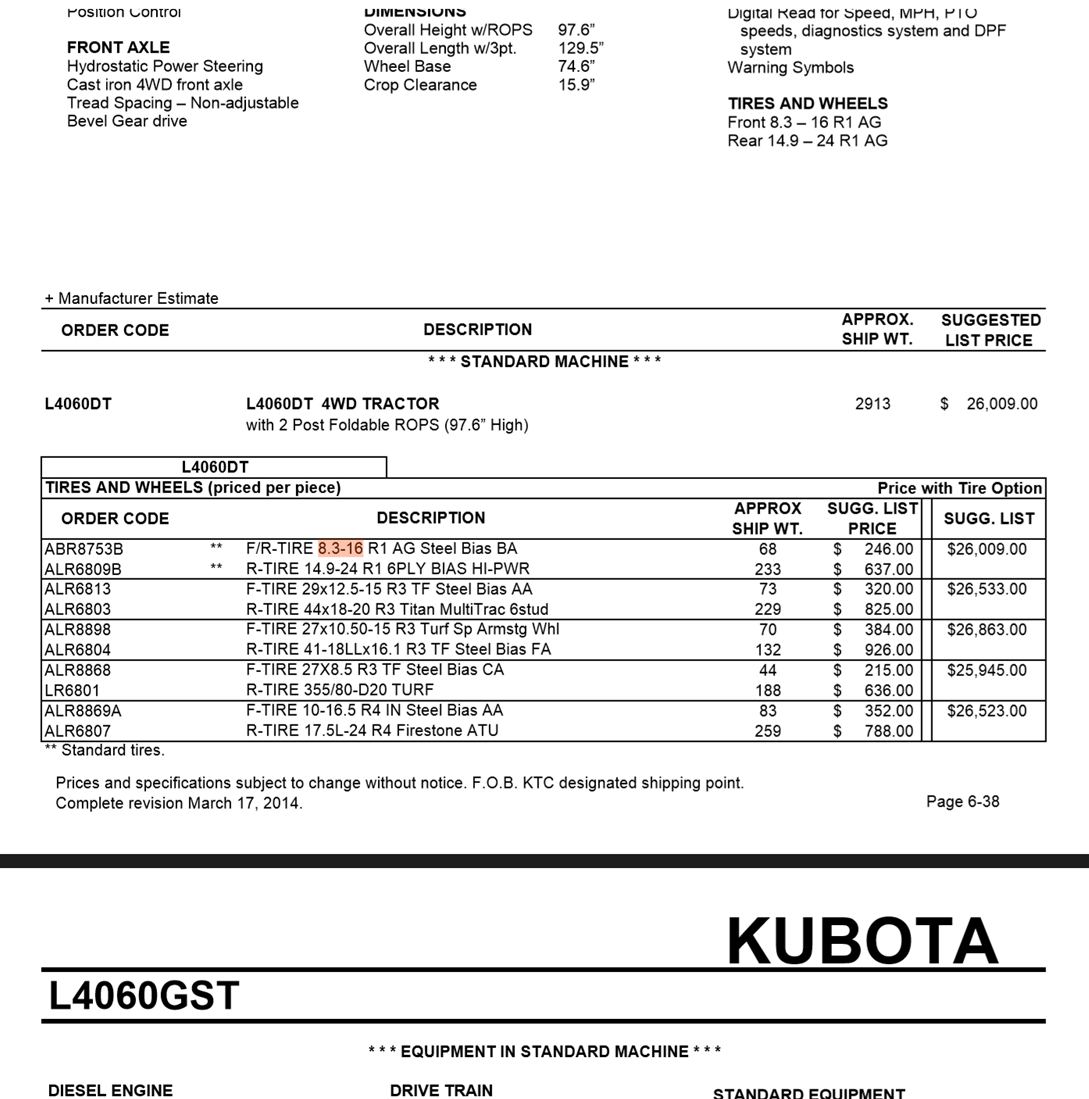

Added in edit 03-03-15:
This is for a L-Series tractor.
WARNING: User responsible for verifying Part Numbers for L4400. Above info for reference info only.
