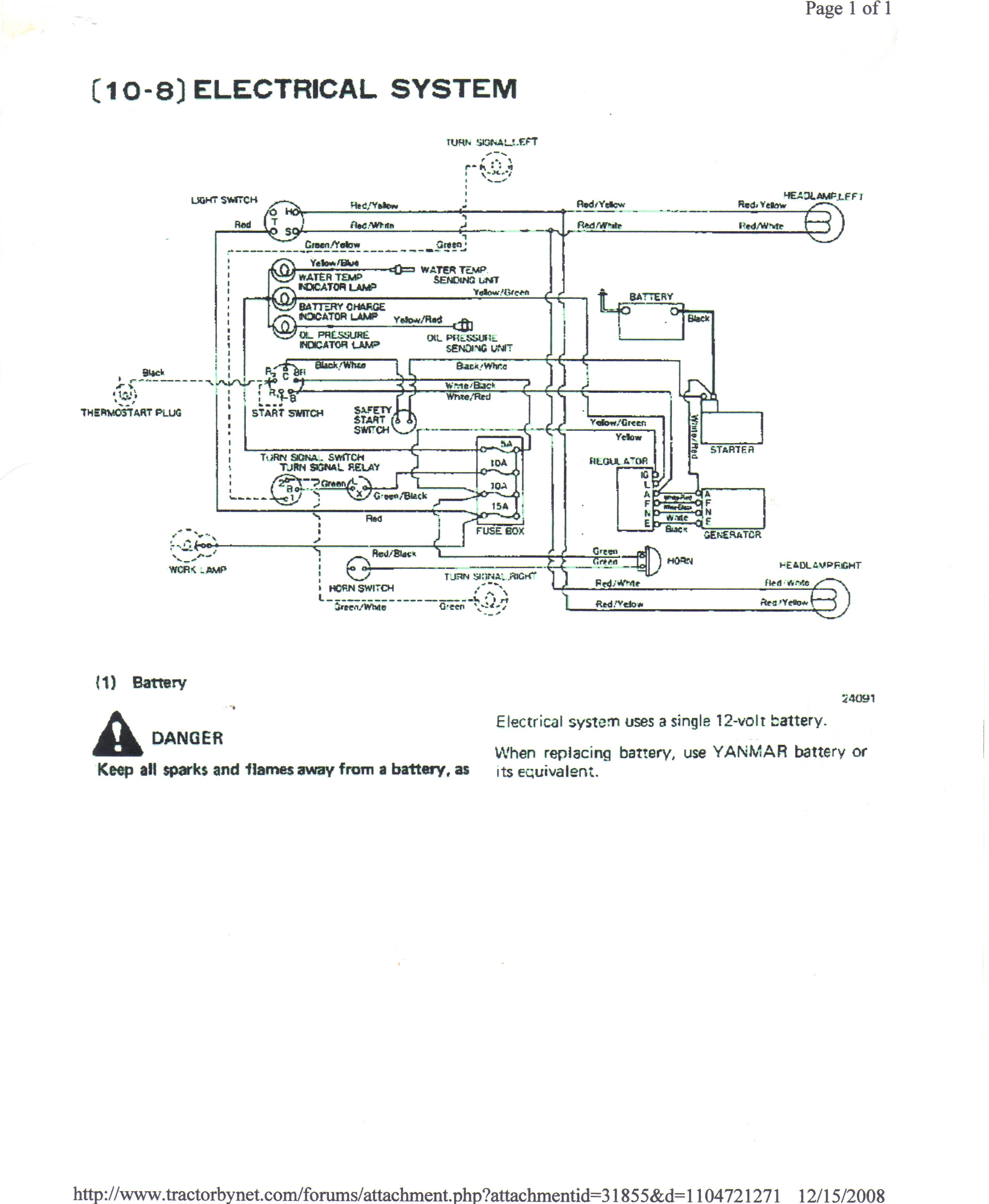

#1 in picture
Power comes from key switch,when turned left.
   / Where does this go? #3
Hoye is showing the same Thermal/Glow plug as my Ym2000. If your Ing. switch is the same then here's a wire Dia. Just a lead from the R2. Circuit. Turn the switch to the left.:) If you don't have a Fuel Bowl which I don't. And Rarely have I had to use the TS.. So here is my Quick setup. Works great and the only thing you may need to do is give it a little squeeze to blow the air out of the line if needed. Wait until it gets hot so the TS is open. Then I squirt what's left it back in the Tank. ;)
   / Where does this go? #4
In the diagram, it shows a horn switch. I would love to find one of those to hookup.

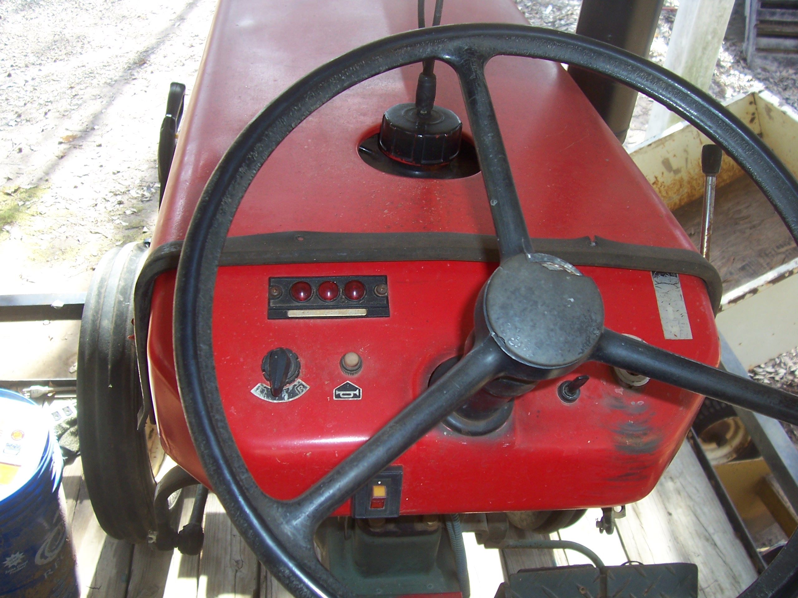

Here's proof it's there. And mine works. Think back to the Road Runner in Cartoons and that's what it sounds like. Can't help not to smile.:D
   / Where does this go? #6
I tried Hoye, Fredrisks and others, but they no longer carry the switch. My YM2610 came with a horn up front betwix the head lamps.
Hey, what's that added switch down below you had added?
   / Where does this go? #7
Headlights. The Black toggle is my Rear work light. Tach. behind the Steering wheel. It was setup like this when I bought it. I had the switch out just to see how it was cut in the dash. It's to clean of a cut. Perfect!. IMO. it's Org.. Trust me! I left Steve at Spalding a Chk. for this one until I could get back to pick it up. :D
