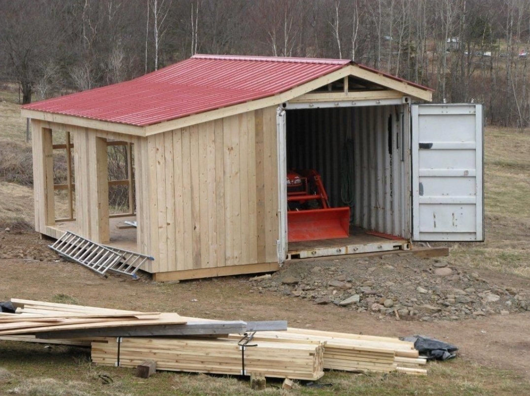

I don't exactly understand why, but those seem to be somewhat notorious for "container sweat". Not sure I'd want to keep a tractor in one unless I took steps to reduce it. Maybe you have/will, just thought I'd mention is.
My high-cube has small vents near the top on the sides, and it's sitting about a foot off of the ground (well, 6" at one end and about 16" at the other end) on RR tie blocks under the corners. We have pretty wet winters - zero noticeable humidity inside. I help a local music camp that stores a bunch of stuff in a couple 20's and they had really bad moisture issues; we jacked up the containers (farm jack) and put them on blocks and no more inside rain despite them being placed over totally unprepared surfaces.
Just make sure there's enough room for small predators to get under the container to keep vermin from nesting there.
I'd be really really careful driving a cabbed tractor in any container; probably best to have a level entrance. Web says my tractor is 98" at the rops, and I have a very short gravel "ramp" for it to get in (remember the container is up off the ground) and while it's got a couple inches to spare it feels like it's about to hit the roof, probably because of the angles.. and definitely don't want it to bounce going through the doorway.

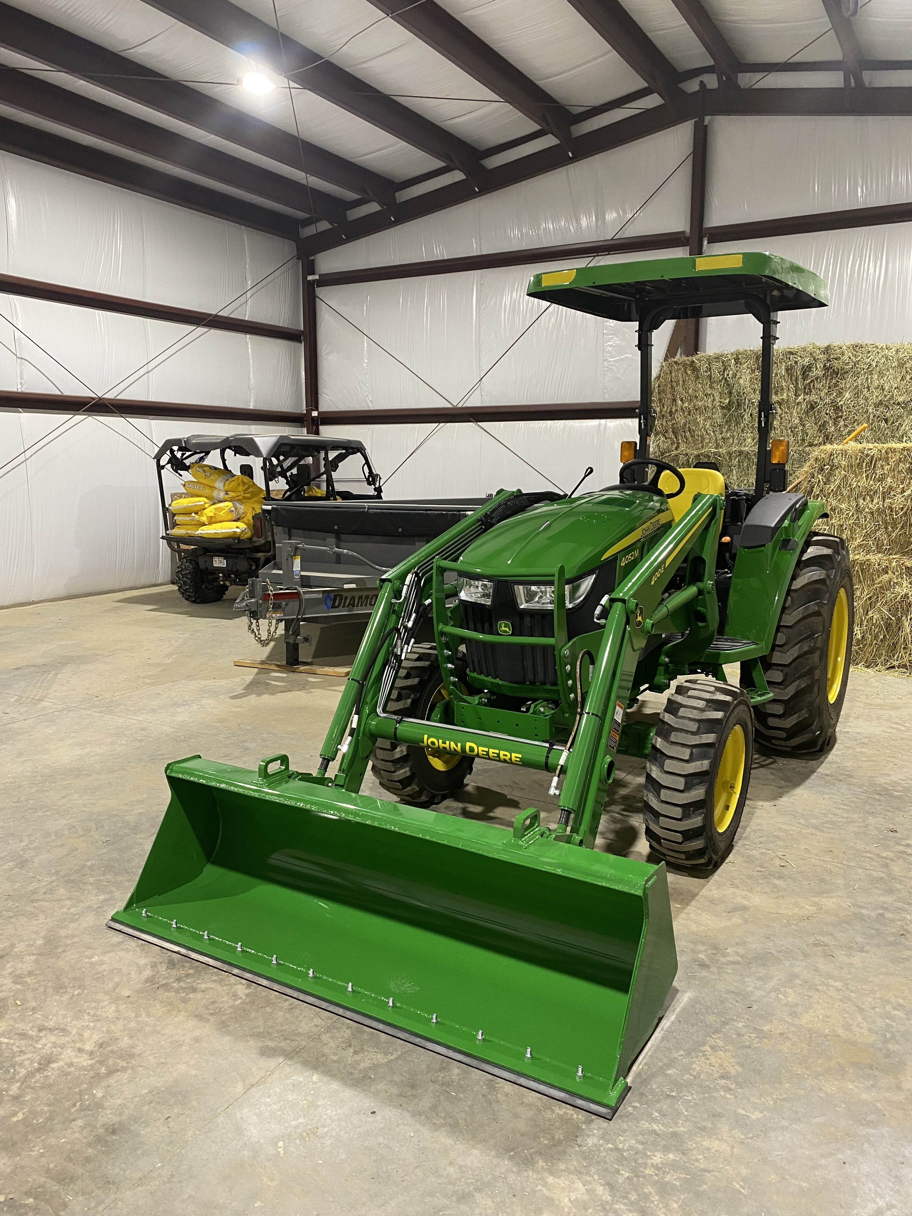

I have an 40’ x 50’ installed steel shed
