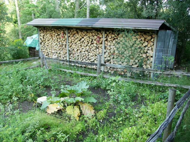

Thanks guy's...
Yes' I throw a tarp over each pile that's ready for use.. the problem with this set up (as has been noted) is snow and ice. I like the idea of a long 10-12 foot deep, 10 foot high open face building..like a horse run-in shed with a vented eave in back. Similar to jimmyj's picture..
I've never built one but I can think of some draw backs of going cheap.. wood rot (the building not the firewood) at ground level is one... the fix would be... pay up $$$$. Concrete pad, or some other ground prep that allows for quick drainage, metal supports, or pressure treated wood.
Another drawback would be looks.. not that I care what a building that no one can see looks like,,, but the wood shed will need to be within an easy walk from the back door.. this means in my side yard. The side yard is visible from the road and is used for outdoor get togethers.. we want that yard looking better than a scrap area. A good looking open faced building would be acceptable.
Anyone have plans for that style building? Say the building in the first picture instead of the second..:D I do like the first shed but I'd need to double the length, and get rid of anything that adds too much cost. Say having to buy a wood mill to make my own siding pieces would be out of the question. :laughing:

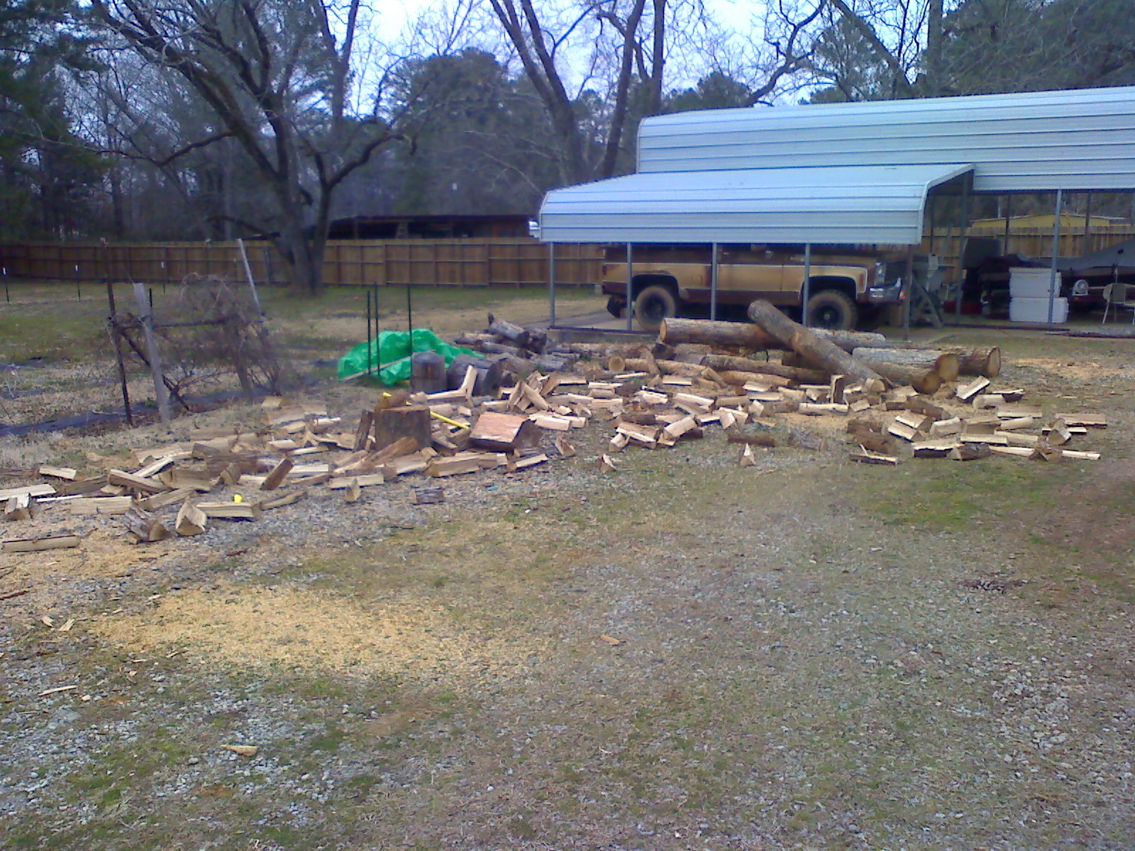

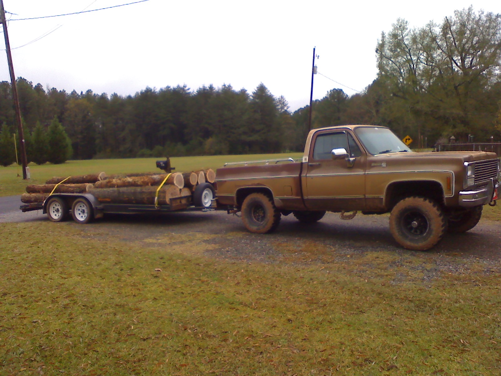

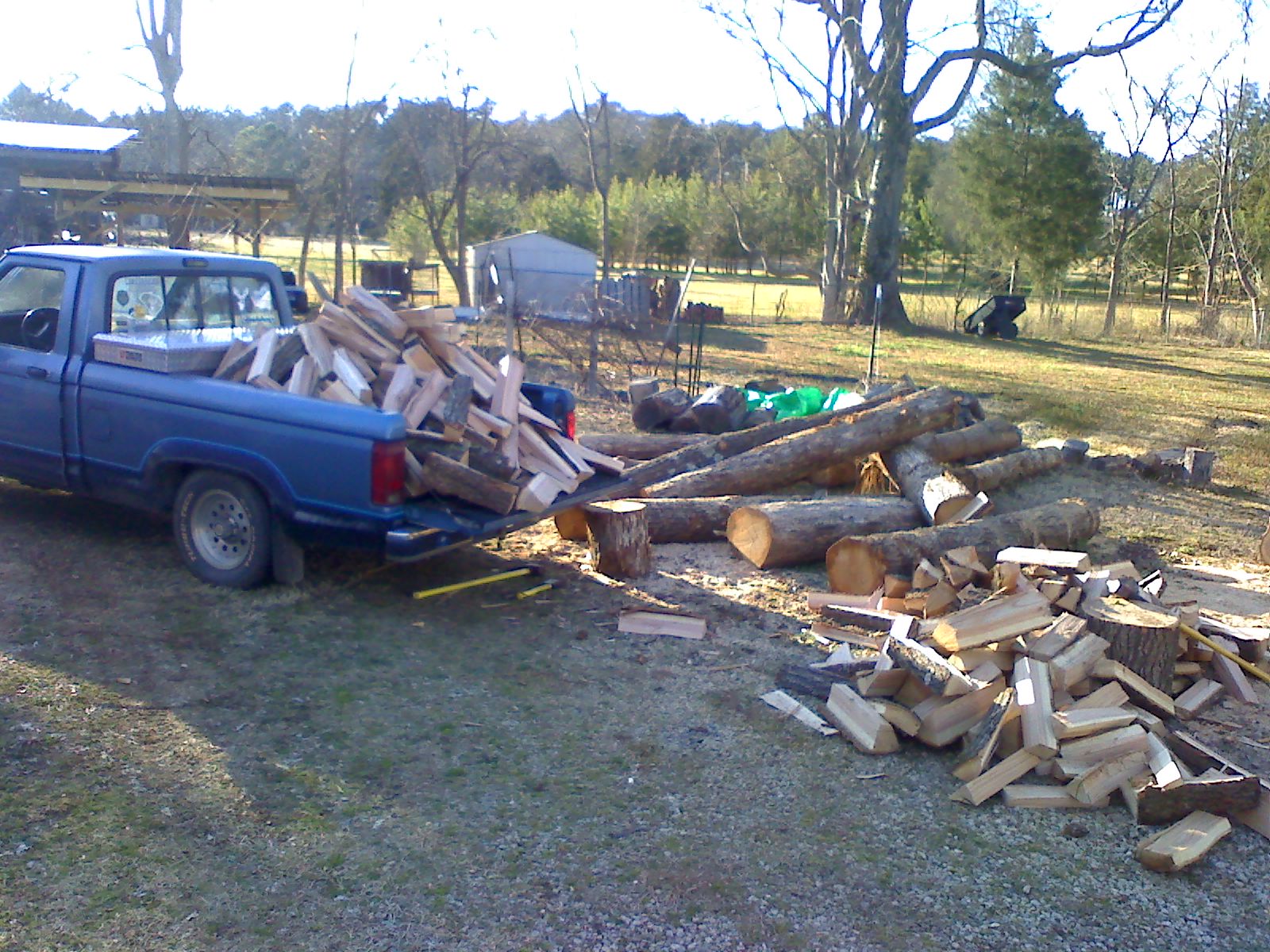

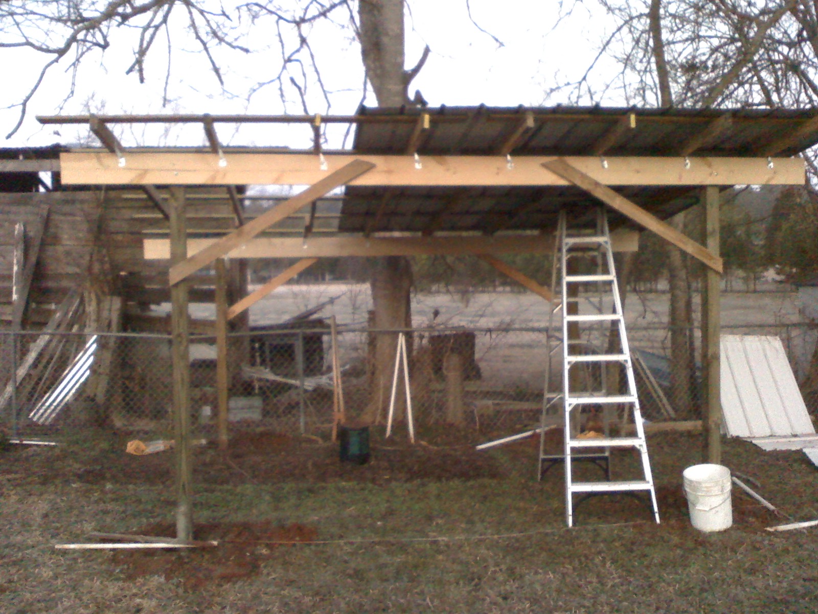

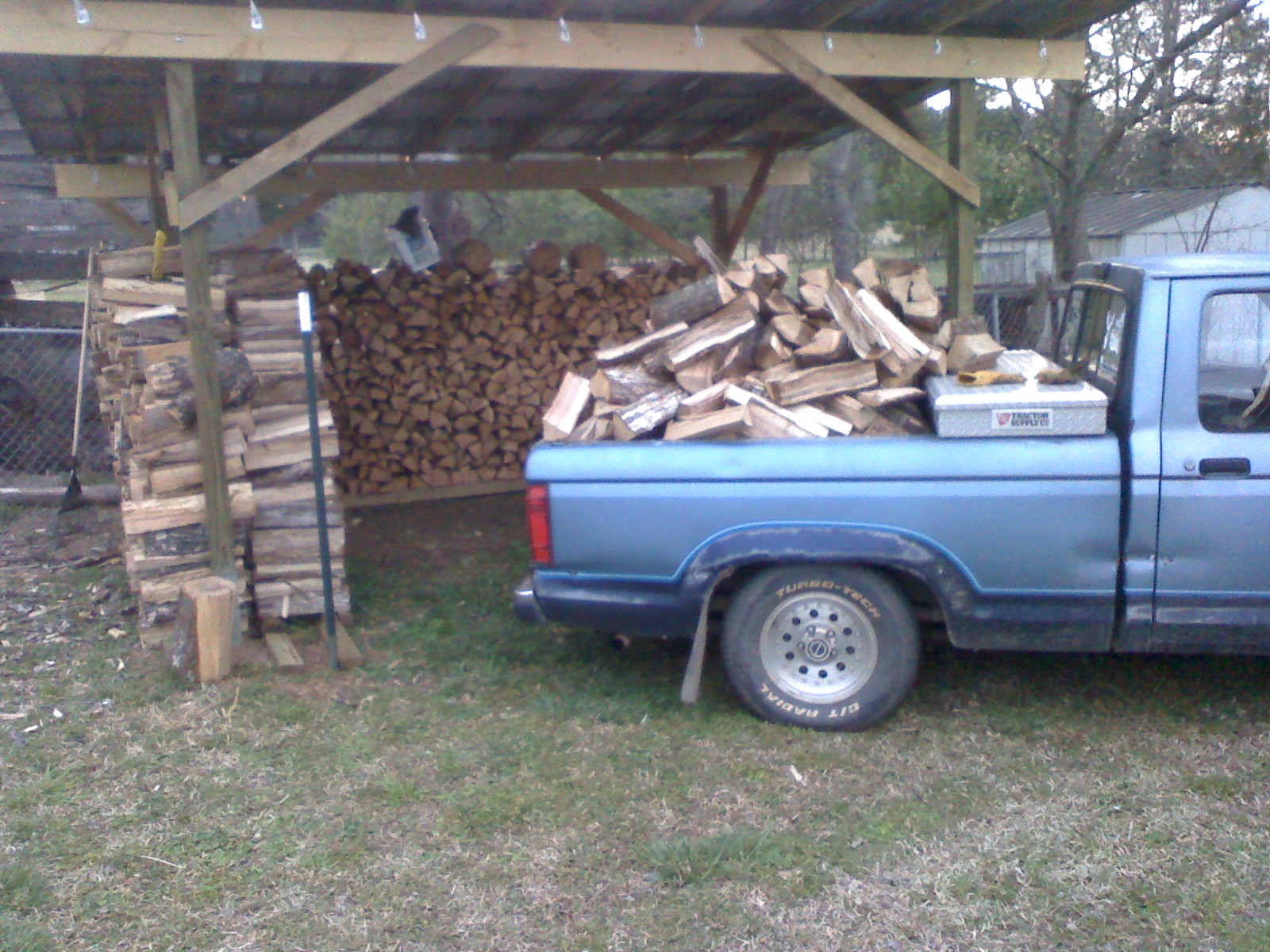

Here are some pics of my wood and my shed that i built at the end of last winter for my wood. I basically dump it off and split it one ranger truck load at the time and let it sit sometimes for a while in the sun then i stack it, but again i dont have this down as this is the first fire season with the shed, before i would just pull a tarp over the pile before a rain if i remembered. I built the shed with treated 4x4s. front were 4x4x10s and the back were 4x4x8. the headers were 2x8x16s. The rafters were 2 pieced togeather pieces, not the correct way but i was saving money and can always reinforce if needed but we had a 5 inch wet snow and its fine as well as me on top . Most of them are treated but not all and the stickers that the tin is screwed to is treated wood purchased for the shed. The tin was scavanged from helping a coworker tear down his shed. The 4 posts 2 headers and the stickers and cement cost me $200ish dollars but i really cant remember, that is all i bought for this shed too. It is 16ft x 12ft under the tin. Yea in a driving rain most will have wet ends but not all of it. i built it for wood and for other stuff when needed as you can see.
Sorry for the quality but they are cell pics.

@clemsonfor - you may want to reinforce your shed. The last photo shows a giant thumb hovering over the shed. It it were to drop, the shed may be crushed... :)
