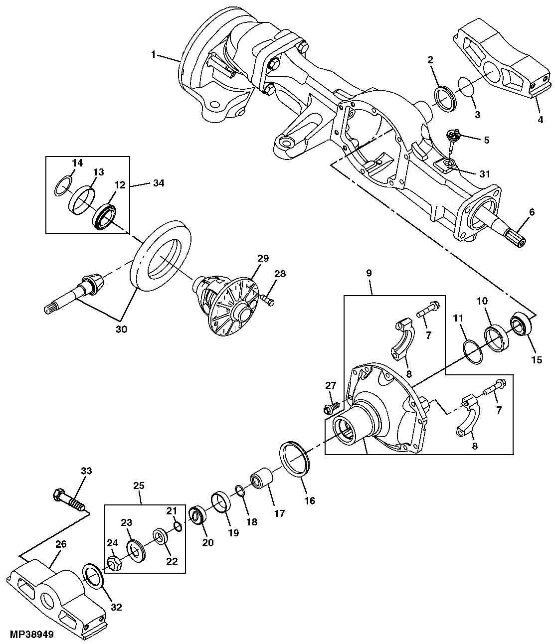

So on this diagram, the seal is letter I . . . is that correct? as it appears to correspond with #33 on the previously posted diagram.
I look at it as being letter "H" in the diagram (and is a wear sleeve) and that corresponds to "10" in jdparts (part #M138286).
But either way, will need to come apart to replace. Puzzles me how that wear sleeve can get out of the housing. Even more so, if it really is the seal how it gets out.

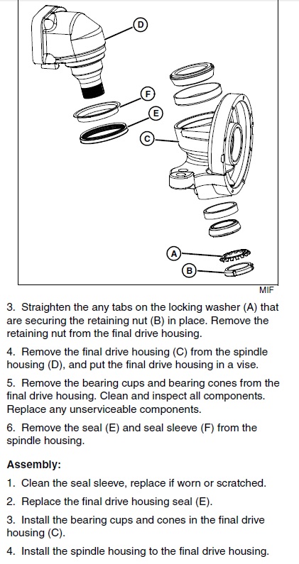

   / Where did this seal come from? #23
Here is a pic from the tech manual referring to the seal and the sleeve.
   / Where did this seal come from? #24
I haven't looked at mine yet so I'm going by memory. That seal just sits there. It's not encased in anything and only the tension of the rubber holds it in place. If the seal tares like it did in this case then all you have to do is turn the steering wheel and it will work it's way out.

I have no idea where it goes but it was mentioned to first try to glue it back on and see what happens. Over the years I have tried weatherstrip adhesive, etc and recently had great luck with a tacky super glue. I never would have guessed it would work but I glued some rubber seals to plastic seed cups on a Brillion seeder and had 100% success. The idea was suggested by Brillion tech people and I saved myself a few hundred $$.
   / Where did this seal come from? #27
I believe this seal is in the pivot "trunnion" area of the front axle. This is where the axle pivots side to side over uneven ground. Item #16 in the diagram is part # M163888 and it is 2.640" inside diameter and 3.120" outside diameter. It helps keep grease in the pivot point and keeps dirt/water out. It is not a critical seal, but Be sure to grease it often until the seal can be replaced to help keep contaminants out. The entire axle assembly needs to be removed to replace it. This seal is in the rear pivot joint. There is a similar, smaller diameter one in the front pivot, #2 in diagram.
#28
Hello again,
I just thought I'd post an update to my original thread question . . . Where Did This Seal Come From? My John Deere Technician came to my home and working in my garage, he replaced two seals. It meant dropping the front axle. The diagram shows the two seals that were installed, highlighted in yellow with a red circle around the seal #. Job took about two hours. Two different sized seals were involved: #2 - M136887, the smaller seal, and #16 - M136888, the larger seal

   / Where did this seal come from? #29
That's good to know about.
I might never have suspected the seal you found to have come from there.
Did you any oil from your front axle after the seal came out. It would be helpful to know.
Congrats on it being repaired.
#30
Hi LoudonNH,
Nope dry seals . . . no oil leaked out. The tech said they were intended to keep dirt and moisture out and not oil in . . . so he said.
