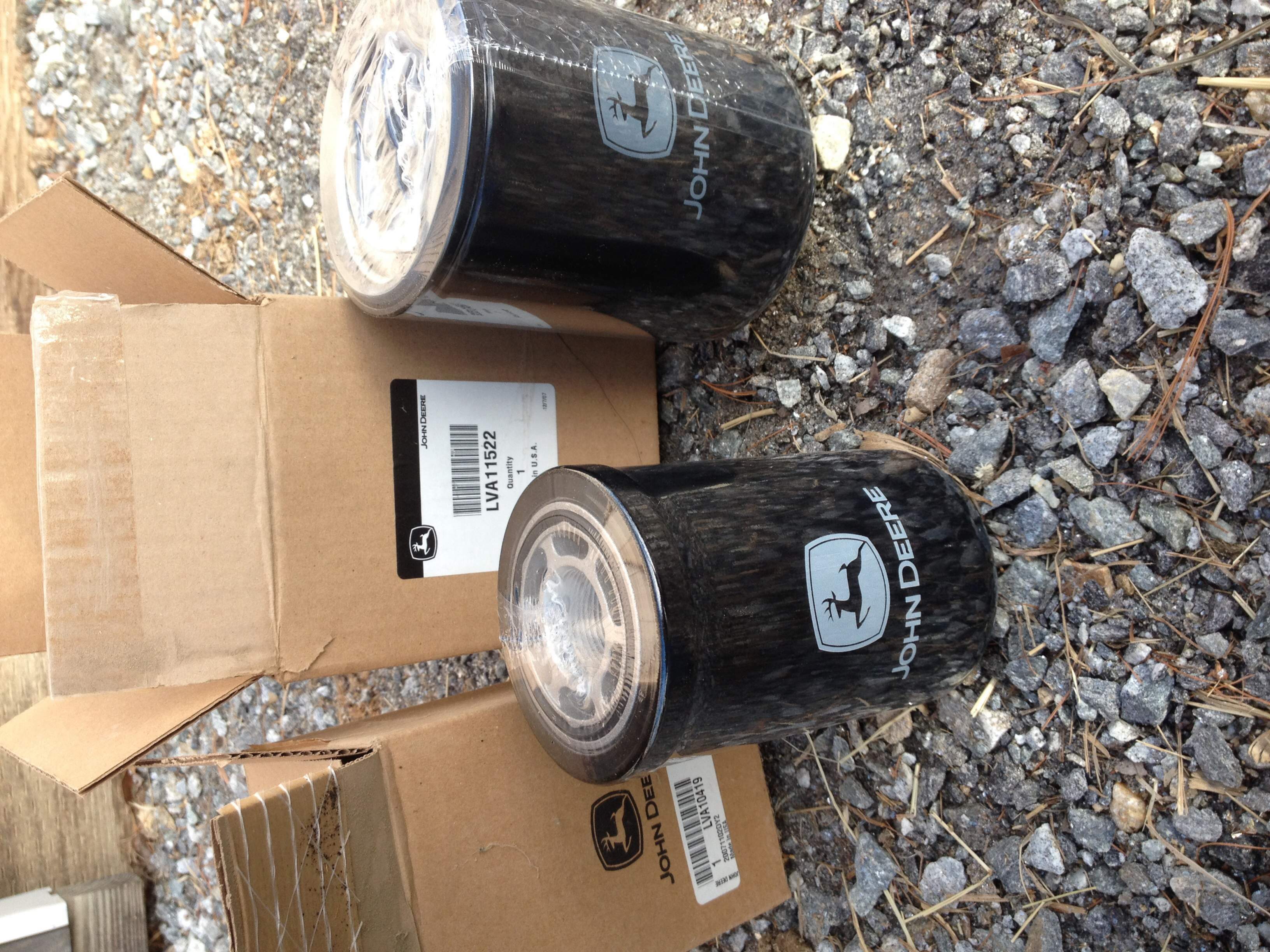

Could it be the seal from one of your hydraulic filters?
