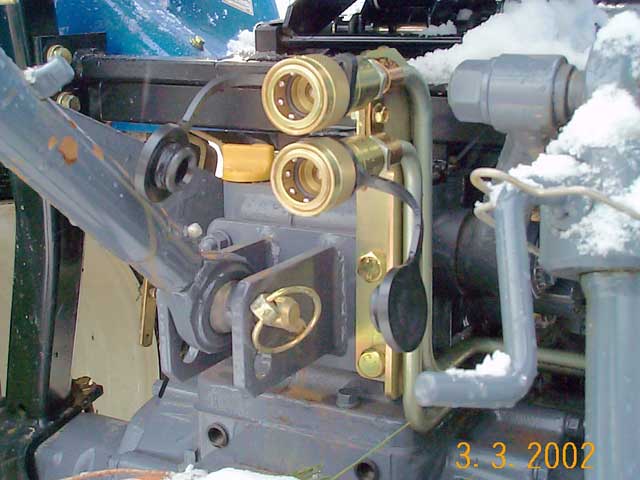

I ended up lifting right in the center under the draw bar area. I used a 3 1/2 ton floor jack with a piece of carpet between it and the bottom of the tractor. I had the loader all the way down and I placed some wood in front of the front tires. I jacked up the rear end until the tires were about two inches off the ground. Then a placed both my 3 1/2 ton jack stands under the axle, one on each side with some carpet between them and the axle. I then lowered the jack until the tractor was resting firmly on the jack stands. After I had installed the rear remotes and had everything back together I found out that the new lever for the rear remote is hitting the lever for the 3 point. I don't know if the new lever is bent wrong or if the lever for the 3 point is bent wrong. I will have to live with it for now until I can speak with my dealer about it.
Here is a pic of the rear remotes (If only I had something to hook to them)

Very nice work!
   / Where can I safely lift from? #23
Center under the draw bar. That's the same lift point I use. On my tractor its really the only good spot you can lift from in the back. Smart and safe to use jackstands too. I once knew a guy who got killed when the vehicle he was working under fell off a jack. No blocking under the axle. Sad thing to happen.
New Holland sure has it together with their remote hydraulics kit. Priced right and looks good too!

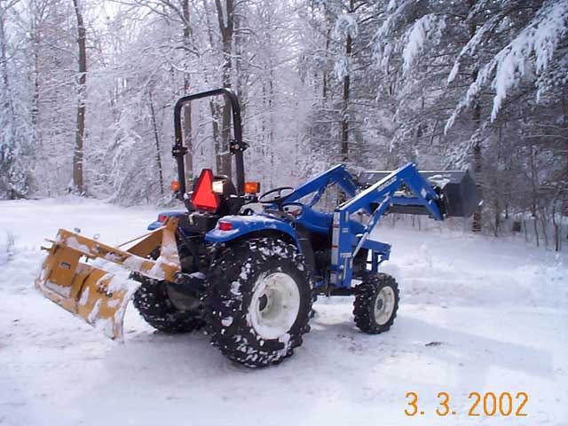

BTW, in those pictures you seem to still have a lot of snow...
Actually that is all new snow since Friday night. Got to play for about 3 hours this morning.
