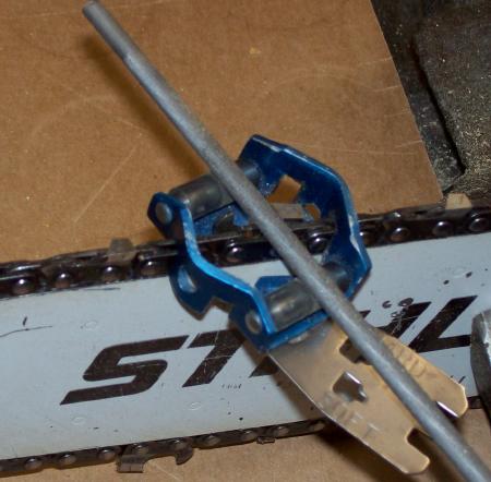

I agree 100% with that. I've met dozens of people who think they are great at freehand sharpening (sharpening with just a bare file and no sort of guide). I've met two in my life who actually are good at it. However, it's very easy to learn to hand file with the appropriate file guide. Two that I've used with good results:
Husqvarna Swedish Roller Guide: Easy to use once you figure out how to lace it correctly on the chain, but does not fit some types of consumer safety chains (the extra bumper link gets in the way, preventing proper positioning of the guide). Get the one which has the attached depth gauge tool - it's very convenient for setting the depth gauges with a flat file.

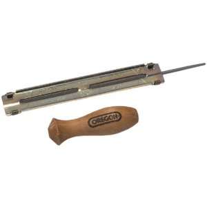

Oregon Filing Guide: also easy to use, once you get the knack. As long as you get the right size for your chain, it will work on any style steel chain.

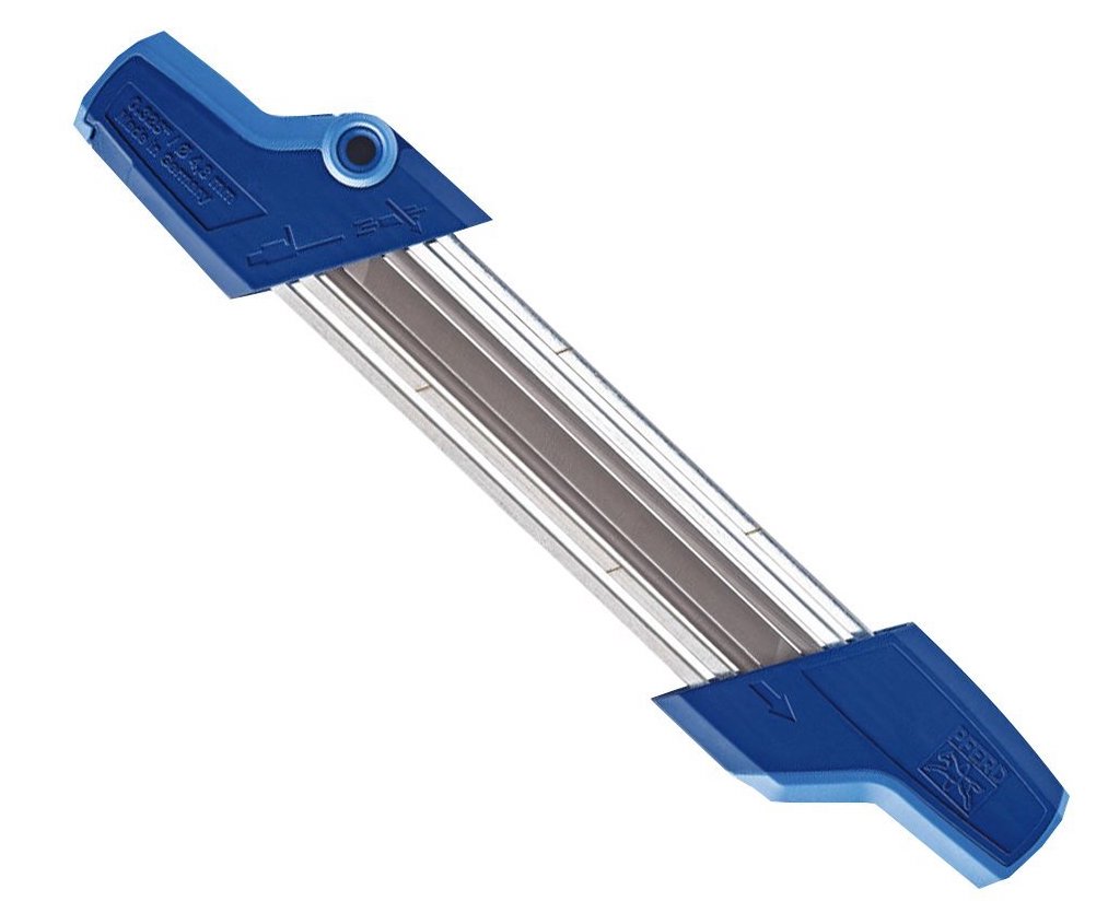

And one that my friend swears by: The Pferd Chain Sharp CS-X (also sold as the Stihl 2 in 1 Easy File). I've only used it once, but it got the job done. It sharpens the tooth and sets the depth gauge height at the same time.
That's probably good, because "ribbon curls" are not what a chain is supposed to make. If you are cross-cutting, which is how a chainsaw is generally used, a chain should make discrete chips (not sawdust). The exception to this is if you are making ripping cuts: cuts along and parallel to the grain. This is sometimes called "noodling" for the long curlicue strips of wood it makes. However, it does not take a particualerly well sharpened chain to generate the noodles.
