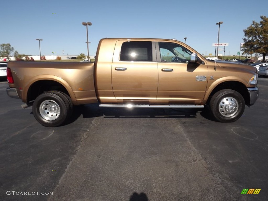

I will: pretty exciting day tomorrow. I am getting Katahdin sheep, and another pick up. A 2012 Dodge Ram Laramie Longhorn. The F150 will be my work horse; and the Dodge my "go to church"..... Life is good. longhorn.jpgst patric day.jpg
