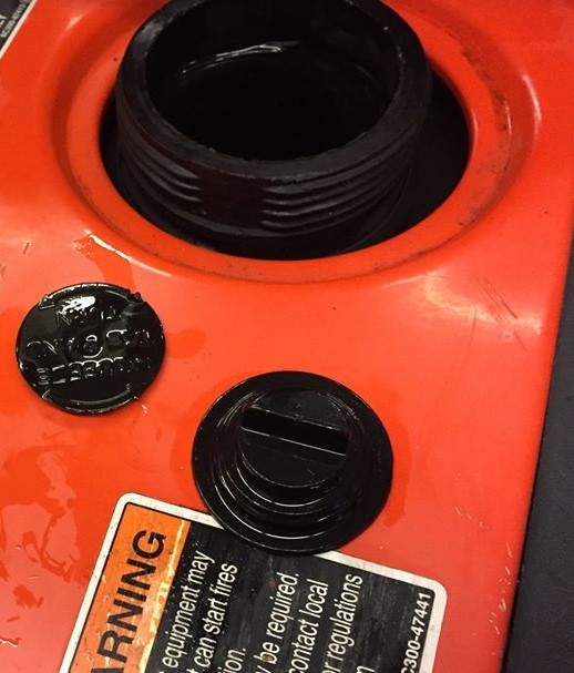

"We have met the enemy and he is us." These have probably been in the tank since the very first time I filled the tractor from a diesel can. DOH! but a known is always better than an unknown. And this has been a useful study on farm "lemon" laws. If anyone lives in Minnesota - I can provide the statutes. Thanks for the comments, encouragement. View attachment 461080
How did you finally find those pieces in the tank?
WOW- after all the trouble shooting,
have to say i am also surprised the dealer didn't rig up a temporary fuel supply to eliminate the tank as a problem early on...
Some of the diesel fuel tanks on my equipment and others also, have factory fine mesh screens in the filler necks, looks like that would have eliminated what sounds like a real nightmare.
hindsight is 20-20 though.
Very glad the tractor is fixed- and hopefully you can (Now) really enjoy your new tractor.:thumbsup:

I agree. If fuel flow was a diagnosed issue, the first thing he should have looked at was the tank. In fact, that's the first place I would have looked before the dealer even got involved.
