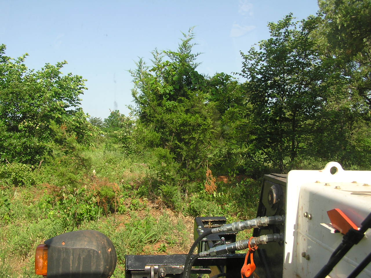

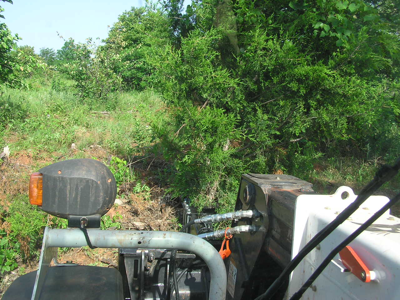

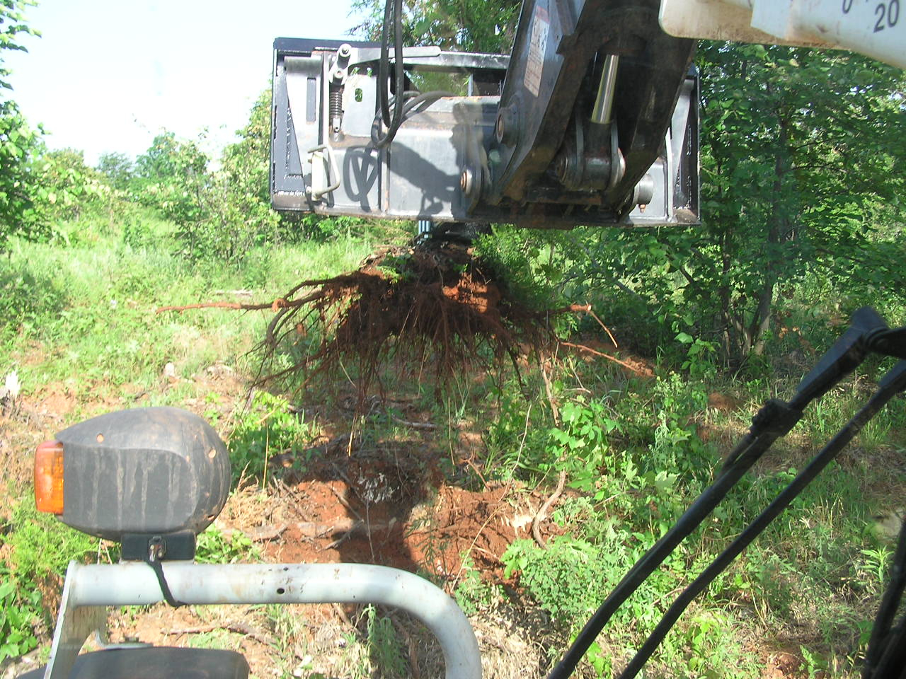

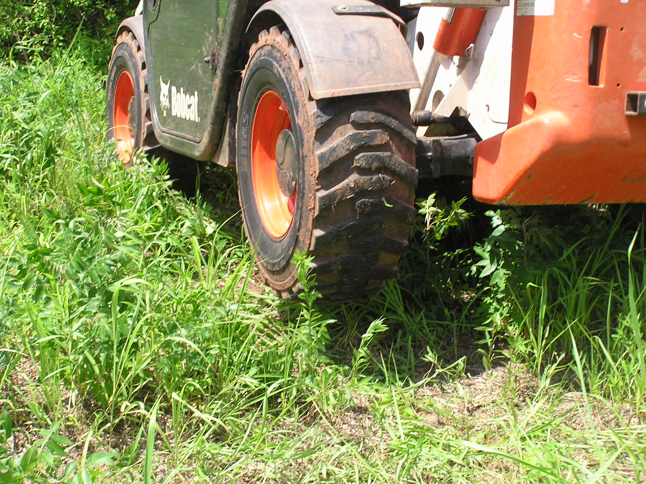

Do you have to pre-dig around the tree? Or do you just drive up and rip it out? Awsome attachment !

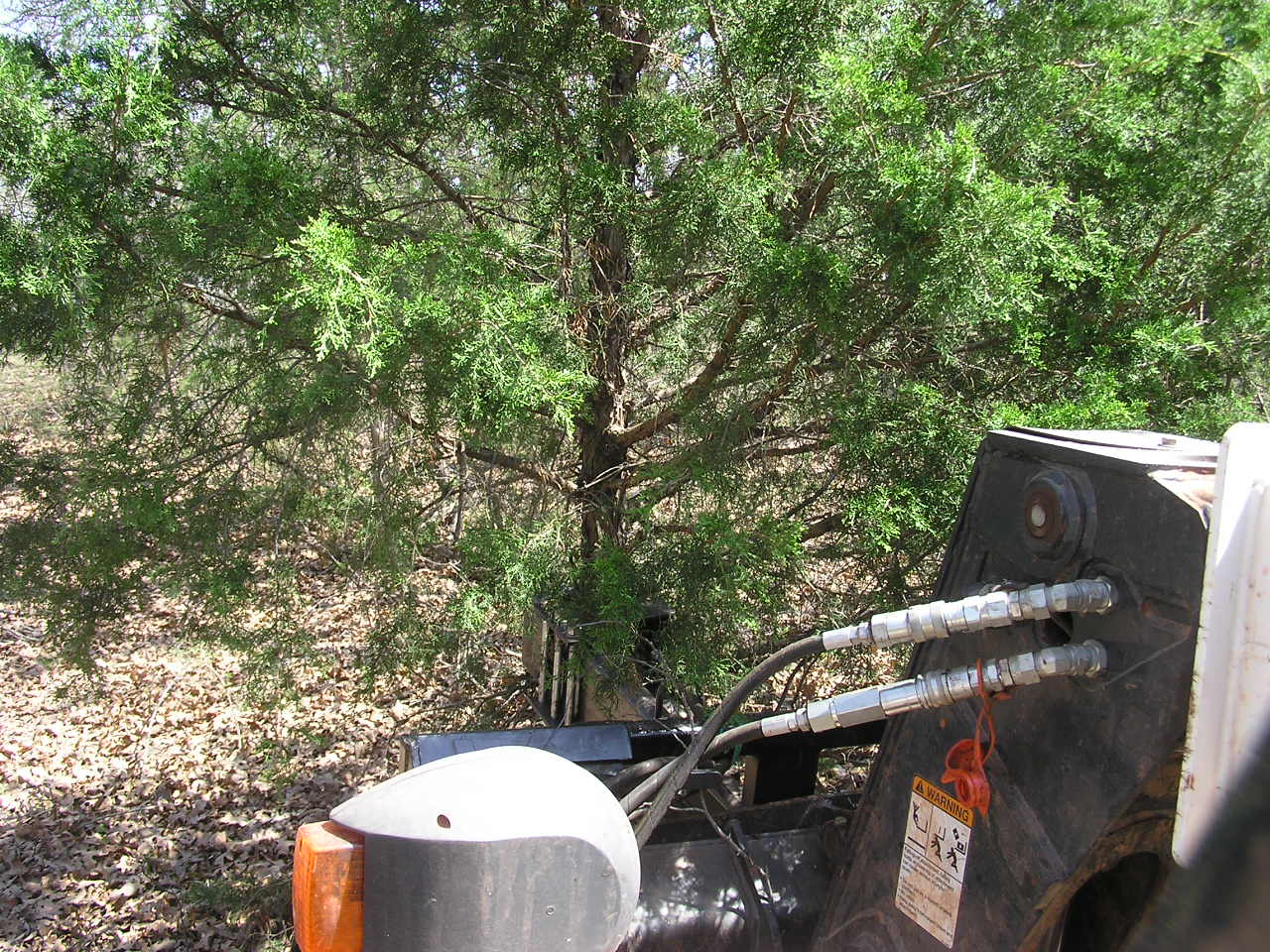

No digging, Here is the tree shown in post #5.
View from the seat, clamped on to the trunk.

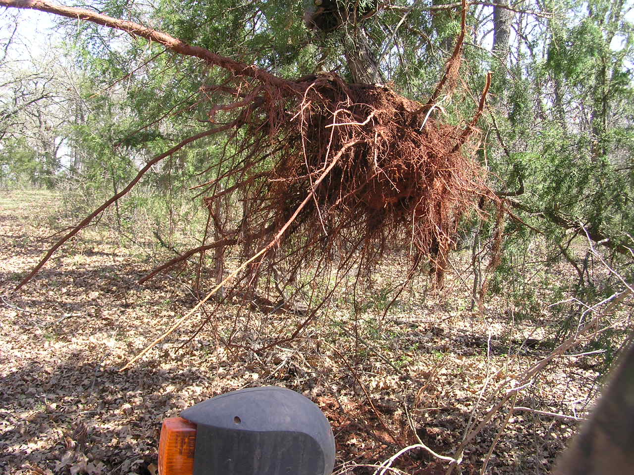

Pulled, these cedars don't have a tap root. :thumbsup:
Shook the dirt off.

No, don't have many small stumps, the jaws open to 8".
It would have to stick up about 4" to get a good grip on it. If it has a large tap root, it probably couldn't pull it.

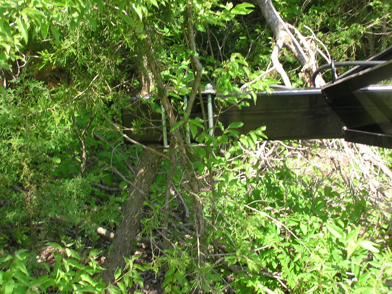

With a tall tree, you can lean it over to break the surface roots. Here is one that it struggled with.
Lifted the rear up off of the ground.

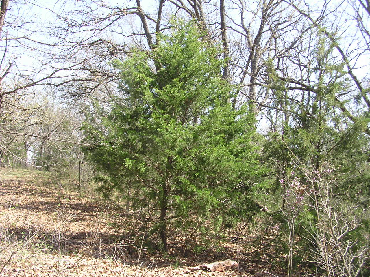

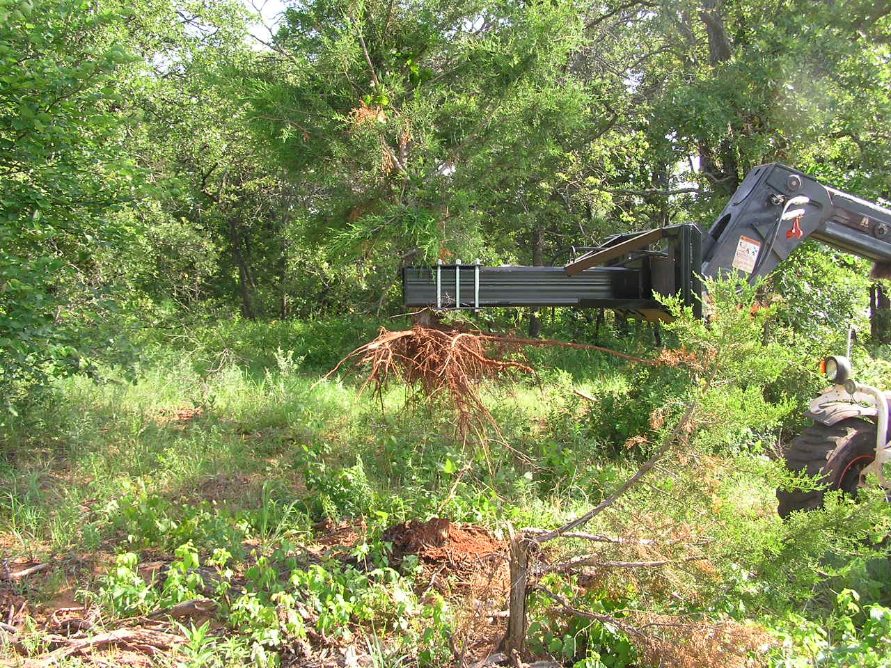

Bumping this old thread since I am still using the tree puller.

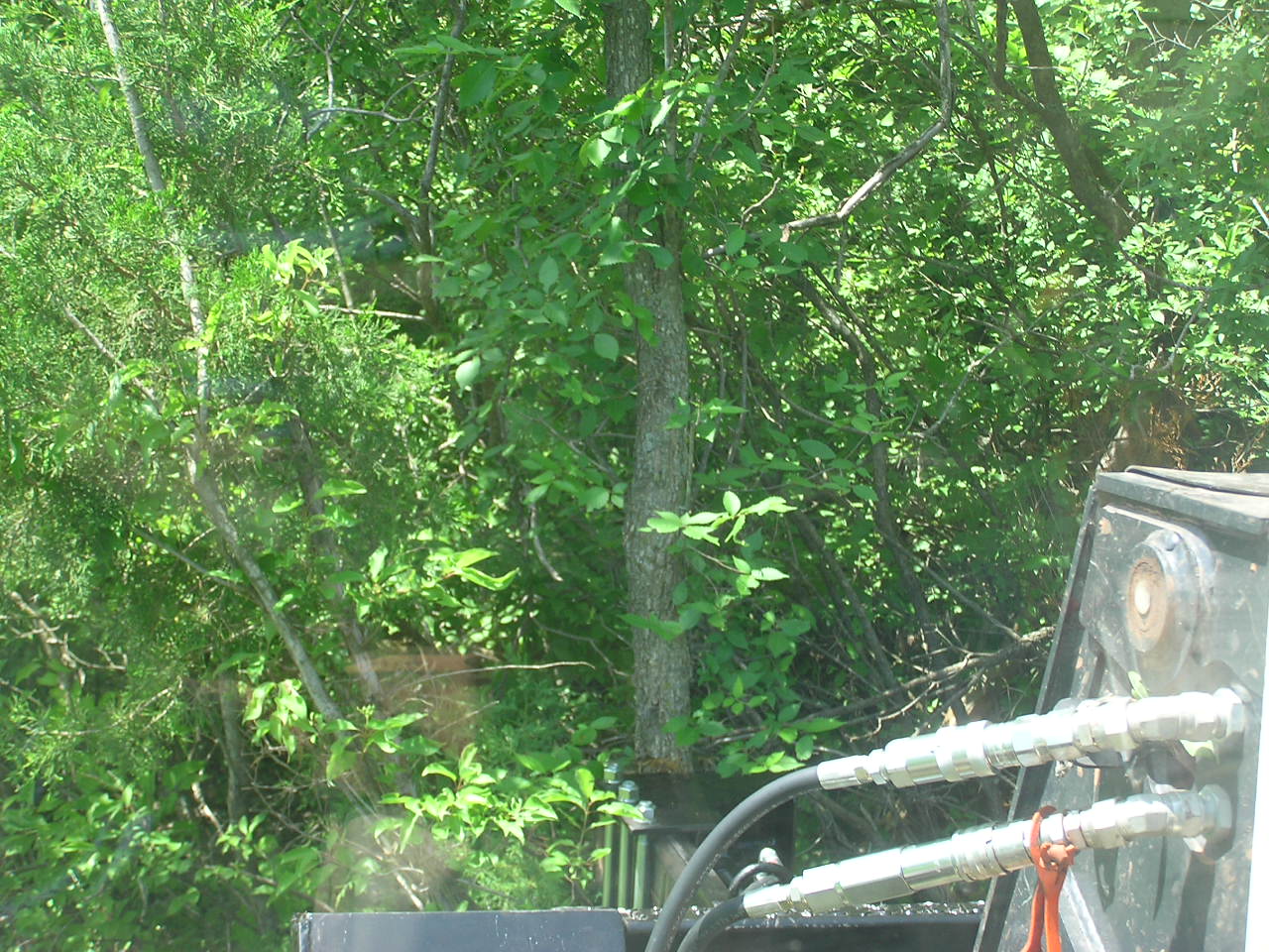

A little cedar tree ahead:
Clamped on the trunk:
Pulled it:
Shook the dirt off of the roots:
