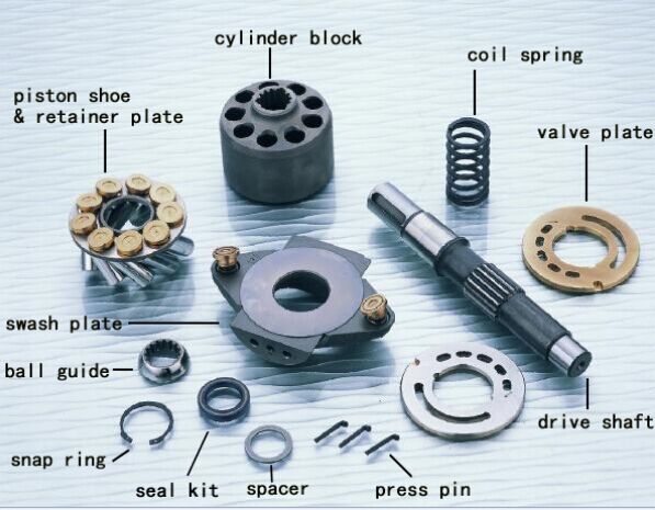

Just wondering what the potential repairs will be on a hydro tractor as it ages?
I dont really think this is an apples to apples comparison.
A friction clutch is a wear item by design.
Clutch maintenance usually only means keeping it adjusted correctly.
No matter what, the clutch will wear from use.
An HST is a hydraulic driven motor that drives the metal gears in the transmission.
It is not a wear item. Meaning it is not designed to wear from normal use.
Maintenance is changing the fluid and filters.
Failures are not common although they do happen.
I would think that you run the same risk with the hydraulic system as you do with the prime mover (engine). A failure in either with a high hour machine will mean the machine is scrap. Unless the owner is mechanically inclined.
   / When a gear tractor reaches 1000's of hours it needs a clutch; what does a HST need? #23
You do have wear parts in a HST that are designed to wear. You have swash plates, pistons, valve plates, thrust washers, cylinder blocks... The list goes on and on. So yes, after X hours, it'll either get a rebuild kit if it's still available or just dump the whole thing out.
While a clutch will wear faster or slower according to use and how it's used, the HST will wear faster/slower according to the maintenance and the quality of oil and filters.

My understanding with HST was that if you keep the fluids clean, HST will last longer but not forever; the hydraulic pumps and motors will still need rebuilt. I'd love to know what a running average would be for different machines to reach that point is.
