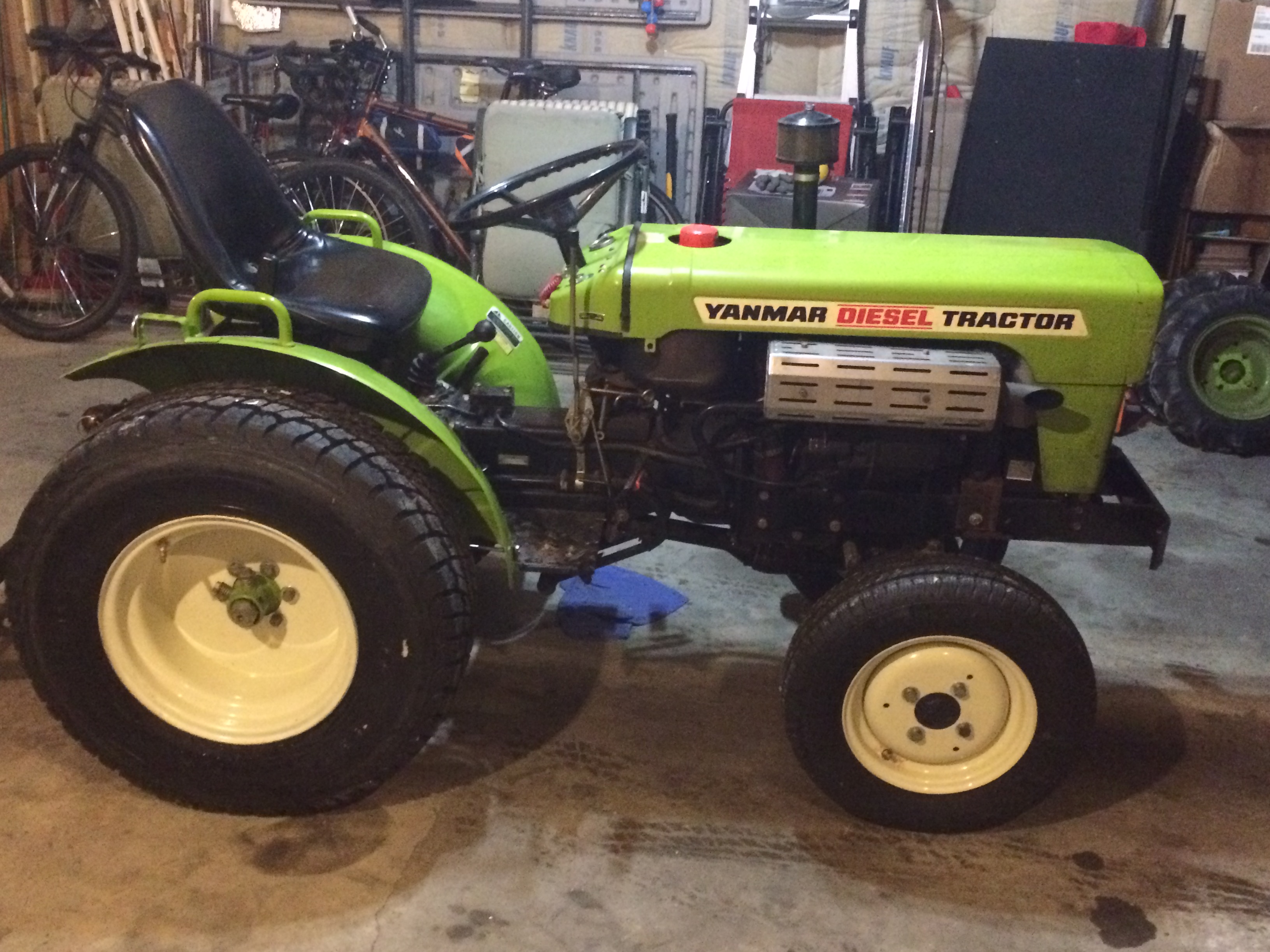

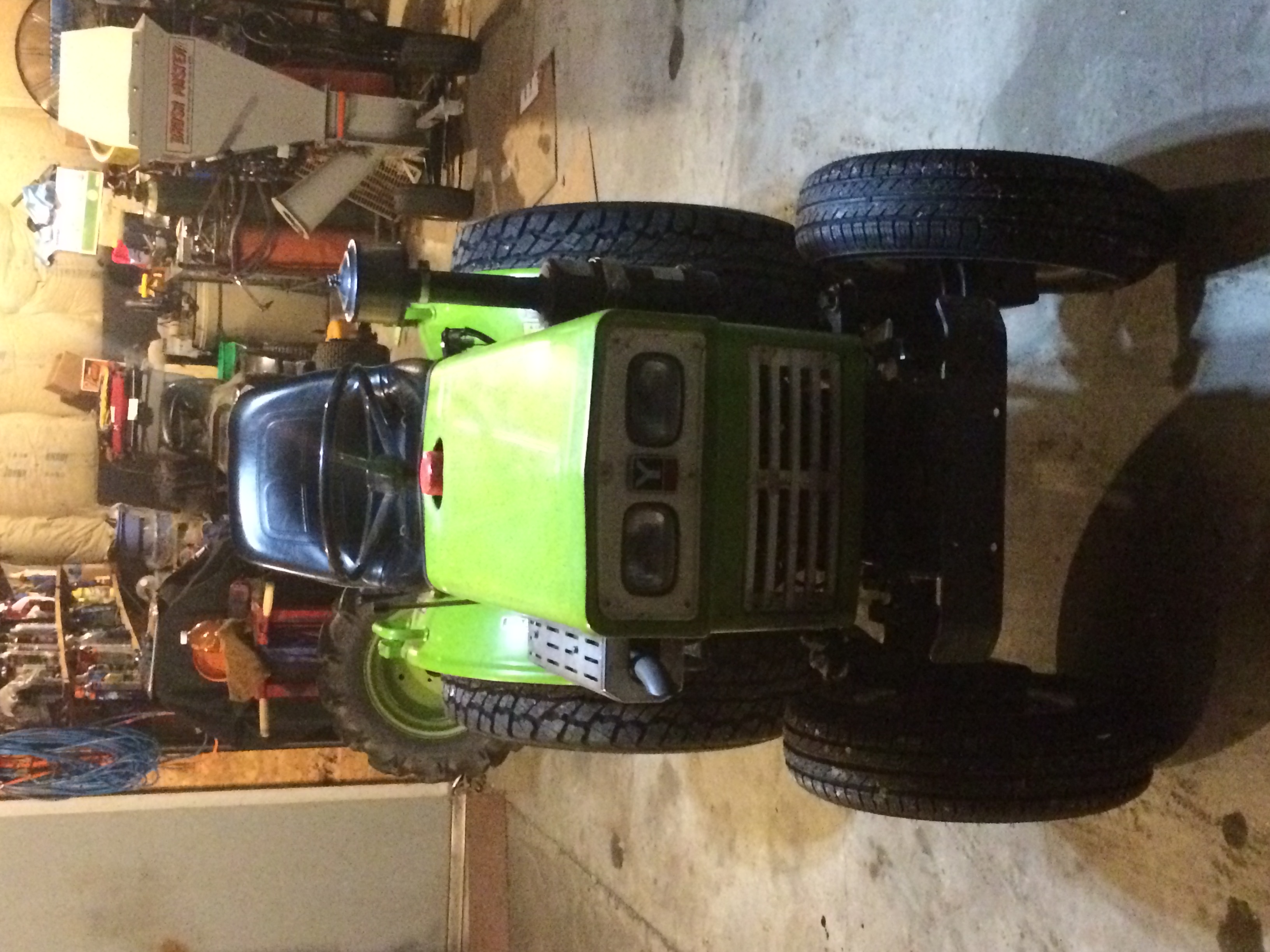

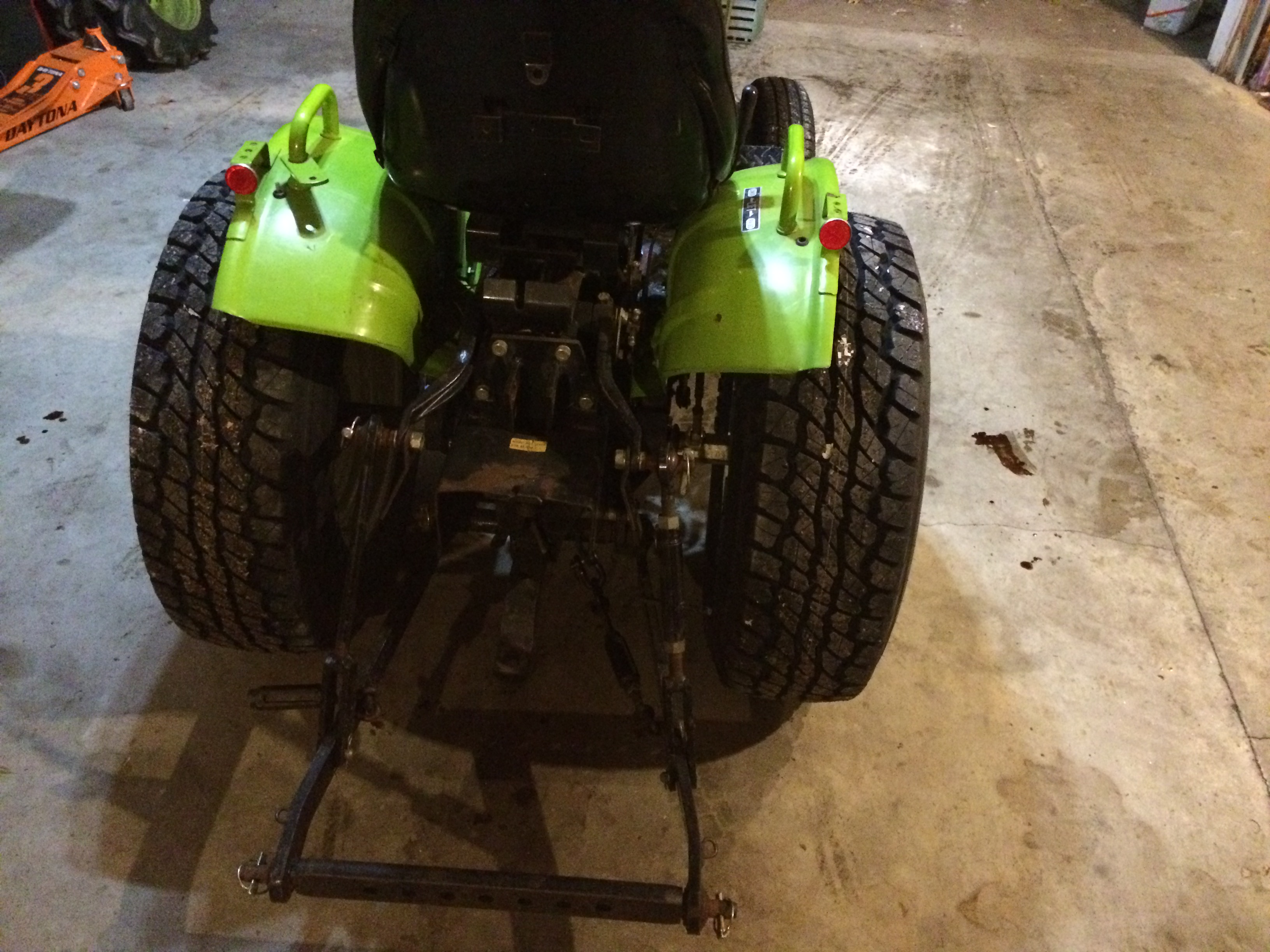

Well I finally pulled the trigger and got different wheels and tires, that way I can keep my R1s and use them when I am in the garden or other food plots. Here are the pics of what I have. Hoye wheels with LT275/75r16 on the rear and 155/80r12 on the front. I also filled all 4 of them with Rimgaurd for extra weight and better pavement traction for this winter when I am using a 3PH snowblower, which I still need to find... The tires are pretty stiff since the back ones are 10 ply, I may take a little air out to give it some more cushion, but since they are LT 10 ply it might not make much difference. I did run it last night in 4wd. I didn't notice anything different with it than how it was before. There is about 2 inch difference in height on the rear from the original R1 tires, and the fronts look to be about the same.
/ Wheels for YM155D #23
View attachment 578902View attachment 578903View attachment 578904
Looks very nice. I'm sure it will be more stable, too - and in my mind that is the most important advantage of all.
The size difference in the tires won't affect the tractor unless you use it in 4WD. There's no point in inventing a problem, but do pay attention in 4wd - at least in the beginning.
When changing to an front/rear size ratio that may not match the tractor's internal gearing, it just makes sense to pay attention and even be conservative by not using 4wd unless it is on a surface that will allow a tire to slip.
Slipping a tire helps because the slipping is actually taking any torsional stress off the drivetrain by allowing the shaft to "unwind".
You will know if the tire size is building up too much differential stress in 4WD because it will be difficult to shift out of 4wd after driving it that way. All 4wd are a little sticky that way, but if yours becomes excessively difficult to shift, consider only using 4wd in slippery surfaces like snow - never on something high traction like asphalt pavement or sticky dirt. In fact, that's a pretty good way to treat any tractor 4wd.
Good luck, I sure like those YM155/165 tractors.

Thanks rScotty. Before I decided to put these tires on I compared Hoye's turf tires rolling circumference and revs per mile with the tires that I put on here. There was a 4 rev per mile difference, so I figured it would be ok to use this set up. I do appreciate all your input on this matter though because I don't want to miss something and mess up the tractor.
I too like this YM155, I am so glad I got it.

Thanks Clem, I think it looks pretty cool too. I need to let a little air out of the tires, not much give compared to the R1s or actual turf tires. But this will surely be more stable and provided good traction on the pavement this winter.

I actually took the rears down to 30 PSI and the fronts to 20 PSI last night. It does ride better, but I think I am going to take the rears down more yet, probably to 15 PSI, it should ride smoother and have a little wider footprint too.

Filled tires do make a huge difference. I can't remember how much weight it added to my 2110d turf tires, but it did add 110 pounds per rear tire on my 155d. I drove it today & at 15psi it was very nice ride. So this winter should be better when plowing or snow blowing with it.
