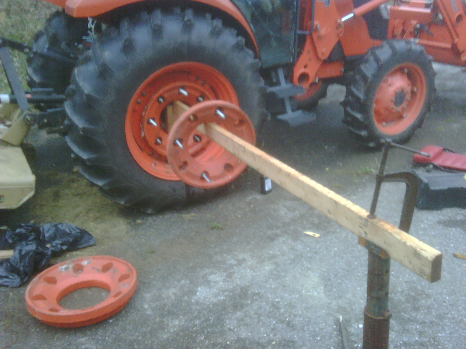

IMG00034-20091126-1313.jpgAdding wheel weights and cast iron wheels and loaded tires will help but still have to use 4 wd on slopes and or lowering the bucket to slow down
