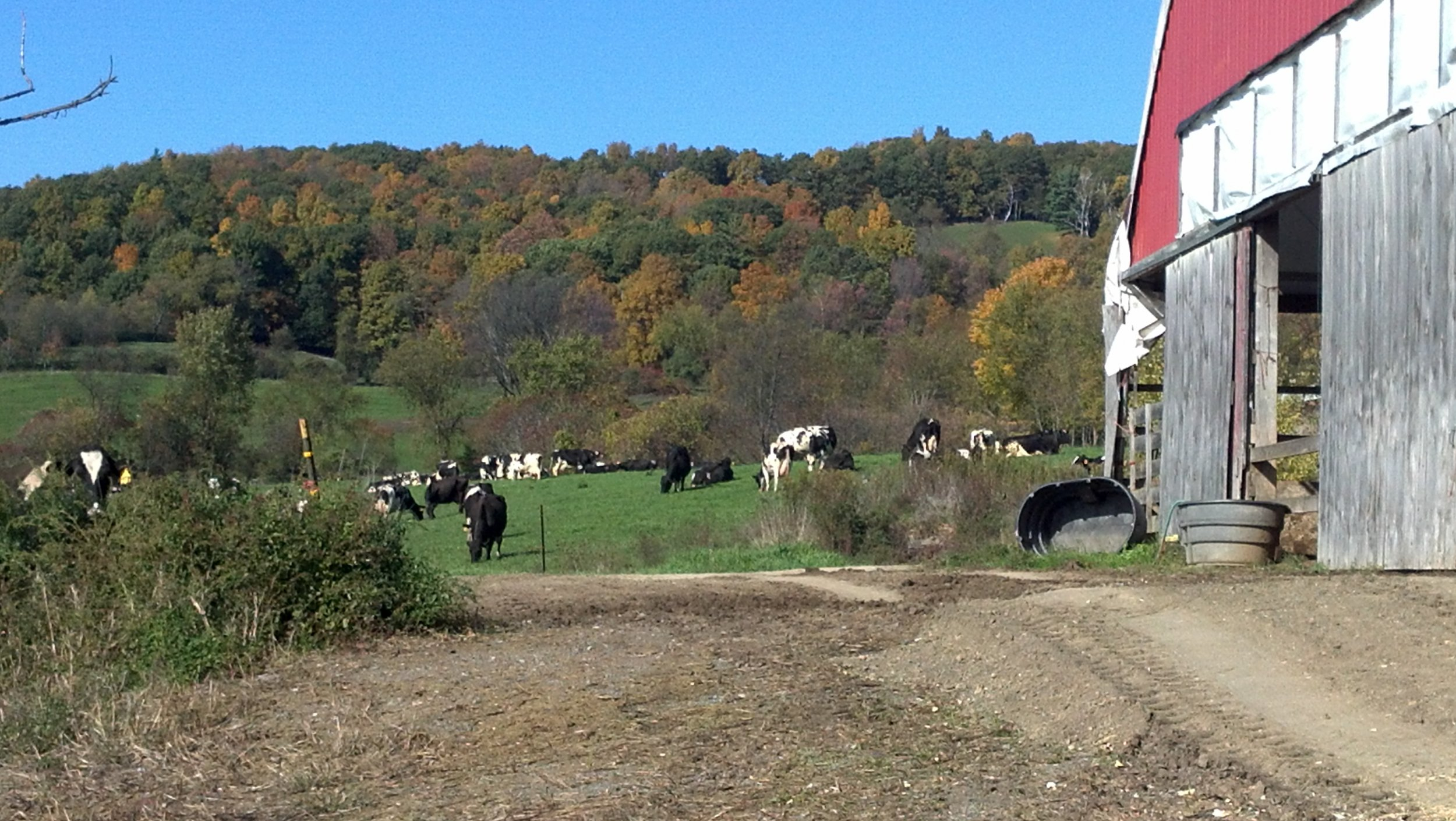

What's real farming????, I must not know what I do often????

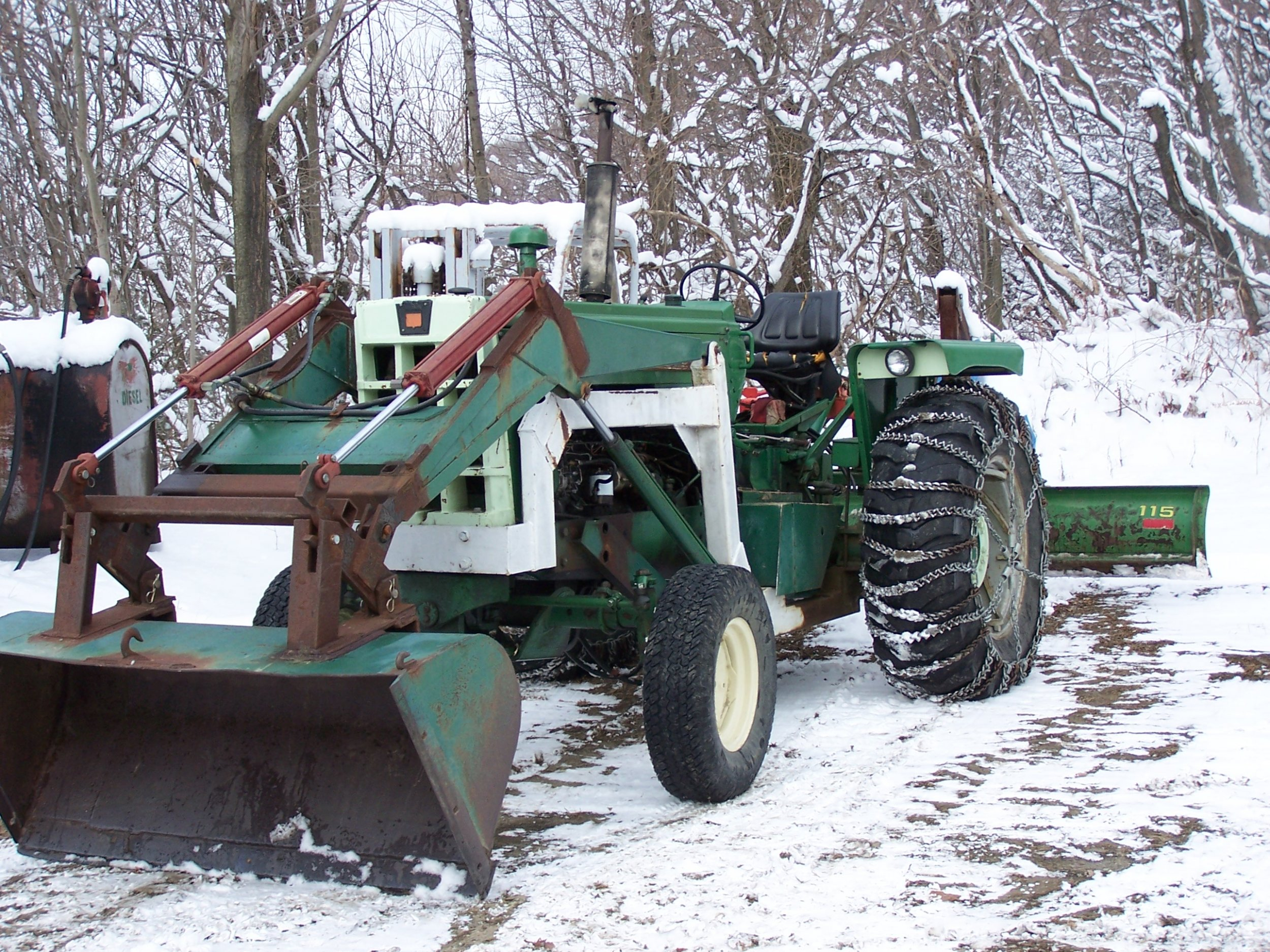

Think that tractor stops without using the brakes?????
Care to work those fields without brakes.
As far as any REAL FARMING I think I can cover that.
