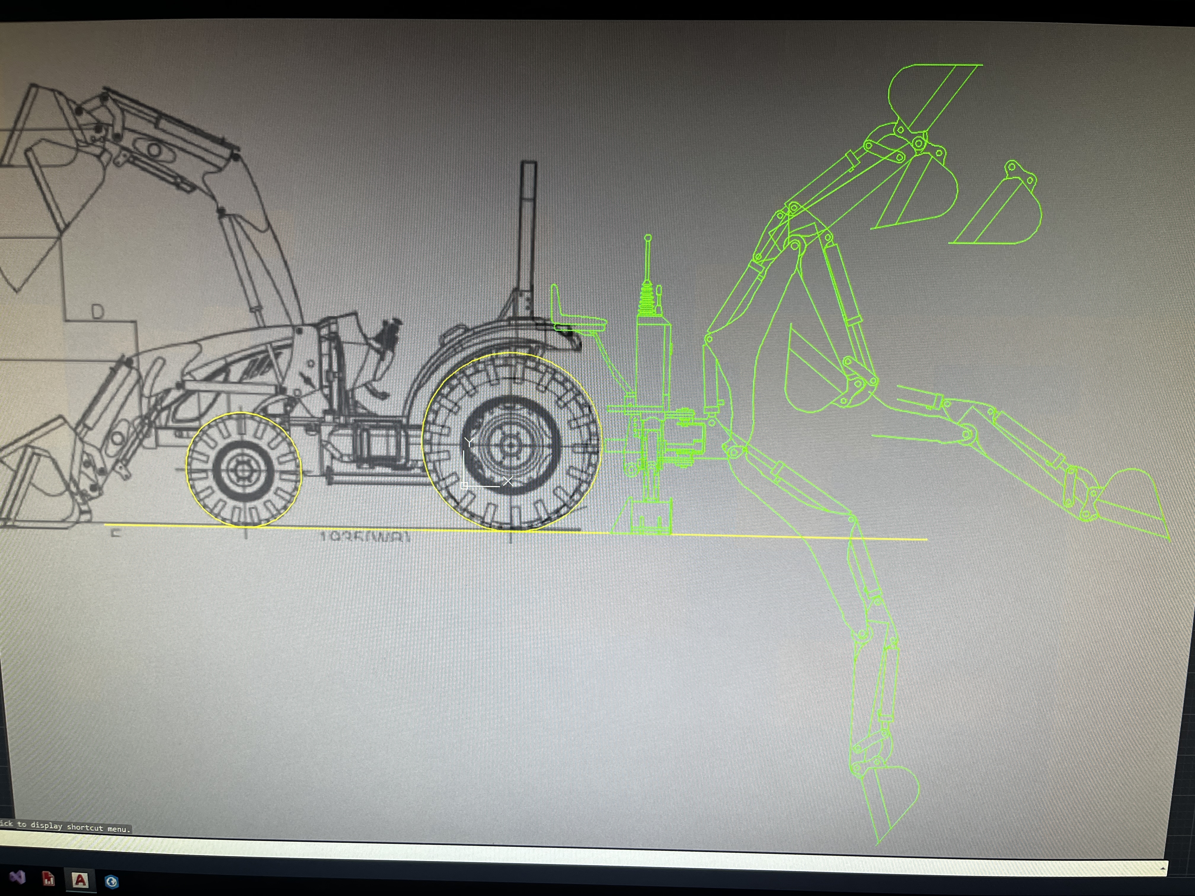

Still more work to do, but this scale drawing of my TYM T574H TLB is coming along nicely! CAD guys love drawing puzzles like this.
