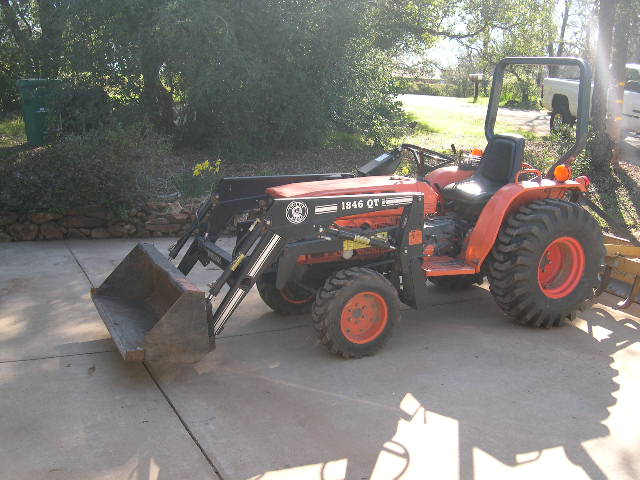

I got the same size as used on the B2150 and B2710. Those, and the B8200 specced out the same size turf and Ag tires(R4 was not an option in '85). Kubota dealer agreed they would work.
The rear turfs on mine had lots of tread, but the sidewalls were failing. Although I kept it in a shed, it had spent year before out in the weather.
The rear turf tire rim is too wide for the R4. I guess it could work, but the sidewall would be odd.
I bought the rear R4 with correct size rim from a nearby Kubota dealer. I reused the front rims with skidsteer tires of the correct size that I got from the local tire shop.
R4's will fit the rims used with the wider Ag tire, I believe the correct size is 12.4-16. The front rims used with Ag tires, are way to narrow for R4's.
