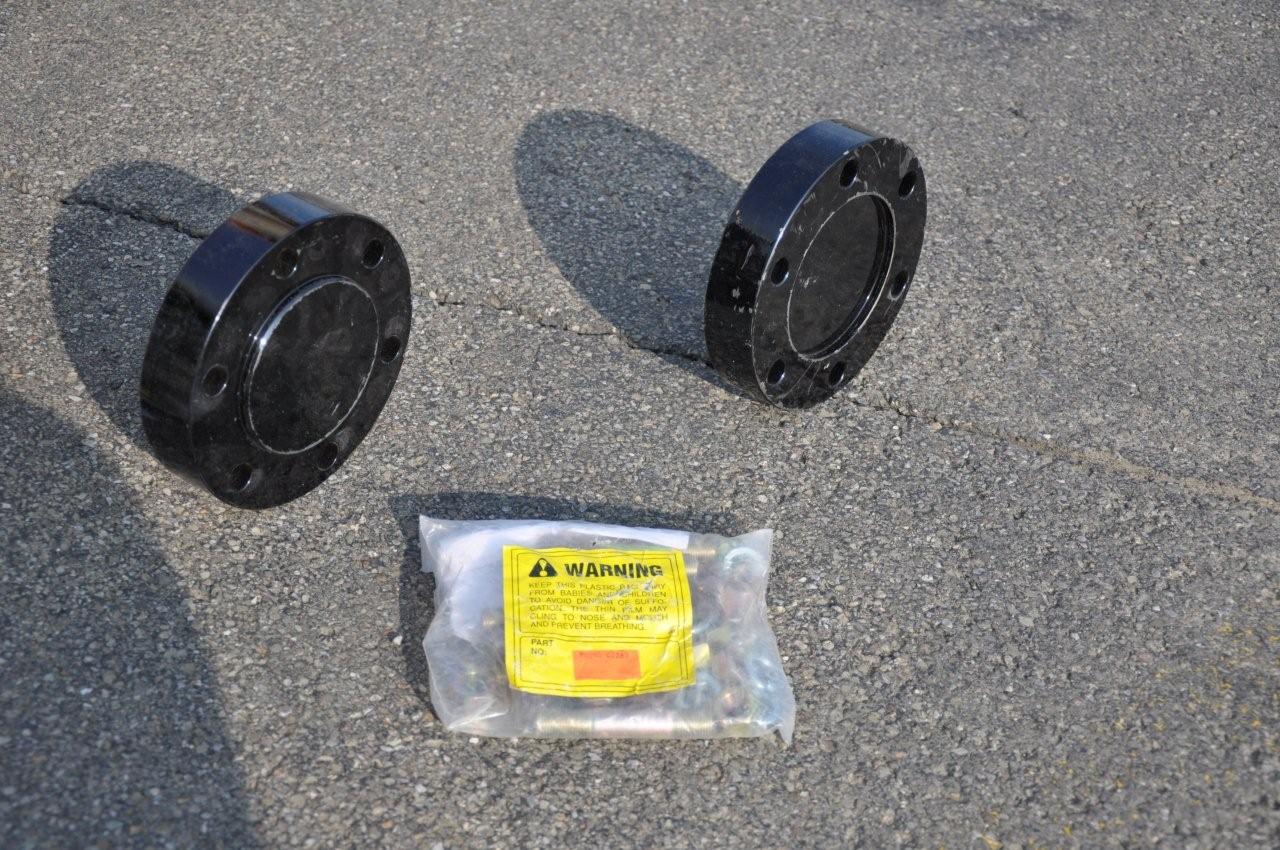

Hey all, I just bough the wheel spacer kit for the b3200, its two tick pices of metal with holes, and some threded bolts, no heads. Looks like I will have to use two nuts to put the bolts in, I am not sure how this works, any thoughts would be nice. Photo attached.

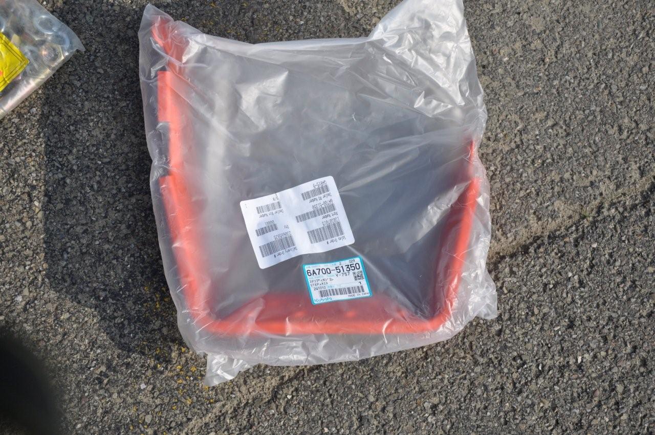

I also bought the step aid, for the 3200, its Kubota part number 6A700-51350, looking at the tag, its made in Japan!

I have the same kit on my B2630. The two nut method as mentioned works well, but if you have loaded tires have some one with a strong back there to help put the tires back on. This is because the kit has no bolts used to line the tire up so you have to position the tire just right or you will destroy the threads on the studs.
It is amazing how much stability the 3" will add.
/ Wheel spacer for B3200 question #4
Be carefull taking the original two short studs out. I had to use a torch to heat up the hub a little, the lock tight they used was tough stuff. I actually destroyed the threads on the first one I tried to remove and had to weld the nut on to get it out. When you get that step on your gonna love it, I can't imaging not having it now.

Thanks for the advise, I knew this was the place. I am worried about removing the short studs that RobKinNH is talking about. TwinCam88 I was told the same thing about the MMM, so I am looking for a RFM now. Now I still have the little BX23 to help me with the tire change out, but after two months listed for sale, finally have a good lead on selling it, so It may be sold before I get Home to put the spacers on. Also Develdog1, if your on here, I will be working out of Lockpport Monday, over in Rochester NY today and tomorrow.

Troy if you don't mind I would also love to see pics of where the step bolts up as I gave my 2910 to my dad and he needs a step to get on and the step for the 2910 is 94 bucks that step is 24 bucks and if I could make it work that would be cool. I have a welder and a plasma cutter so I'm thinking I could thanks in advance for your help
