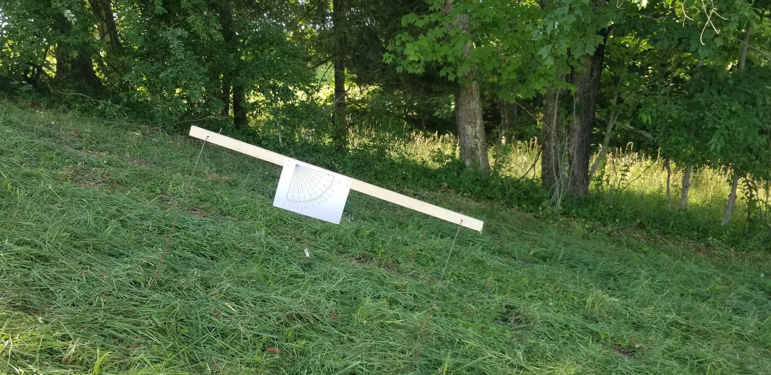

Oh well, you have inspired me to check the steepness of a slope I drive up and down with some regularity. "...a very good 4WD farm tractor with top condition tread AG tires cannot climb that [30 degree] slope nor ease down it..." you claim.
And maybe that's correct. I don't have "a very good 4WD farm tractor", but have gone up and down it with regular tractors, a Daihatsu HiJet, Jeeps, and...okay, I don't think I ever tried it with the BX25D. That little thing is a bit too squirrely for my liking, and the prairie dog holes at the bottom are large enough to engulf its teeny front tires.
Stay tuned for a number, in degrees. It'll be based on fact, not opinion.

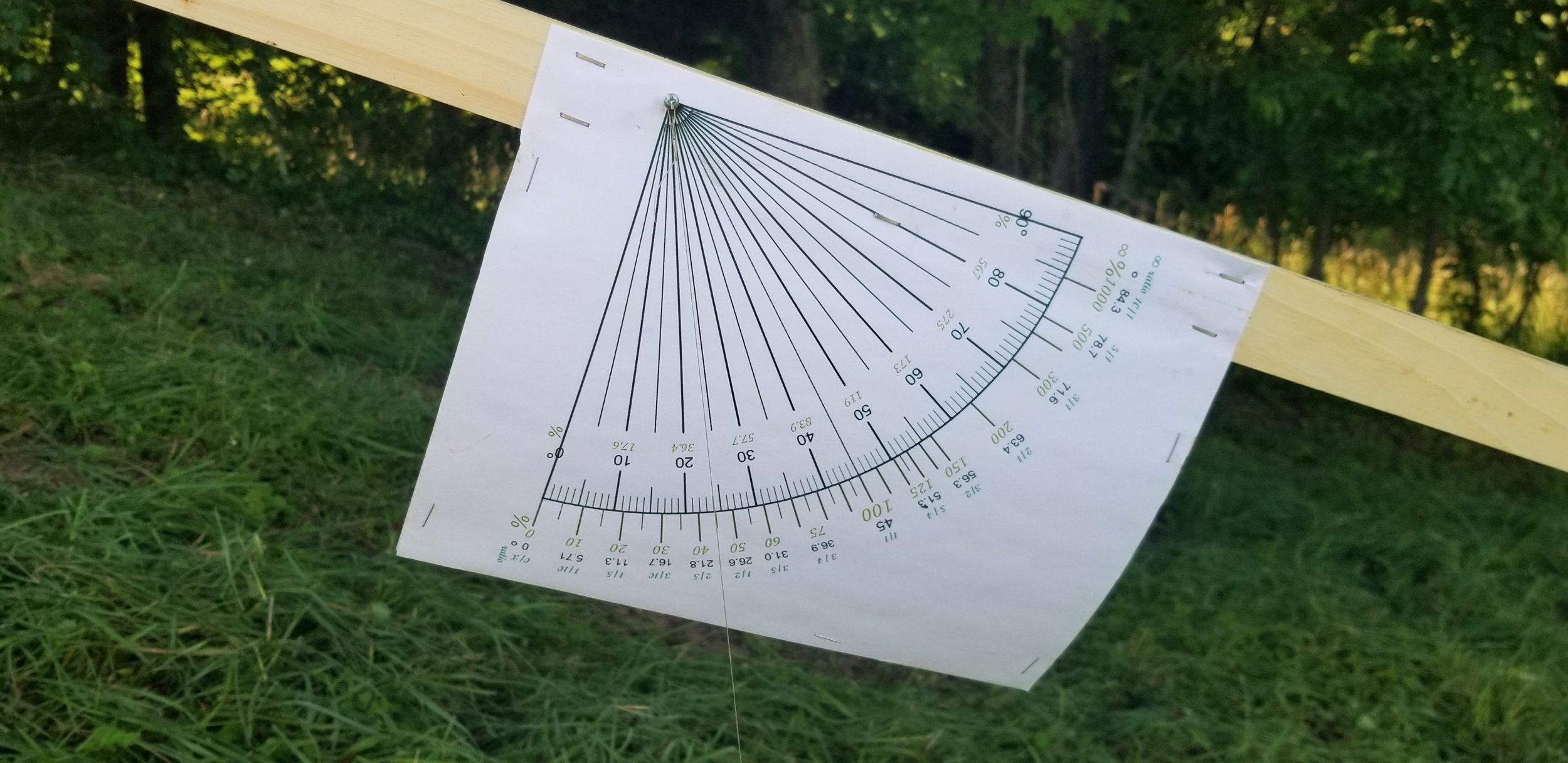

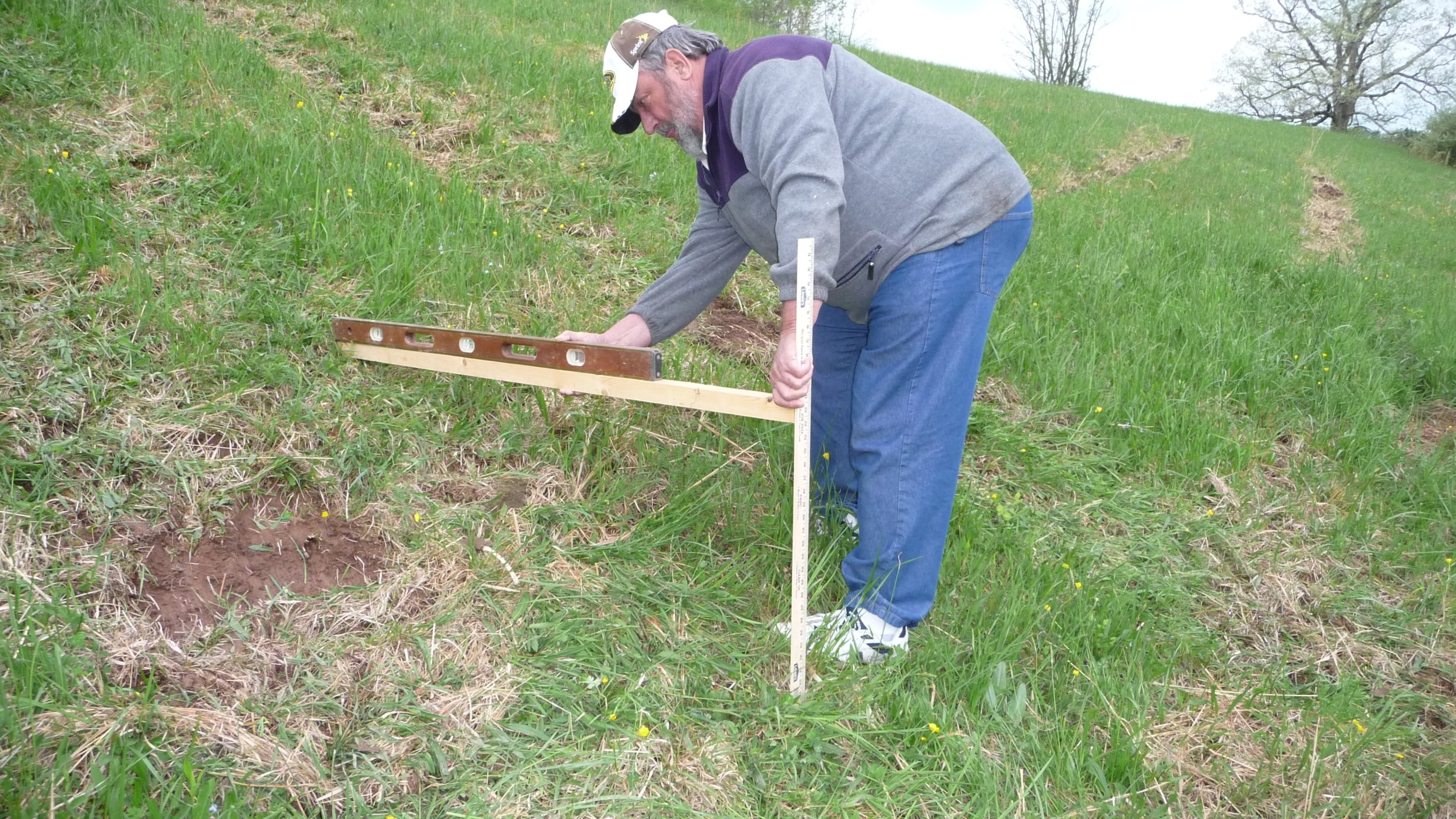

Well, shoot. No wonder I can drive up and down that slope with just about anything, without even slipping a tire...it's only 29 degrees - thankfully shy of the 30 where everything would supposedly just slide down. Except, possibly, a good farm tractor.
And come to think of it, I've driven one of the backhoes up it, too, in about 14 inches of snow.
That was in 4WD and the diffs locked, and with good tire chains. Anyway, it sure seems like another degree would really matter.

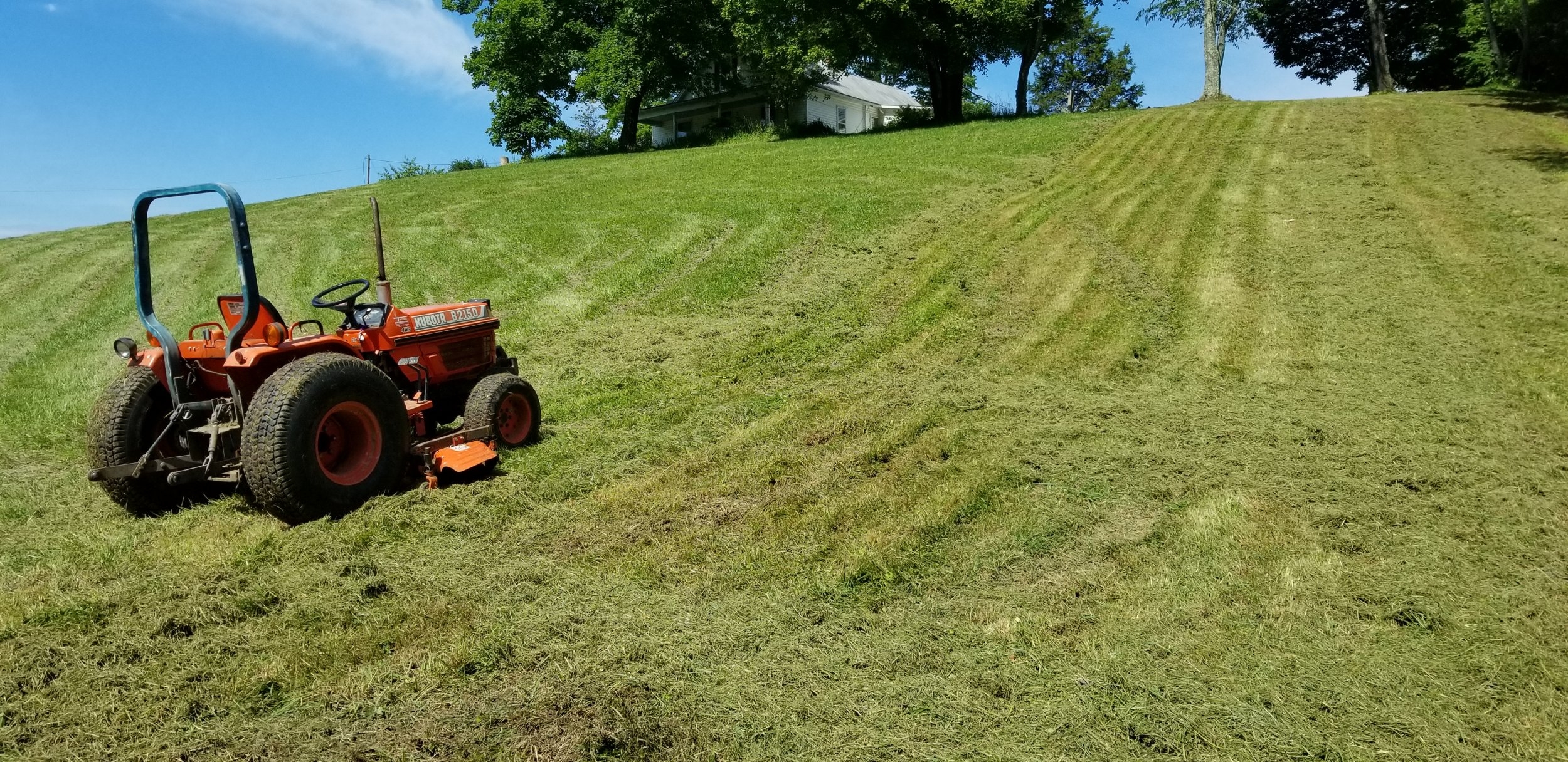

Yeah, I really should put them in the tractors, too, eliminating much of the perceived problem and instead having an idea about what the tilt really is.
So far I haven't rolled a tractor, or even only laid on on its side, but that day may certainly come. Of course, an inclinometer won't really help in my two most likely scenarios.
Having the rear blade at max offset (to get snow about five feet away from the edge of the driveway) while driving right on the ragged edge of it will probably make it happen first. It's not so much that a tire slips off the edge, that I can handle, but when the blade catches frozen clumps and somewhat abruptly turns the front of the tractor hard right. Simple physics.
Next is that the edge of an irrigation ditch gives way, or I steer into it while looking at the mower behind me. Again, driving as close to the edge as possible. Of course, that wouldn't even put the tractor completely on its side, so it'd be easy to retrieve it.
Anyway, I suspect that most injuries resulting from laying a tractor on its side (I would imagine that rollovers must be somewhat rare with modern tractors) are because the operator sticks his arm out in a futile attempt at protecting himself or the tractor. Much like passengers in 4WDs often grab the rollcage when things get iffy.

Recently purchased a B3350 with a cab. We added rim Guard and 2" spacers. Big difference. Pucker factor way to high before for my liking.
