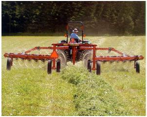

   / Wheel rakes with irregular fields? #26
This is the type of Sitrex rake we have now. Heavier duty and more convenient. Can use it as a single rake too. Also picks up high enough to get yourself out of a jam.

   / Wheel rakes with irregular fields? #28
What kind of hay do you put up? Care to do a quick review?

   / Wheel rakes with irregular fields? #30
We just make mixed grass hay. Just feeding beef cows. The 704 rake broke in two last summer. That was the final straw.
   / Wheel rakes with irregular fields? #31
Here's the Bush Hog rake I use. BSR Hay Rake. I have the 10 wheel version which is the 8 wheel with a bolt on for the other two wheels. I looked at a used JD 70X and it was full of welds and braces and new cracks in the frame-very poorly designed in my opinion.
   / Wheel rakes with irregular fields? #32
What about the sitrex rake? How's it holding up? Likes or dislikes.
   / Wheel rakes with irregular fields? #33
Got it at the end of last season. Only got to use it on about 22 acres. Seems really well built. Like some of the features. Can pin the two front wheels up if in really thick hay, leave one side up, leave center wheel up or down. I liked it. Find out more this summer.
