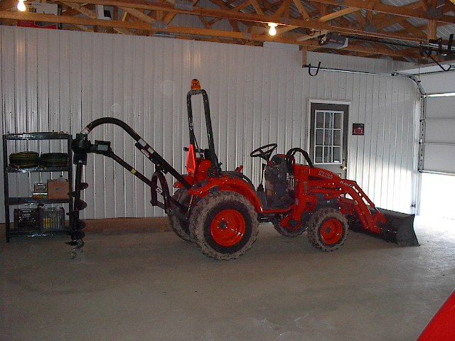

I Just purchased a PHD w/9" auger from Northern Tool for $565 delivered. Would this price make your bride panic? If not, then I would order one. I think they are still on sale.

If the Hoedad is appropriate for the trees, I wouldn't spend most of my implement budget on a post hole digger if you only have a one-time fence project. They dig so well that you could rent one and have all the holes done quickly. Besides, I bought one for a couple of jobs and have been tripping over it for 4 years. They don't store well.
If you agree, now we have $600 to spend for you. This board loves to spend other peoples money. I'd recommend a box blade. It would also help with driveway maintenance if you have one.
