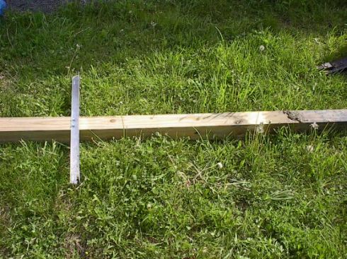

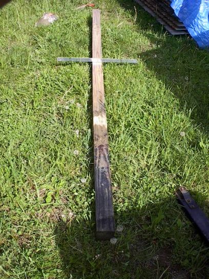

I started pulling posts today. Here's what I did:
I took a piece of angle steel (approximately 3 feet long) that I had laying around and lag bolted it to the 4x4 with 5/16ths x 1 1/2" long about 47" from the top. I then pulled up to it, curled the FEL all the way back, squared off with the FEL, and just lifted them straight up and out. NO CHAINS, ROPE etc. were needed!!
Once cleared from the hole, I just gave it a little forward tilt and presto, they just gracefully slipped off and fell forward to the ground. See attachment.
Thanks to ALL for your input. Gerard
P.S. I'll try to get more "at work" photos posted. G

Another view...

That's too bad that you had to take the time to lag bolt a piece of angle iron to the post. The chain (or strap) method would have been the fastest and easiest (hence the point of your thread)
   / What's the easiest way to..... #37
Re: What\'s the easiest way to.....
31 posts X 2 lag bolts in = 62 bolts X 2 lag bolts out = 124 bolts to handle. Yikes! /forums/images/graemlins/tongue.gif /forums/images/graemlins/laugh.gif
Glad it worked for you. Did you at least try the chain or strap method? It really works well. /forums/images/graemlins/wink.gif

Gatorboy and MossRoad:
Those are very good points and well taken but....
....I am using 3 pieces of angle steel.
My 15 year old son is helping me by installing them on the posts.
I pull one, drop it, and move on to the next one.
As I am moving to the next one, my son goes to the fallen one, (cordless drills are a wonderful thing) removes the angle, and then reinstalls it on another one (6th one down the line).
This way is safer to me as my son is not working directly around the tractor and I am not getting on and off the tractor all the time. Works well for us as we have a nice rhythm between us. /forums/images/graemlins/wink.gif G
