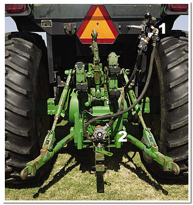

Want to thank all for the advice. Jeffinsgf. Excuse my ignorance, I have only been a tractor owner for less than 3 weeks. If I have a carry all connected to the PTO (to raise it off the ground) how can I connect a PTO roller pump at the same time? Also I have no idea what that looks like.
Eddie
Eddie - The carryall is connected to your 3 point hitch, and is basically a platform to put things on such as a barrel, tank , etc... The Roller pump is attached directly to your PTO shaft via a coupler and then hoses extend from the pump out to your tank on the carryall in order to draw water or provide pressure for pumping or spraying. Lifting the carryall platform should not interfere with the roller pump operation (generally speaking) since the hose are soft/flexible and not hard plumbed or fixed in place.
Attached is a view of one on the PTO driveline (item #2)
   / what's the best way to water plants using the tractor? #33
Followup to prior response.....DO NOT forget to install (AND USE) the safety chains or mounting bars on your roller pump - otherwise it will simply spin on the rotating PTO shaft; tear off your hoses; and use them to beat to death anything standing nearby........don't ask me for pictures of this event, I'm still trying to block out those images.

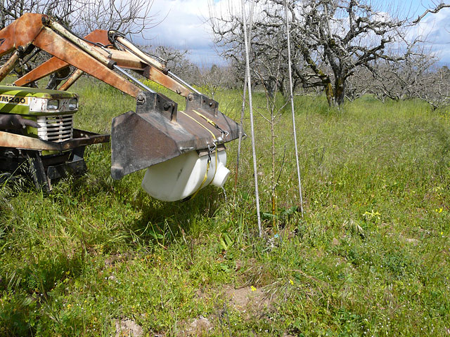

This weekend's experiment - watering with a 25 gallon container. There's a 4x4 under its back edge to tilt it more. Works great.
Back in post #2 I referenced a rear platform I also use.
Now all I need is a pump to replenish the front reservoir from the rear tanks while I drive to the next replacement tree. (they are scattered randomly in this old orchard).
I'll never need to get off the tractor!
   / what's the best way to water plants using the tractor? #39
Excellent use of the tank and front end loader California!
