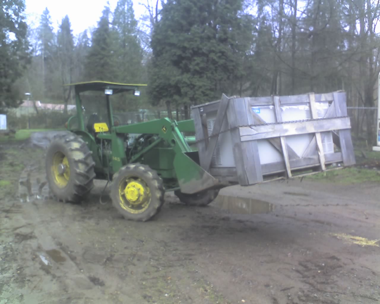

I wonder if it could have anything to do with the newer tractors being lighter than the older ones. I've never needed ballast. Even when I carried the 1,500# 45KW generator down to the lower ranch in the front bucket.
Good question, probably is the weight, but also the larger stance of your tractor compared to a smaller CUT, My loader can lift 1500 pounds, that's a decent amount of weight for a relatively small platform, the smaller footprint makes it easier to get unstable.
Talk about foot prints, I've seen your Sasquatch :) (your avatar)
JB.
JB.
Yeah, she's a beast. I have the duels off right now as seen in the pic I posted. I'm going to need to get into some tight spaces soon to move some equipment. Sure mkes it easy getting in and out of the barn right now. Should go back on in June or July. The new barn will have a 12x12 door.
