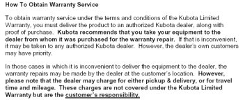

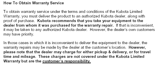

I dont mean to sound like a horses rear or anything but if the tractor is still under the manufacturers waranty it doesnt matter where its at there supposed to retreive it or fix it where it died. I worked for a company from Missouri as an operator. They bought a new 300 Komatsu excavator in Missouri from their local dealer. I was operating it next to the Tennsee river in Barton Alabama and blew a final drive shaft. Alabama's local dealer/ mechanic refused to work on it, where it was and it was still under warranty. So we called Komatsu,s home number in Georgia they told us the local dealer would be out to fix it that evening. by then he had to dig 2 feet of red clay with a shovel and repair the final drive.
   / What's ailing my bota 4610" #67
Re: What\'s ailing my bota 4610
<font color=blue>...but if the tractor is still under the manufacturers waranty it doesnt matter where its at there supposed to retreive it or fix it where it died.</font color=blue>
Attached is the pertinent portion of the Kubota warranty. It says repairs may be made by the dealer at the customer's location. While this could give them a way out, I would certainly give the dealer a call, tell them what happened and what the situation is and ask them what they can do. At a minimum, I would expect them to send a mechanic to diagnose the problem to determine if it is fixable in the field.
