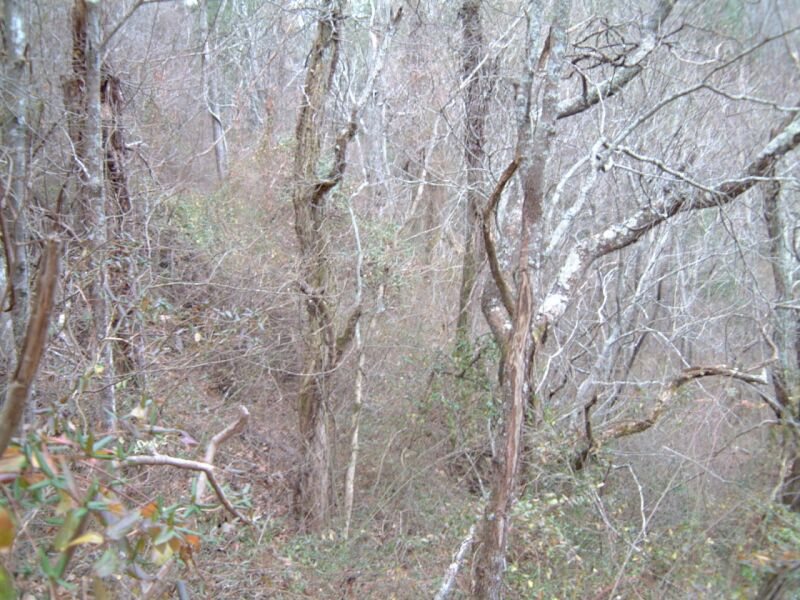

That was exactly my thinking, Spencer. Billy, it's kind of a ravine down there. I've wanted for two years to do some brushcutting down there but was afraid i couldn't get back up. It's enclosed on 3 sides in a sort of 'amphitheatre' kind of setting.
Also, I've never been down there with tractor. just the Mule. I only backed down to where Mule was to pull it up.
The other factor is..there's a very narrow passage through that jungle.
Maybe this pic will help you understand what's to the side and below me.
and...Winching is Plan B if i don't get a dozer in next couple days
then i might ask for help on what kind, size etc.

yes, that's one of first things I've done. Everytime I go over there to try something else...the diff lock is something i always check.
this pic shows area where tractor would roll to or where i would back it down to.
'not for the weak-hearted'
