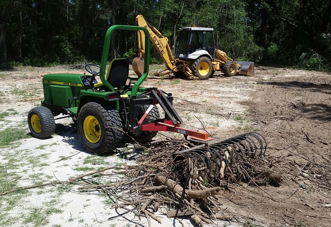

This is an inexpensive 5 footer from Agri Supply. I am planning to add gauge wheels to in in the near future to assist with leveling. Mine has every other tine removed in this picture but I have them all back in for smoothing ground now.

The landscape rake did a pretty good job! No broken teeth, just one slightly bent one.
