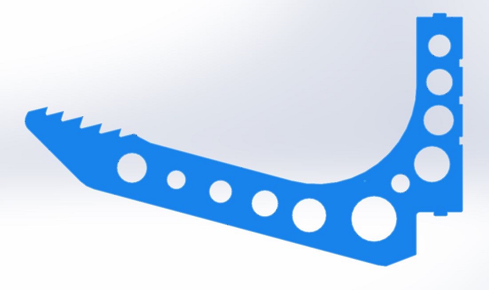

Here's a pic of the newly modified tine. These notches are cut for a 3/16 x ス cold roll radius on every corner for strength.
All sizes have been completed, so the new ones that we make will all be updated.
The one shown has 3 notches and is for our Compact Wicked Grapples(50"-72"). The Wicked Utility Grapples(55" and 73") will have 4.
Travis

Why are they in the weak axis? Seems like they'd hold up better and block even less view in the other orientation. You also get more weld surface; although that's likely not an issue either way.

Off the top, without adding more material, the axis you're asking about potentially weakens the grapple's strength.

You mean on the front side? Think it would sustain a lot of damage real quick up there.

Eric, once you weld the bars in, there's no weakening of the plates unless you only weld one side of the joint.
Another option is to counter sink them slightly from the back edge and put a weld across the gap. Sure, it's not 100ksi, but 70k from a decent MIG filler is going to be plenty.

True, but think about the time it takes to production weld a lateral over a vertical axis.
Also, as a user I think a horizontal axis will be harder to unload twiggy debris than a vertical axis. Time will tell with feedback to verify.

I don't think those slats would add much time even with the added length of weld a horizontal orientation would have. It's going to add some time, and cost, no argument there. How much more one to the other is maybe 10 minutes per unit? Hard to say without knowing how far the bars go and how many joints are there and if they're seam welded or just stitched.
As for which way would trap less stuff - I'm not sure. I don't know if a sharp edge vertically would be less prone to grabbing than a flat in the horizontal with something stuck in between it and the next one or the jaw plates. Vertically would possibly stop more, or could just result in a smaller opening for it to get jammed in.
