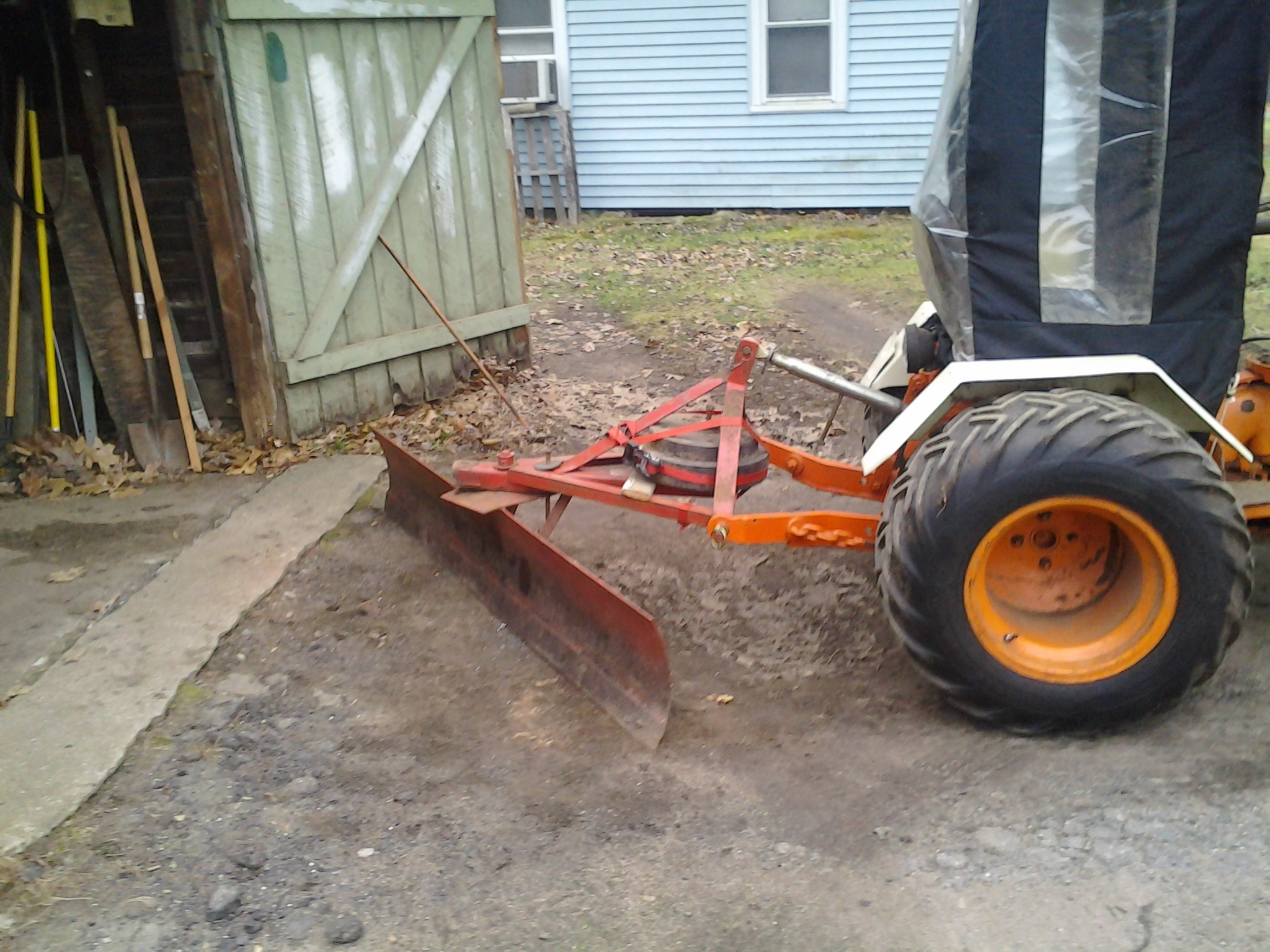

I had a simular problem this winter using the grader-blade, the blade assembly was less than 120lbs & would take forever to drop in float. I added a 150lb wheel weight inside the frame of the grader blade & bolted it in, works great now.

Don't forget you should have a drop rate adjustment knob at the front edge of the seat near the floor, to make any weight implement drop as fast or as slow as you want. I realize by putting more weight on the implement you made it work the way you wanted, but you could have made the blade drop fast without the weight if you want to by turning the knob counterclockwise.

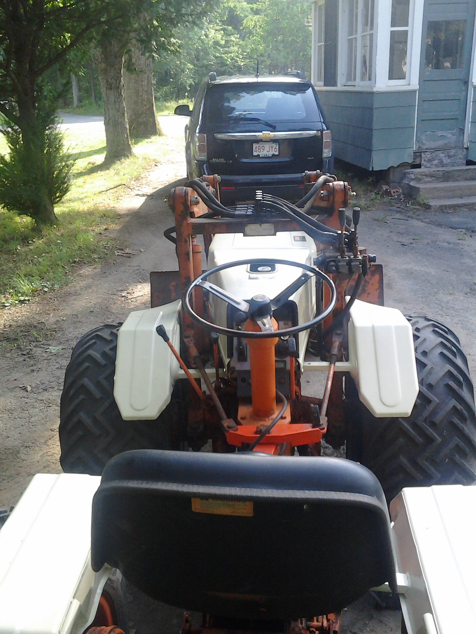

Yeah, I would turn my "rate adjustment knob" on the flow-control valve of my tractor for the 3pt, if I had such a valve. My Pasquali 993 has no such flow-rate adjustment. I have thought of changing over alot of the hydraulic system in the future, due to the heavy use of metric-banjo fittings on valves & cylinders thru-out the machine. Also the location of the lever for the 3pt, really peeved me, it's to the left of the steering wheel. So I'm reaching forward with my left hand to control 3pt, steering with my right, plus looking behind me, all at the same time!
