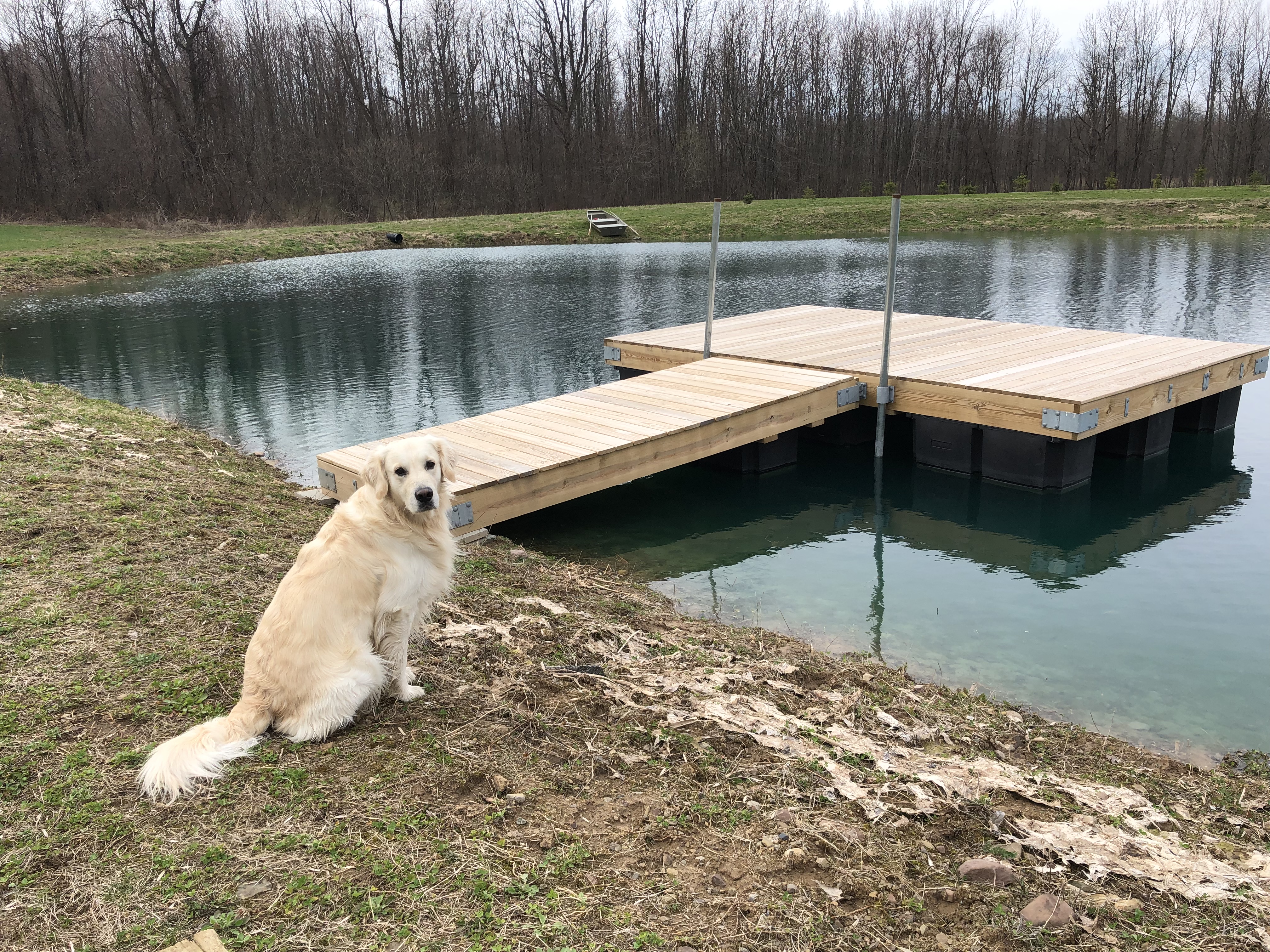

I went with a floating dock and metal pipes to handle the 2-3 foot swing in the level on my pond. The only downside was the cost for floats but you don’t have to worry about any waterline rotting.
/ What wood for a dock?
#12
I kicked around the idea of doing a floating dock (haven't looked at pricing) but how much "moving" does it do when walking on it?
