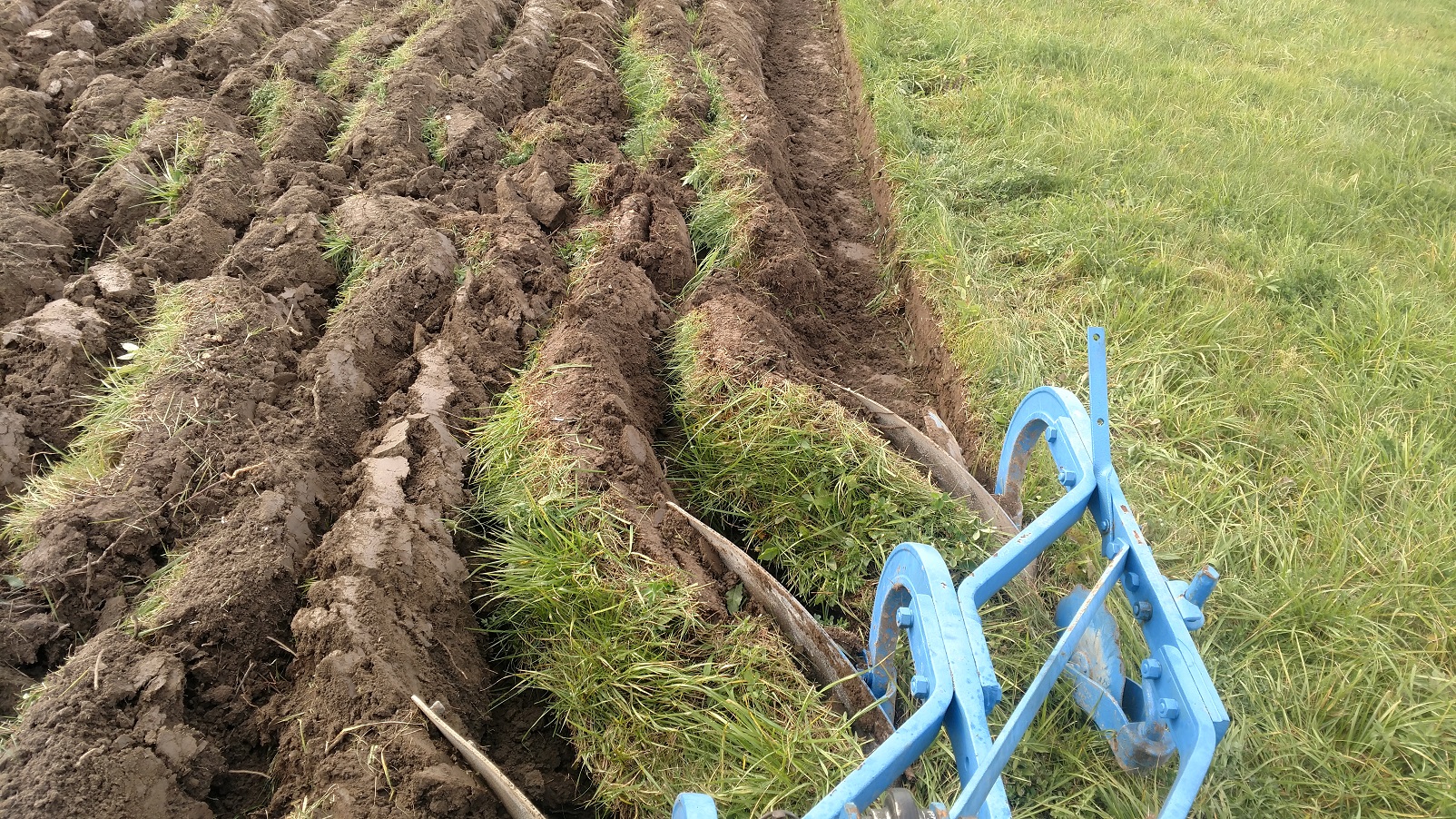

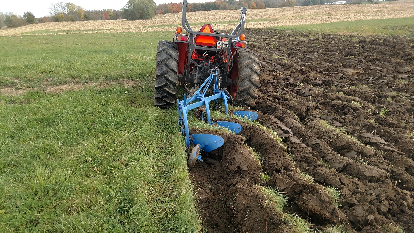

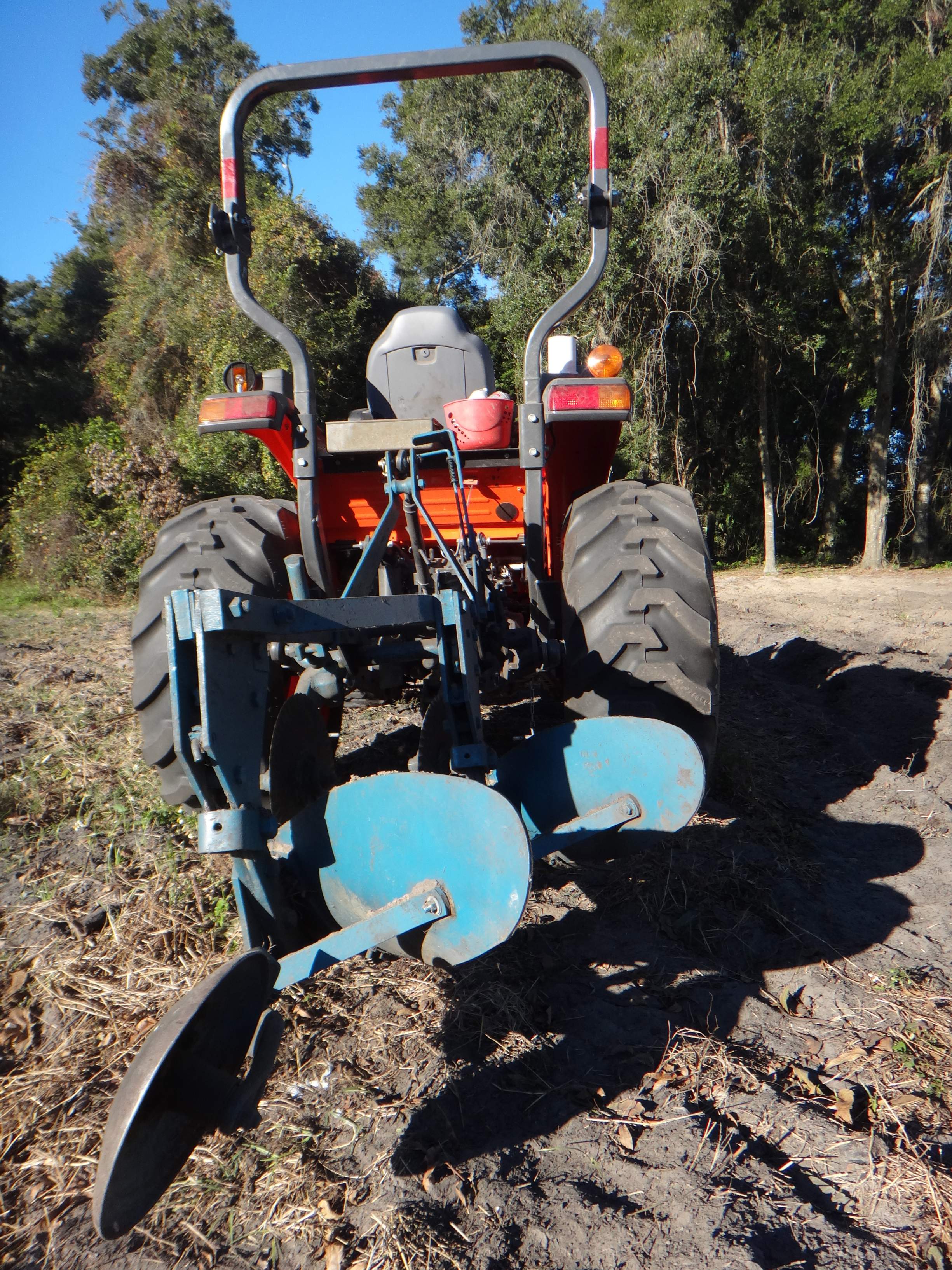

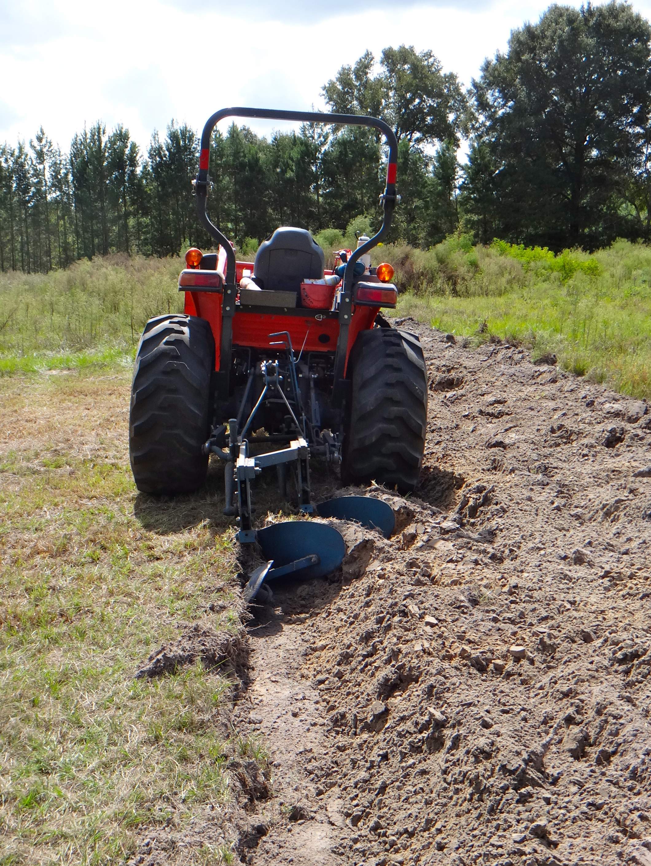

I have an L3560 with air-filled R4/industiral tires. I pull a 2 X 12 Ford Series 101 Moldboard Plow in Florida sandy-loam in HST/MED/(low), 4-WD and full throttle.
When breaking sod, R1/ag tires are advantageous.
A 2 X 16" would be NO GO.
