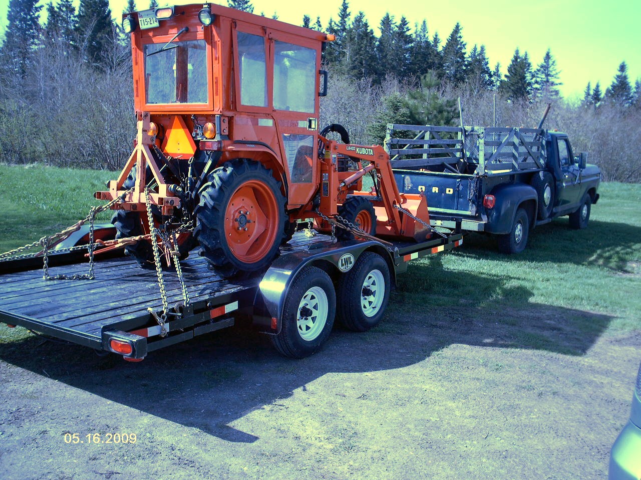

I have a B7800 with FEL, cab and loaded rear tires. I estimate it to weigh 3,500 - 4,000 lbs. I carry it on a 16 ft., 7,000 lb. GVW equipment trailer that weighs 1,500 lbs. It has electric brakes on both axles. I don't have any major hills to tackle and my normal trip is 50 miles, twice a year. I also use the trailer for hauling firewood.
I towed this setup with a 1979 Ford F-100 that I upgraded by adding 2 extra leaves to the rear springs and installing heavy duty variable rate front springs. The truck has a 300 cu. in. 6 cylinder engine and a Warner T-18, 4-speed transmission with deep low gear (which I installed in place of the original 3-speed.) This truck pulled the trailer (loaded with the tractor or 2 cords of firewood) amazingly well; no sway at all even without a weight distributing hitch. The Ford big 6 was no ball of fire, but it has amazing low end torque.
Due to a bad case of the rusties, I have just replaced "Old Reliable" with a low mileage 2000 GMC Sierra 1500 with the 4.8 litre V8 and the infamous 4L60E overdrive automatic. Its maximum tow rating is 7,000 lbs. I decided not to beef up the suspension on this truck, but have purchased a weight distributing hitch instead and have installed a new trailer brake controller. I am considering adding an auxiliary transmission cooler. I haven't pulled the trailer with it yet, but its first job in the next few weeks will be to haul the old Ford (empty weight about 4,000 lbs.) to my woodlot. I hope it handles the job as well as the old Ford did.

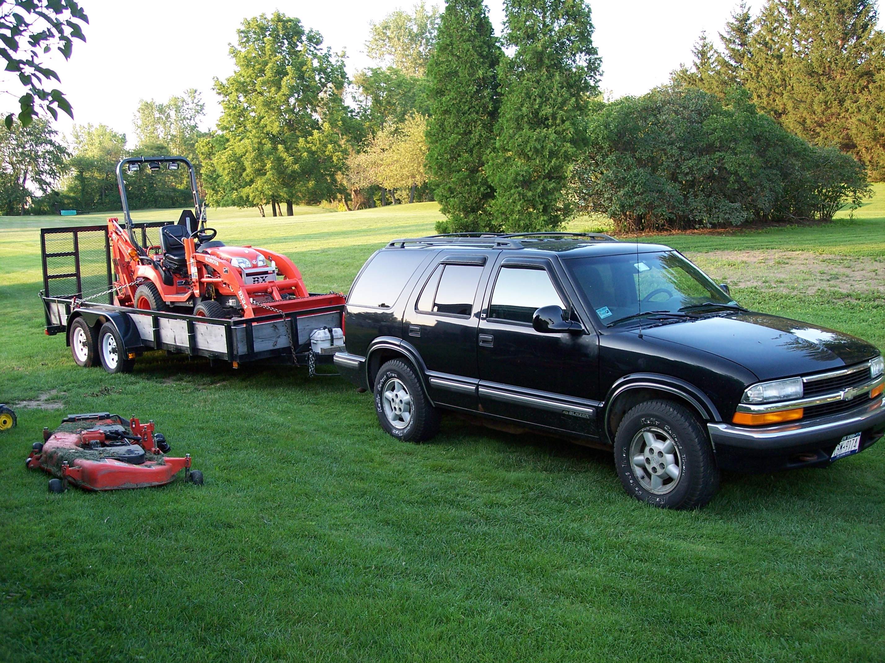

I already had the s-10 blazer, I bought the 16' trailer and it works just fine with this setup. Since the engine is only 4.3L, I have to be mindful when approaching the hills, other wise it does just fine on flat roads. I added the weight distrubution bars and sway bar and it makes a world of difference with this short truck.
I suspect that since you are on a limited budget, you may be able to find a simple 2wd full size pickup truck for cheap that will suit your needs for now.
