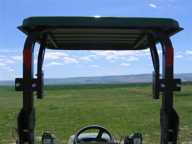

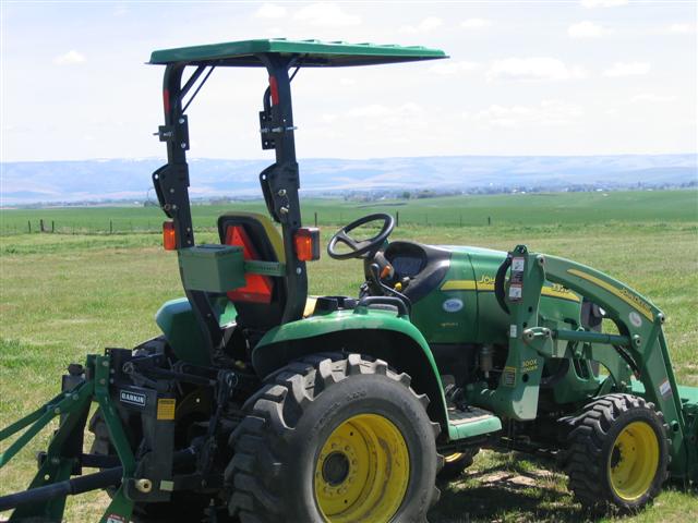

I've been looking at canopies. Getting tired of getting sunburned - even with the SPF smeared on. /forums/images/graemlins/grin.gif I've found some others that are really nice and not a whole lot more expensive until you include $120 for shipping. /forums/images/graemlins/ooo.gif /forums/images/graemlins/mad.gif /forums/images/graemlins/blush.gif /forums/images/graemlins/crazy.gif The one thing that has stopped me from ordering this one are lights. Currently I have 2 lights on my ROPS. These will have to be moved. Is this canopy strong enough to support a couple of lights? What about vibrations? Do you notice sound echoing off of this? If so, have you considered some type of insulation, even if just the styrofoam type?
/ What type of canopy? #22
I don't think I'd mount lights on this- but I could be wrong, however, given the flexibility of the mounting system you might be able to leave the lights where they are. When I use the tractor I wear ear plug type headphones or ear muffs with headphones mounted inside, so don't notice the noise. I will say that I didn't notice any new or change in noise while bush hogging yesterday.
