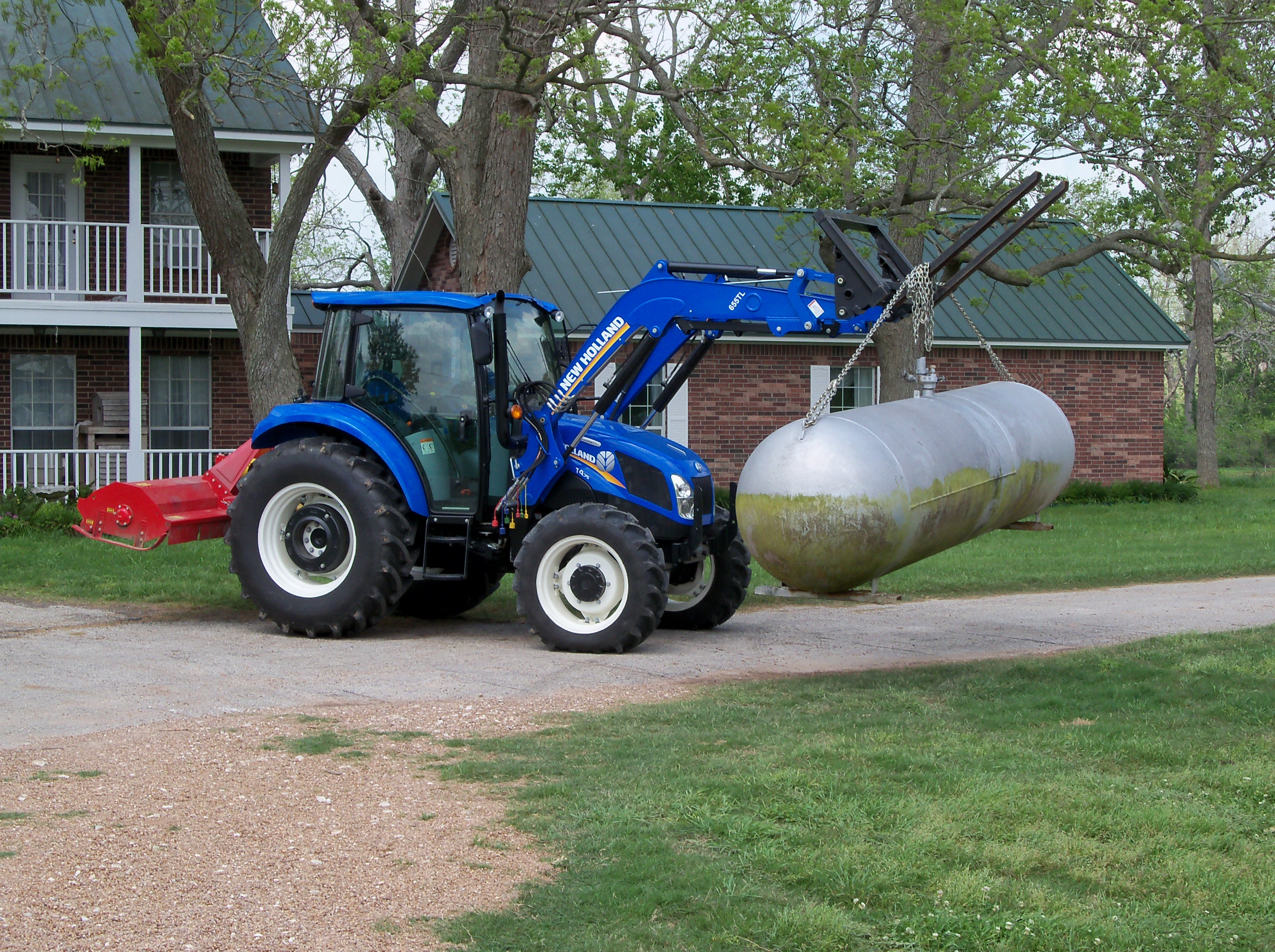

"I still need to be able to trailer it and tow it with my 1/2 ton truck. "
I trailer my 75 hp New Holland with 850 pound Rhino cutter with a 1/2 ton PU so I doubt you will have any problems....:)
