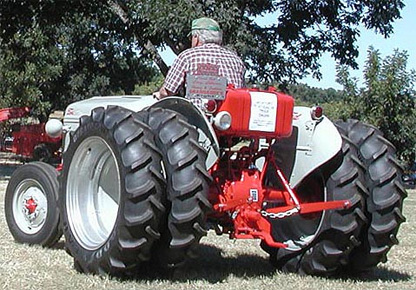

My bet is that this 8n
would pull that plow no problem.
It's all about hooking up to the ground, period. Load them up and it will hook up all the better.
