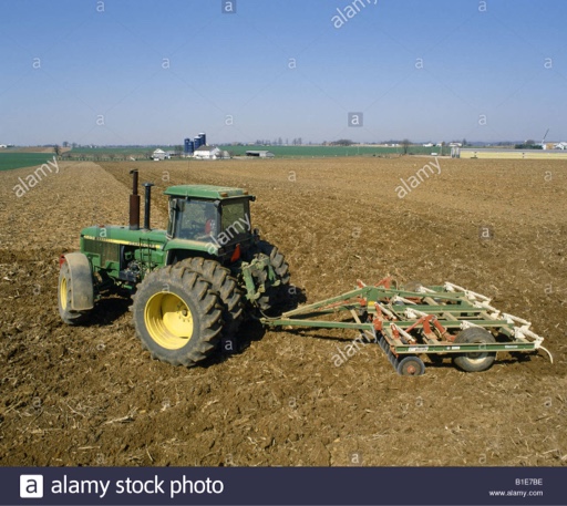

Conservation Plows, which include Chisel Plows and Field Cultivators, do not invert the soil. Primary field function is to fracture/aerate soil including fracture of hardpan, preserving existing verdure to prevent rain and wind erosion. In order for fissure to be preserved, conservation plows are pulled through fairly dry soil, another reason a lot of tractor power is required. Since voluminous furrows are not created, winter freeze/thaw cycles to assist furrow and vegetation breakdown are not important.
VIDEOS: Note flatness of field after Chisel Plow passes.
ag tractor chisel plowing field - YouTube
You can conservation plow any time soil is fairly dry before crop is planted.

If you are tilling you a field that is in grass and has not been tilled for 20-30 years, you DO NOT want to use a chisel plow on it. If you do use a chisel plow, you will have long ribbons of sod that will be an absolute nightmare trying to get broken with a disc harrow. I have seen the ribbons drag behind until you have a big ball of them. Chisel plows work on land that is cropped and tilled every year. They do not work well on virgin soil. Yes, they will work, but they leave a rough mess that is hard to get smooth. Your best bet is to moldboard plow it. Set your plow for 7-8 deep. A properly set moldboard plow will roll the sod over and leave fresh soil on the top. Also properly set, the moldboard will leave a smoother surface than a chisel plow except for the dead furrows and ends. Jeff is wrong in saying a chisel plow leaves a smoother surface, try driving crossways on a chisel plowed field, it sucks. I have plowed thousands of acres with a chisel plow and hundreds with moldboard. Each has there places, but a moldboard for virgin soil works best. Chisel plow works good for tilling each year after if you are planting row crops.
