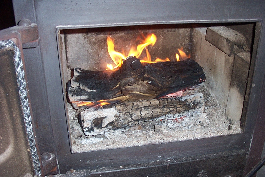

Good Evenin Jeff,
Wayne has it right, over this way they sell firewood green uncut in log length or split and still green or split and seasoned priced accordingly !
Of course being me I never pay ! ;)
So in answer to your question here is where it would go if you were closer to me ! :)
BTW this is a live shot ! :)
