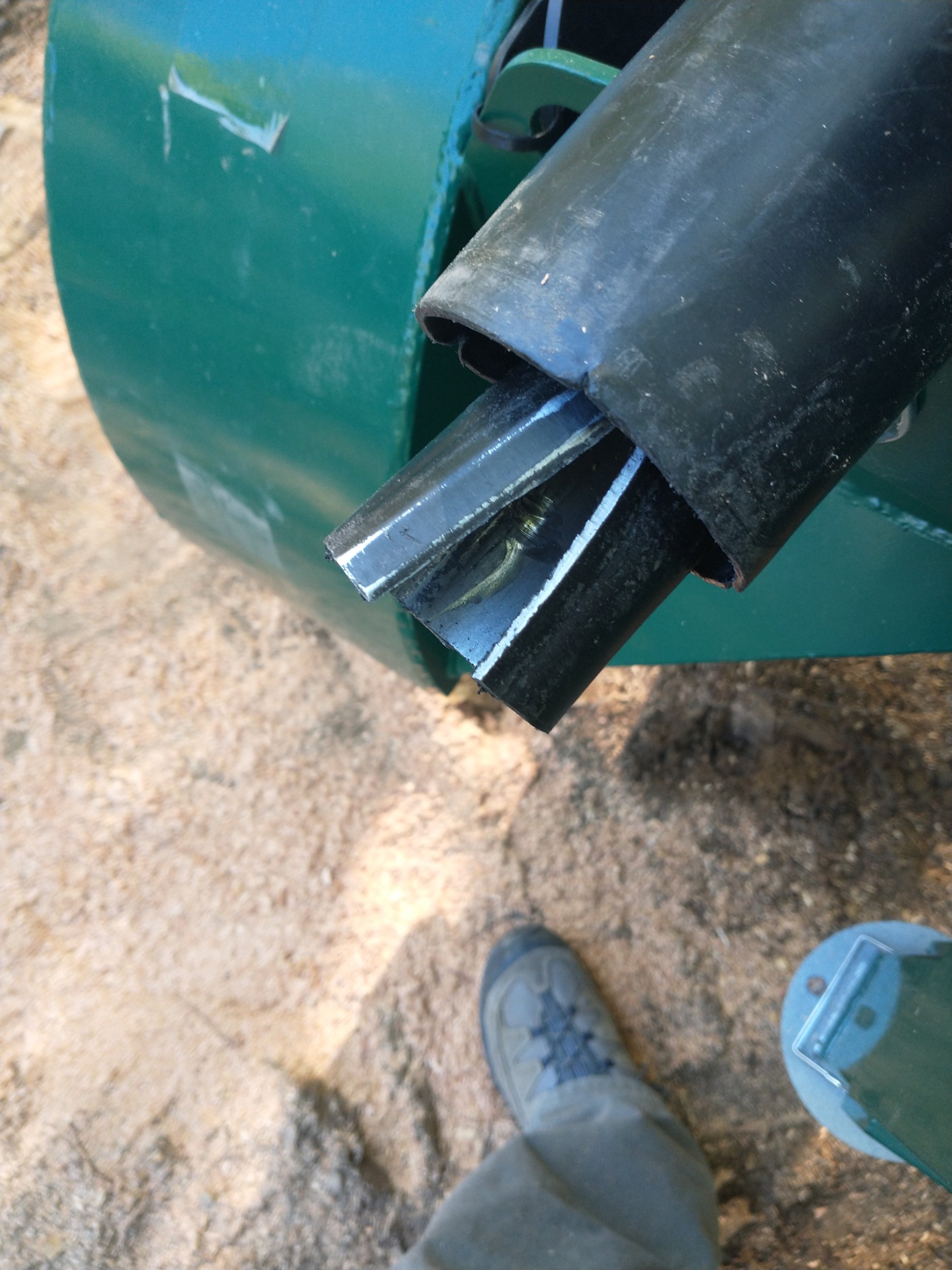

Used stump grinder, the overlap on the tubes was "enough" until I used it on a slope and almost slid them apart. Pushed everything together and then this happened about 5 minutes later
Best I could find was $84 for a series 5 replacement tube shipped, farmer bobs via Amazon. Today's project is to put it back together, not sure how the mangled guard is going to work out.
WOW does that look familiar. The same thing happened to mine and my stump grinder is that exact same green color.

Kind of makes you wonder....
I also noted that the manual recommends re-adjusting the slip clutch if the grinder has been unused, as the "tube" may be damaged and it will not be covered under warranty.
Seems like maybe too light of a PTO? Looking at what was left, seems like I had plenty of engagement.
Stuck trying to get the new tube into the yoke. How'd you fix yours?
If I remember right, (as it was some time ago now,) I bought a new half shaft at TSC for the split half and trimmed it to proper length. Then, as in any time I trim them, file the inside of the outer shaft to remove the burr that cutting leaves in there. Experience teaches you that the two halves won't go back together with that tiny little burr in the outer half. RTHen for more peace of mind, I used the 6" extension on the tractor end for added double shaft length. My shaft did come apart when it was extended and split. There's an experience you don't soon forget.
