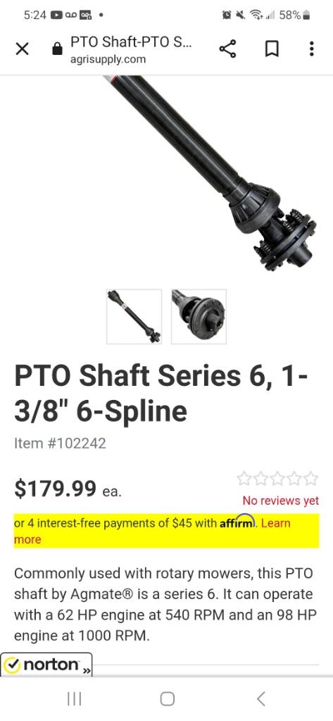

I have a few of those series 6 shafts for my implements. Local dealer had a a few I purchased for $170. These ones are not welded. They have a huge pin to hold them into the yokes. The tube sections were like $23 a piece online. Punch pins, install new tubes , cut to proper length and save half your hard earned money !

So, it's funny, my first advice, bite the bullet and buy a new one; now my old shaft is about 3" too short on new tractor, and I don't want to drop $300 for the PTO shaft to run a $150 Flail mower. I'm pretty sure I'm going to order either the Vevor one, or just pick one up at Rural King.
Vevor is pretty good, I've just bought 2 pto shafts from them, the price direct from Vevor was cheaper than at amazon, AND free shipping

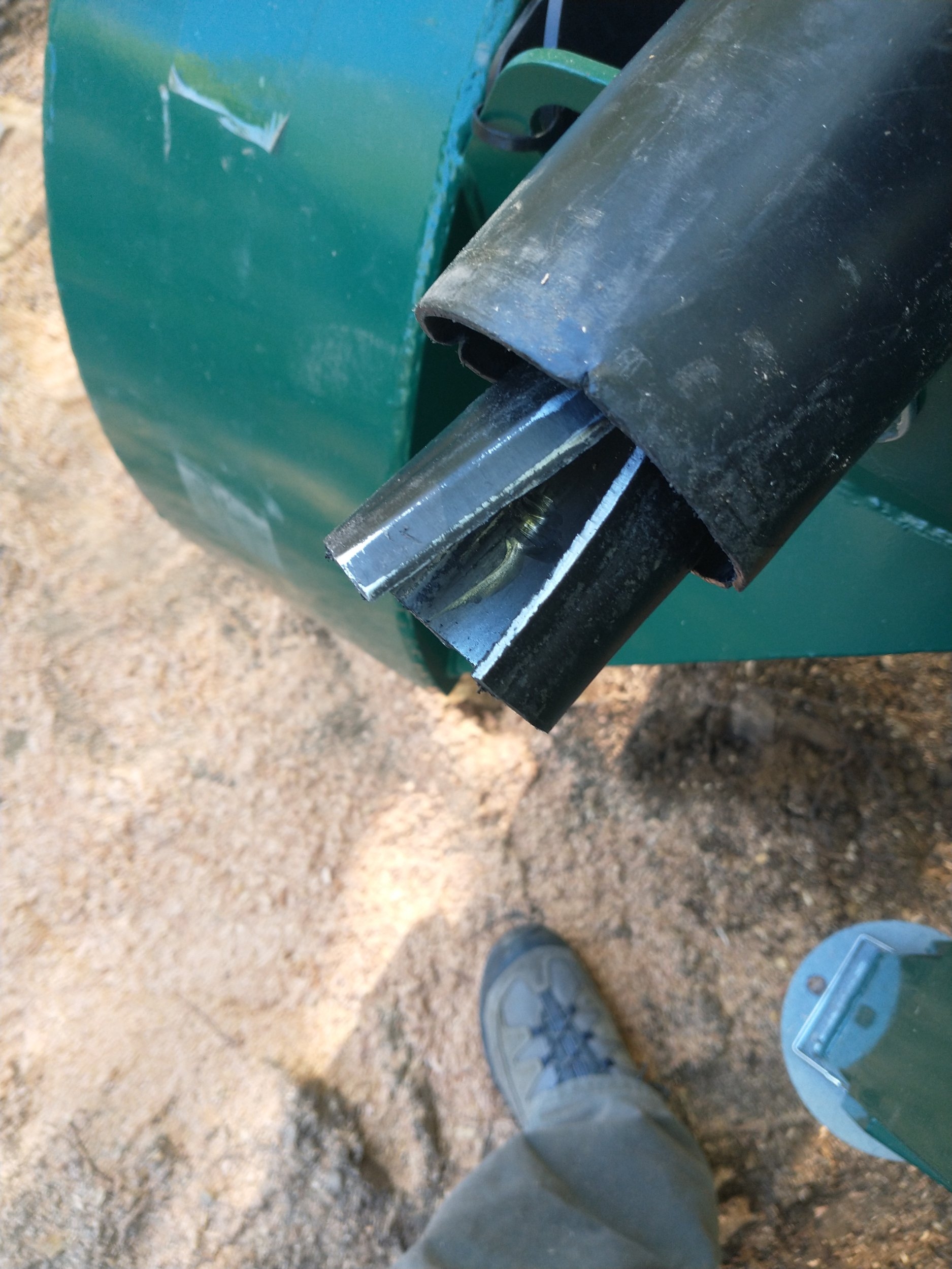

I once made the mistake of trying to set up a tiller to be used on two different tractors. One needed the PTO to be about 2 inches shorter than the other. It worked OK - for a while. But eventually, while using the tiller on the tractor that should have had the longer shaft, the tube split wide open where the pieces slide together. It never slid apart, which is what I was watching for, just split because there was too little of the two parts driving each other.
I fixed it using Mud2money's method. Bought the tube on Amazon as I recall, but it's been long enough that I'm not sure of that now. I can only use the tiller on one of my tractors, but that turns out to be a small price to pay.
Used stump grinder, the overlap on the tubes was "enough" until I used it on a slope and almost slid them apart. Pushed everything together and then this happened about 5 minutes later
Best I could find was $84 for a series 5 replacement tube shipped, farmer bobs via Amazon. Today's project is to put it back together, not sure how the mangled guard is going to work out.
