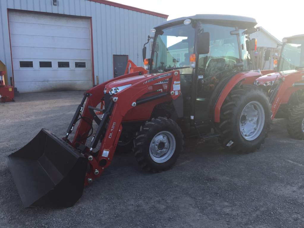

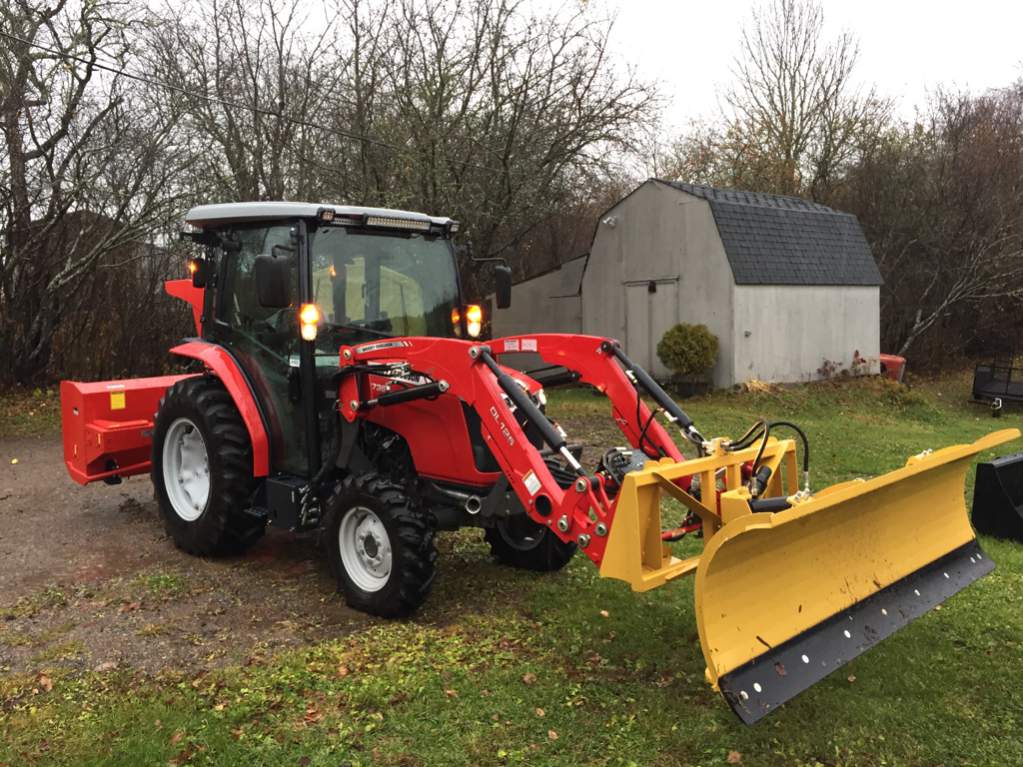

Finally........ An update.
Today a portion of the purchase was delivered.
Massey Ferguson 1736 (gear) cab
125FEL w/ 72" skid steer bucket, third function
Aux rear hydraulic 1&2
Puma 74-Hydraulic chute and deflector snowblower
Still on the way, -HLA 84" 2000 series blade for the FEL & chains
Pictures to follow when the crazy rain downpour takes a hike.
