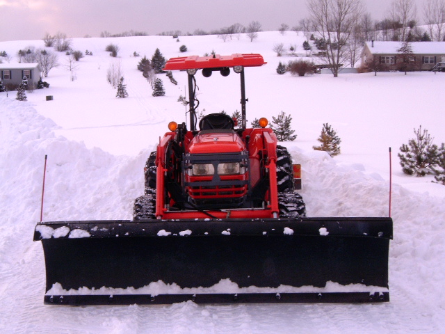

Or simply throw my chains on through the winter (like I have been for years) and push all the snow I want without a traction issue
That is true. You could have bald golf course turfs and once the chains are on, you are good to go.
