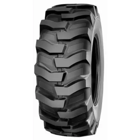

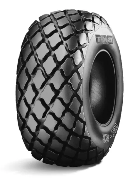

You can often find any style of tire to fit your existing rims especially if they are ag rims;
Every one of these tires is a 16.9-28 bias ply tire. They will all fit a rim that is 28" in diameter, 13 to 16 " wide
