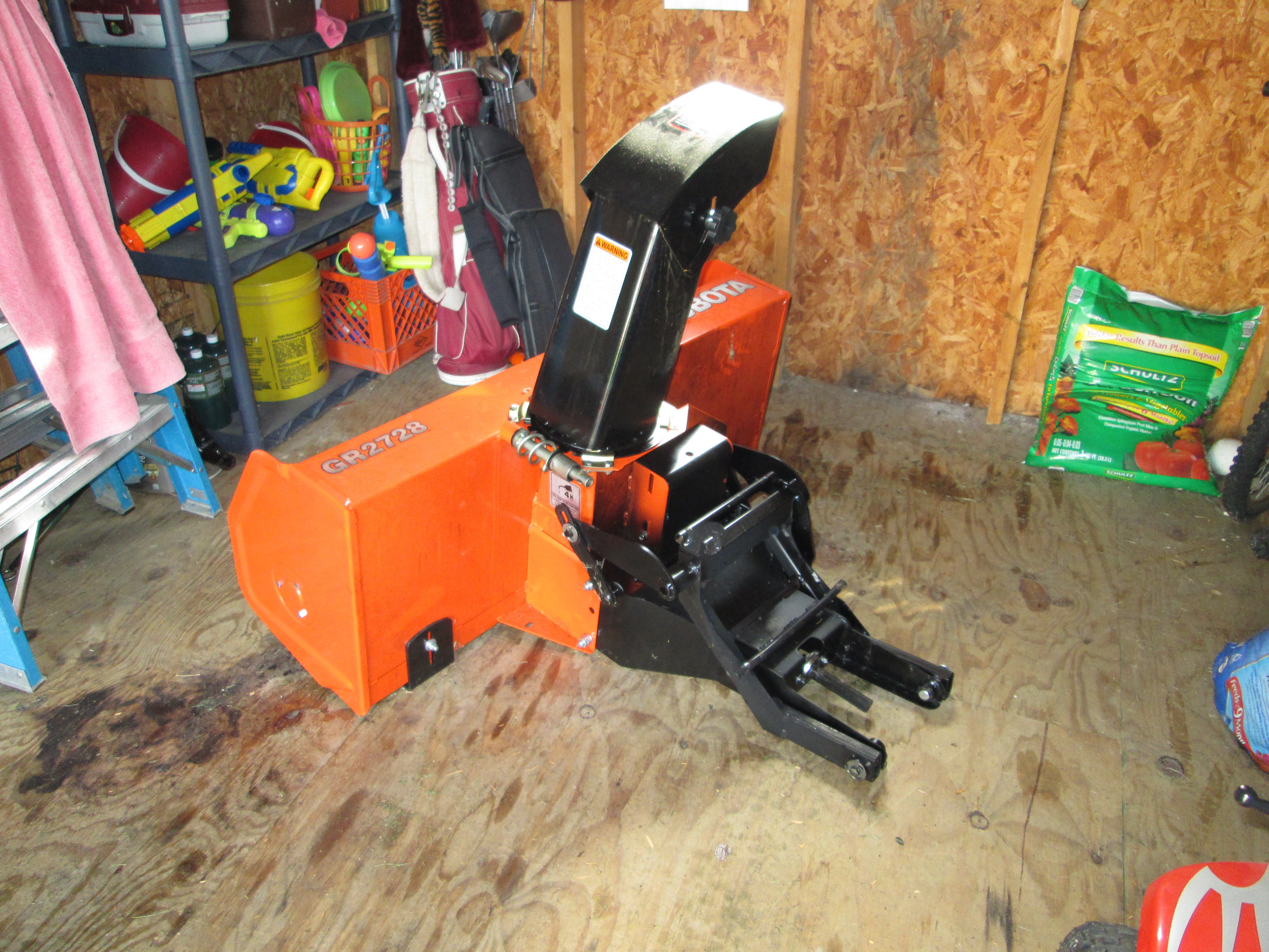

I bought my GR2120 new in June 2013 along with a GR2728 snow blower. There was an update to the fan and hub of the snow blower, but I do not know if that made the model number change. My GR2728 has the updated fan and hub. Philip.

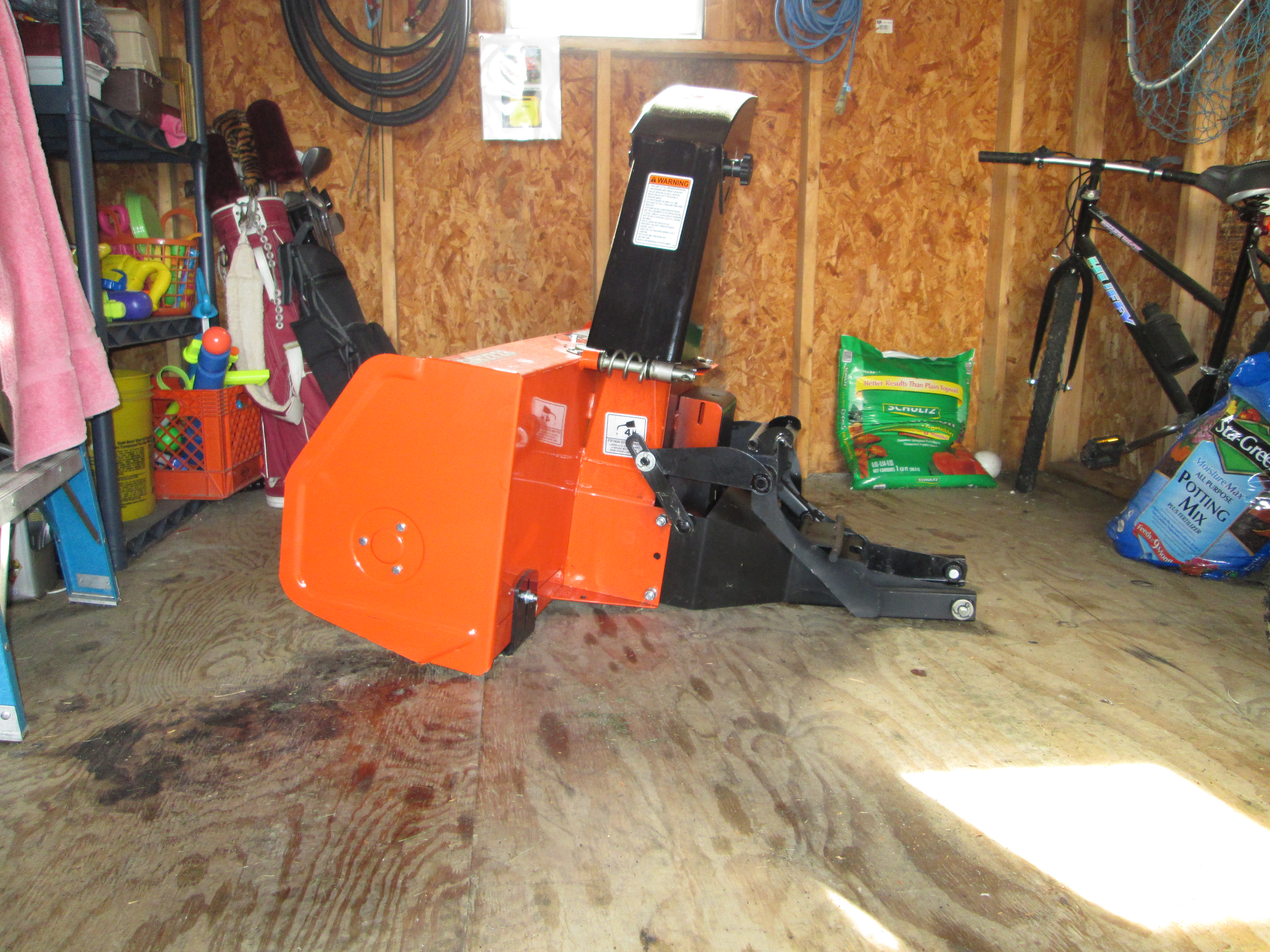

You'll want to be sure to get the subframe to hook to the tractor too, the blower is one piece, the sub-frame/quick front hitch is another....and is probably harder to find used, but you can get from the dealer new if you have $$$.
You can also look on kubota's website to see what attachments fit your machine.
goto kubota.com, choose US if your in the US, clicks on parts->illustrated parts->agree->type in your model (GR2120) and next to the model will be "local options", if you hit that it will show you all the attachments for that tractor. THe only blower shown is the 2707 two stage 48" blower. The subframe parts are part of the blower parts, but it is NOT part of the blower when you go to buy it, it's a separate kit because you can put the blade or sweeper on the same subframe/hitch.

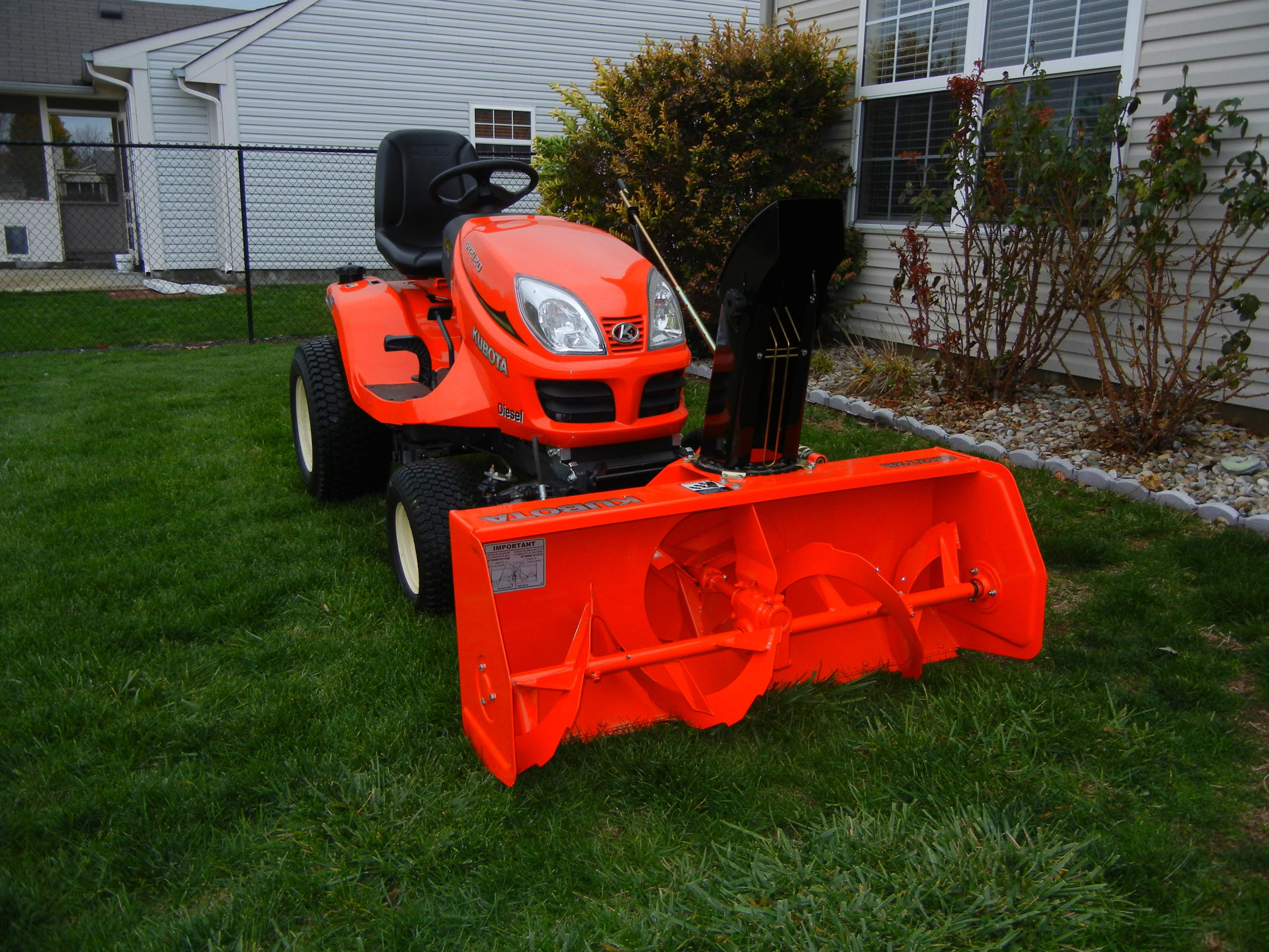

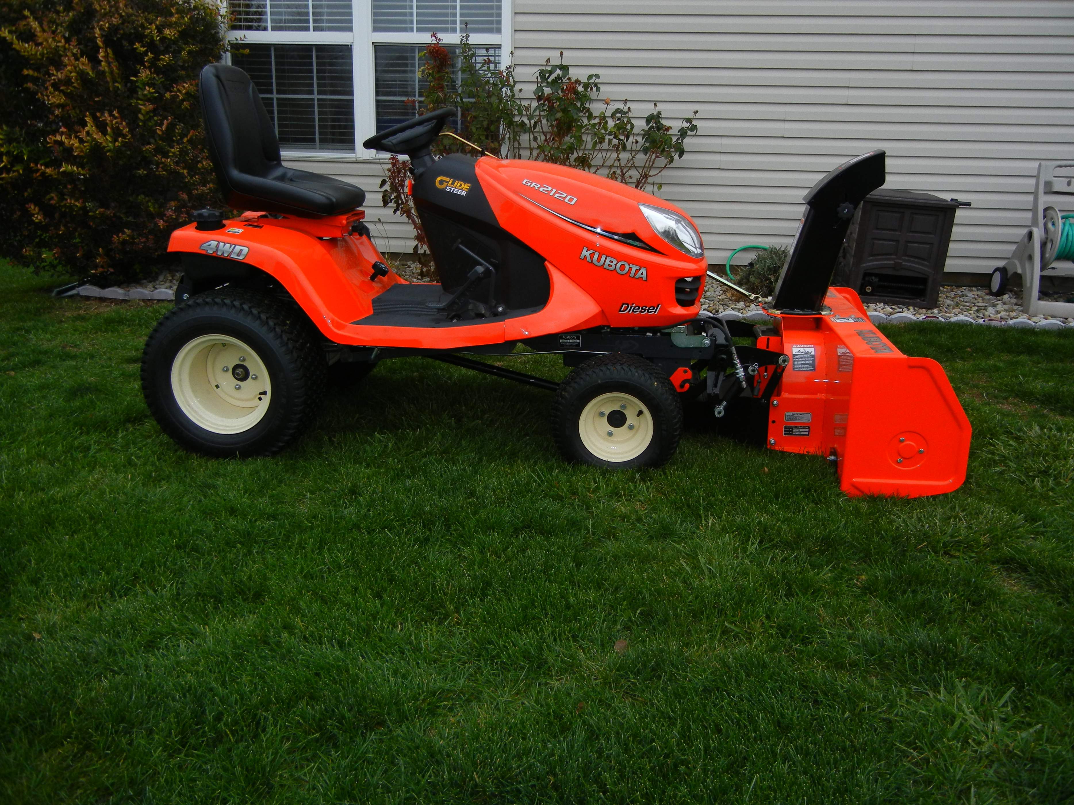

This pics should help. Philip.

It is raised with hydraulics. Uses the same lever/valve as the mower lift. If you look closely on the passenger side, you will see a hose, coupling, and cylinder. Philip.

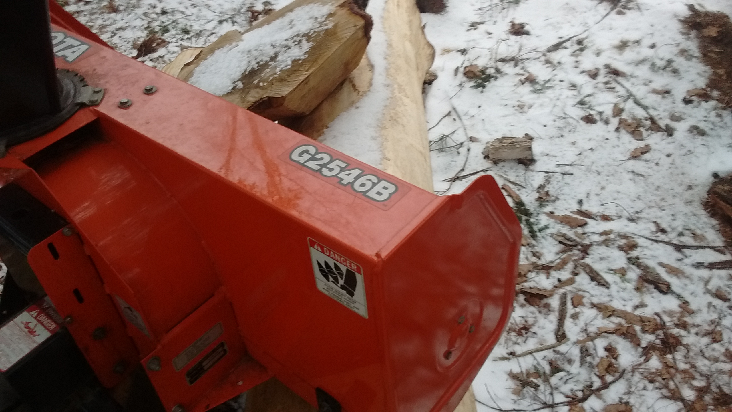

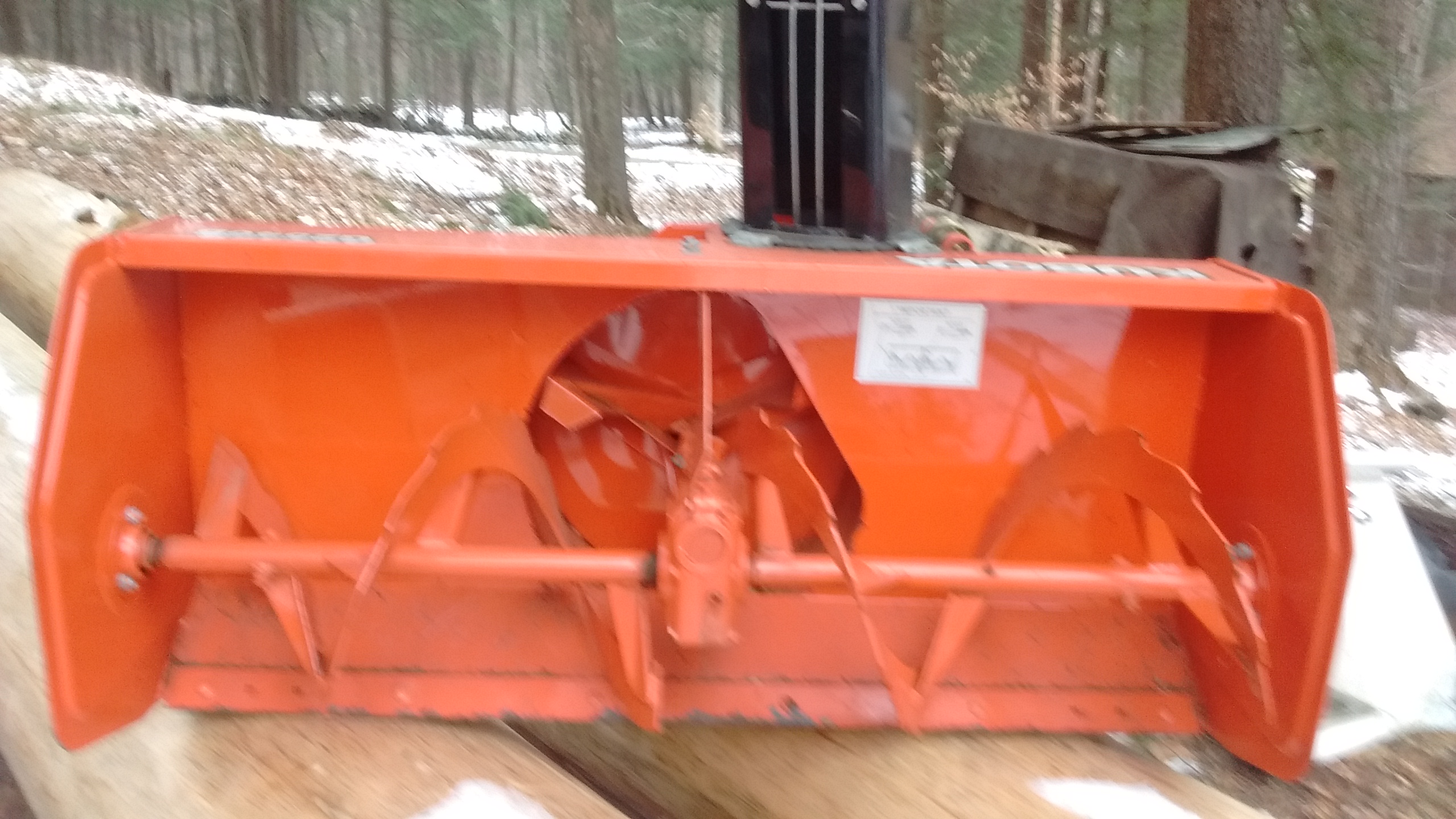

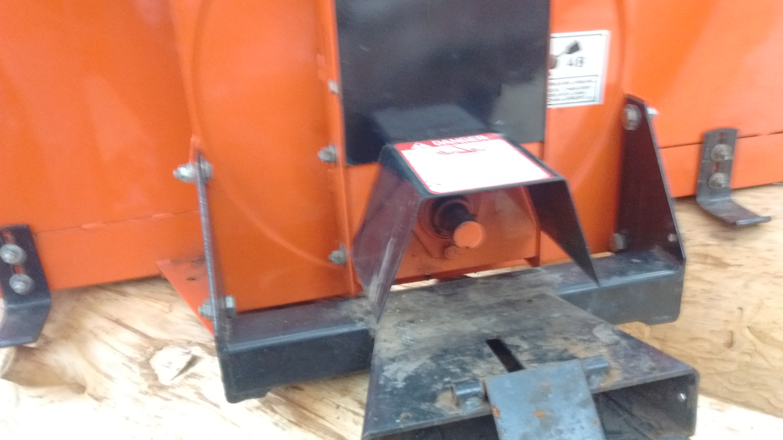

I have a G2546B blower assembly that appears very similar to the photos of the unit shown in the earlier post.
I do not know if it is a slide on fit to your machine. You will need to ask about the compatibility details. I can read the specs from the operators and parts manual and make measurements for you.
The unit I have is in "As New" condition. Never used, but moved a few times.
I'm in S E Vermont.
Yours for $650 ;-)

Thanks Guys, Well its good to know it works well and you don't need the weights. Yes, I'll have to get some other quotes. CalG, $650 sounds great, I am just not sure if it would fit. I'll have to do some research. SE Vermont is not too far. Is it shaft drive and hydraulic lift? Since it is G and not GR I suspect it may be too different. But I'll see what I can find out. If you have any pics you can send that would be great.
Thanks, Steve.
Thanks, Steve.
I can get some pictures next Friday. (I work from dawn to dark Mon-Thur)
I'm sure some sort of mounting adaptation would be required. The original lift was mechanical for the design application.
I'm sure the parts could be purchased from Kubota as well.
The unit is front PTO driven. So, shaft drive with a gear and chain speed reduction suited for about 2000 rpm input (Std Kubota front pto speed.)

pics, And the storm is on it's way!
