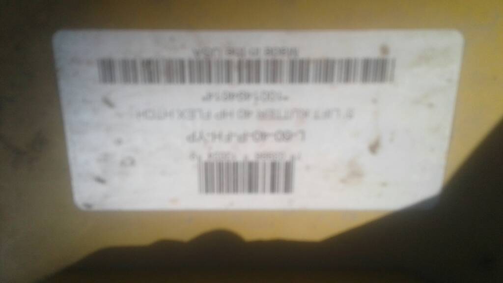

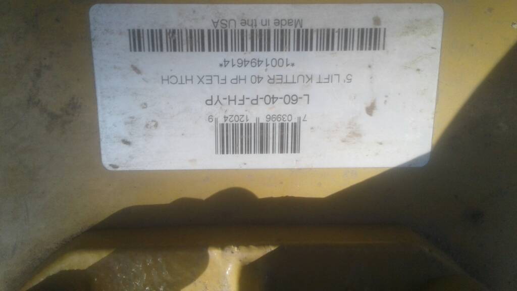

Where does it say it requires 40 HP ?
All I see is a 40 HP maximum gearbox rating
I run a 6' King Kutter brush mower on my 34 HP (28.5 PTO HP) just fine

Well, I can tell from experien've it will not handle heavy Johnson grass, slew grass, cat tails and large sunflowers. While a dealer will tell you virtually anything to close a sale, it is just a sales pitch and may not be factual. I purchased a 5 ft king kutterView attachment 522444View attachment 522445View attachment 522446 brush hog only to get to the truth the hard way. I have taken photos to show that king kutter recommends a 40 hp tractor for their 5 ft brush hog.
WRONG. 40HP gearbox. Thats the MAX. Nowhere does it recommend a 40 HP tractor.
6' cattails, 6' slew grass.....BLAH BLAH BLAH. You keep dodging the question as to how fast you are mowing? Because if its anything faster than 1st gear on your tractor....then your claim that the tractor is under powered for the mower is a great big load of BULL-sheet.
Maybe your tractor is a lemon. Maybe you have never cleaned your air filter or fuel filter and the thing only makes 15 HP. Maybe you are trying to mow it at 1.5" high. Whatever, who cares. Claiming a 30 HP tractor is too small for a 5' mower is BAD advise PERIOD. And when you keep making claims like that, and talking about what all these big farmers do with their monster 300-500 HP tractors....you loose all credibility. You wanna brag about your several hundred acres (while most of us here probably fall in the 5-25 acre range).....good for you. Go break your arm patting yourself on the back. I run a commercial mowing business. Not big but I mow 250-300 acres a year. Which is probably more than 99.9% of members here and most likely alot more than you. And all I can say is you are totally full of horse dung.
