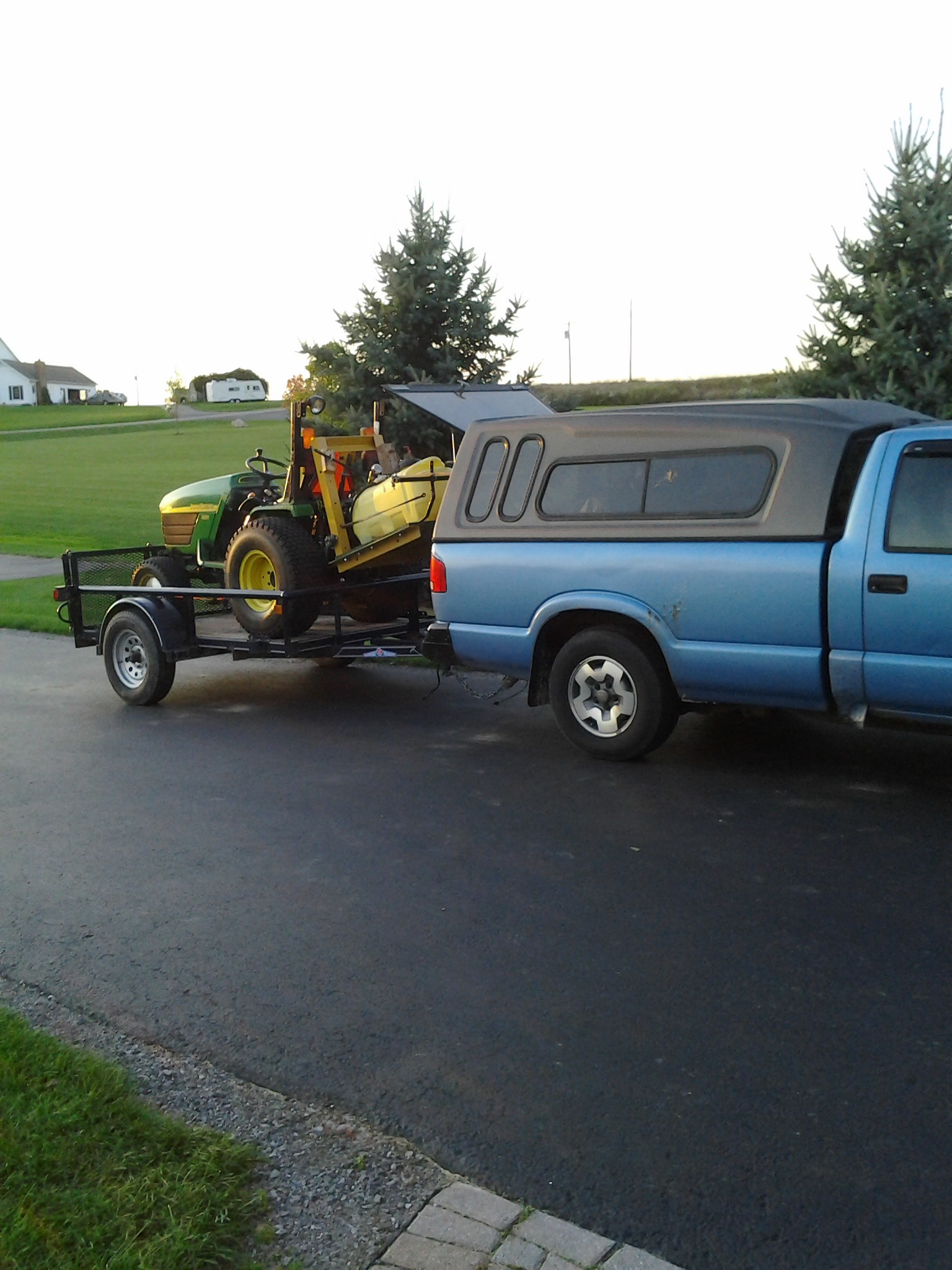

It would be for jd4110 (1600lb.& 9.5ft long) and a 5' or 8' rake? Maybe even another implement? Tow vehicle for now would be S10 v6 4wd with a bolt on Reese "3" I believe, I used it with a borrowed trailer which towed fine around town....or I have a TrailBlazer (for sale) I could use.

To be safe, I'd likely rent a truck whenever your going to haul the tractor long distances. That smaller truck will be a handful with 4000 plus pounds behind it....

Realistically, those 1/4-ton trucks all have exaggerated mfr towing figures. The people who tow with them are usually just taking their boat to the lake and probably don't mind white-knuckling it a few times a year. Whatever you decide to do, get a trailer with electric brakes, and a long enough one to position your tractor on it effectively (in your photo the S10's rear axle looks overloaded to me.) Or maybe trade that blazer you are selling for a 1/2-ton pickup.

A utility trailer on an S-10 is certainly no issue...You might be able to find a 12-14' tandem with brakes that you could get away with using an assumed 4.3, correctly geared S-10..I wouldn't go bigger than that with any kind of load..Trailer brakes are a must in my humble opinion...

This has nothing to do with tow ratings per say. GVWR is "gross vehicle wheel rating" That simply means the max amount of weight that can be on the vehicles wheels. Lets say for example your truck weighs 4,000# with fuel in it and you are 200# plus you carry around 150# of junk in the bed. That would mean you now have 800# of payload capacity. Payload is anything on the trucks wheels like additional stuff in the bed, extra passengers, tongue weight of a trailer, ect.
What you need to find out is the the GCWR "gross combined wheel rating" This is rating is the max weight on the wheels of both the truck and trailer. Lets say its 9,000# for example. Now you simply subtract the weigh of the truck loaded from that and it will tell you the tow rating. This is only in the owners manual, not on a door sticker.
If you give me the year, engine, tranny type, rear axle ration, bed length, cab style I can look it up for you. I am a part time trailer dealer and have access to all this info for most stuff built in the last 15 or so years.
As for a trailer a tandem axle is probably going to weigh too much and kill your payload on the trailer. A single axle trailer with a 3,500# axle and brakes on that one axle is going to weigh about 800# so it will have a honest 2,200# tow rating. This will probably be the best you can do. I think 2,500# plus the weight of the trailer is going to be a bit much for a S-10 because you are going to be pushing the 5,000# mark by the time you add in the empty weight of the trailer.
You really need a 1/2 ton truck for this.
