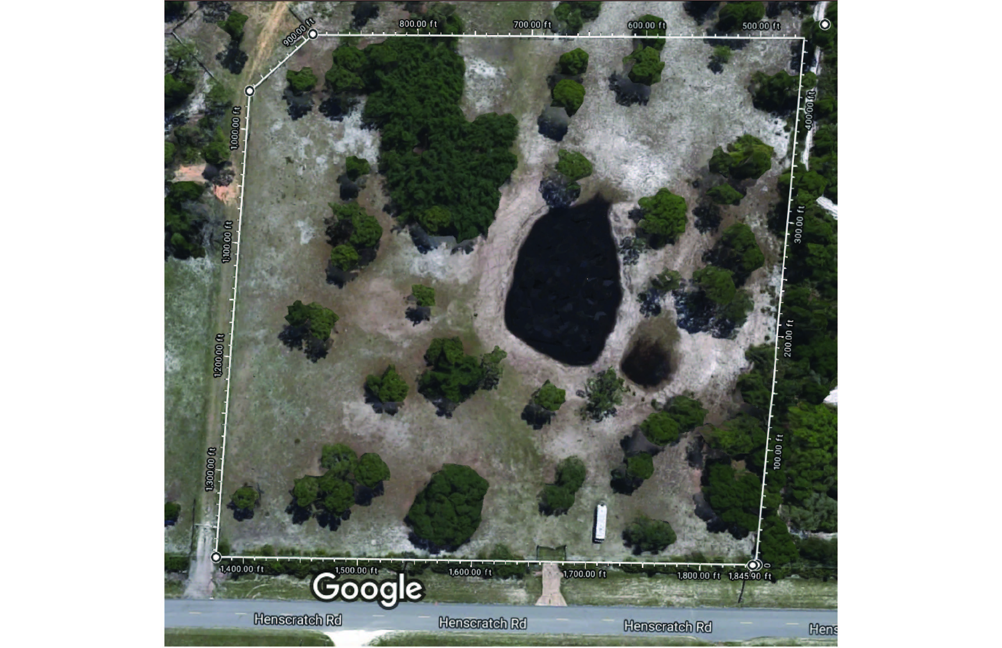

My wife and I have just purchased 5 acres in central Florida and would like to get a tractor to mow, move dirt, plow small garden, etc. Mostly flat sandy soil with pasture type grass. My plan is to seed with Bahia and have a couple of miniature donkeys and goats.
My question is about the size of tractor I'm looking at if it is the right size or to small or to big. Picture of property attached.

Great looking property, looks like unlimited potential. My vote goes to the Massey. I have a 1742 cab tractor, purchased late last winter. The cab is a neccessity up here due to the cold and snowblower duty. The Massey is the perfect size in my opinion, for the purposes you have in mind. Mine sees use with a verge mower, bush hog, land plane, hydraulic front blade along with the blower. Also just in the process of building a grapple for it.
/ What size tractor is right? #3
looks pretty flat. you should not need a whole lot of tractor. you could easily get along with a +- 25 hp 4wd tractor. i would also go with hydro. remember it won't hurt to go bigger either. how much dirt moving to you plan on?

Any of these machines will serve you well on five flat acres of sandy-loam in Florida.

Thanks for all the info guys!!! The videos were very helpful. We went and looked at some Kubota's today and I'm leaning toward the B2601. With having a pond and trees on the property I really only have about 3 to 4 acres to mow. There won't be a lot of heavy loader use so I don't think I need the L series. I did see that Goodyear has a new R14 tire that Kubota is putting on some of the 2019 B series. It's kind of a mix of turf and tractor tire.
