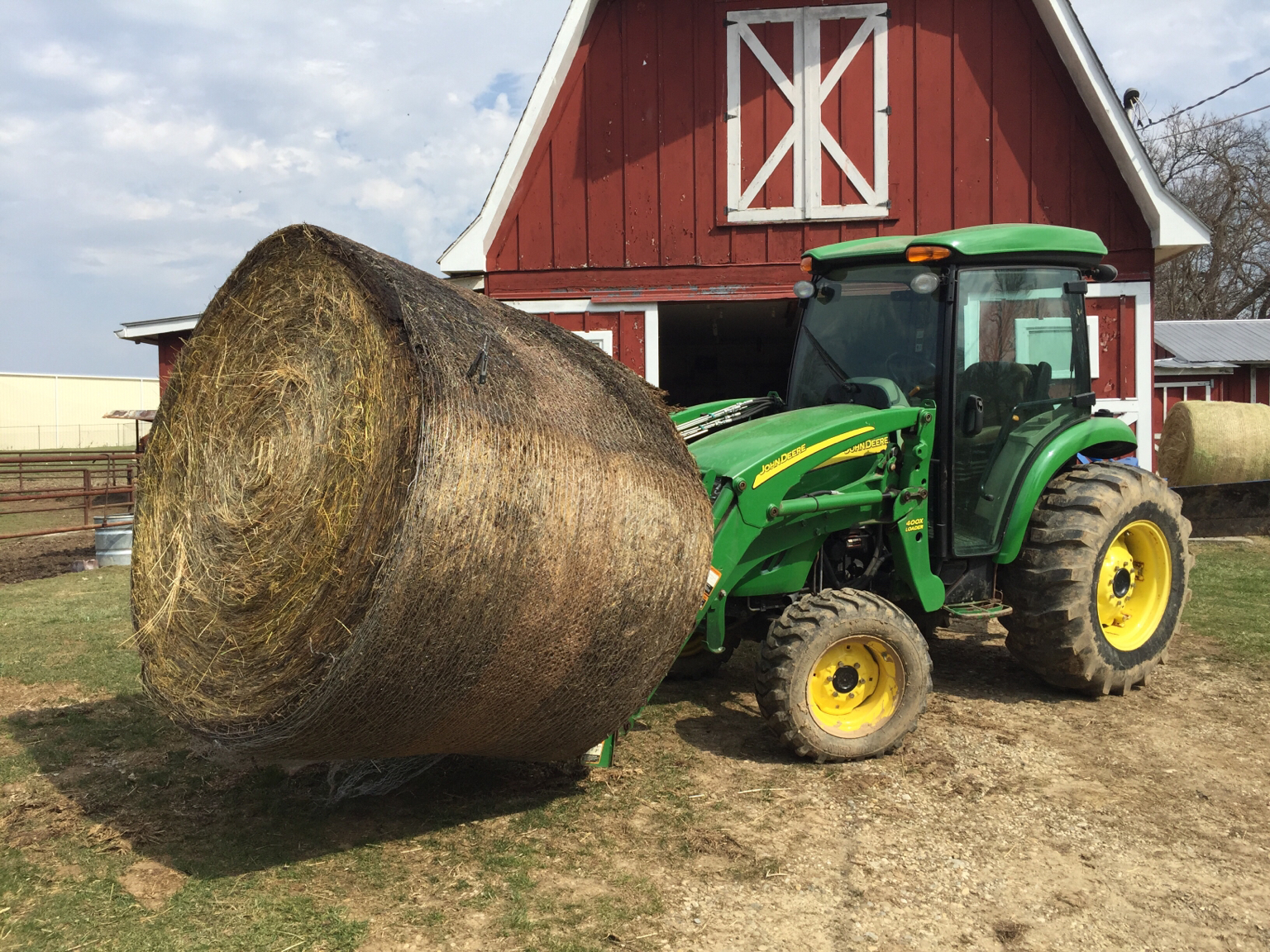

I would say 5 family series JD or larger, not sure what that is in other brands. HP is rather irrelevant when it comes to loader work but I would say 50hp plus.

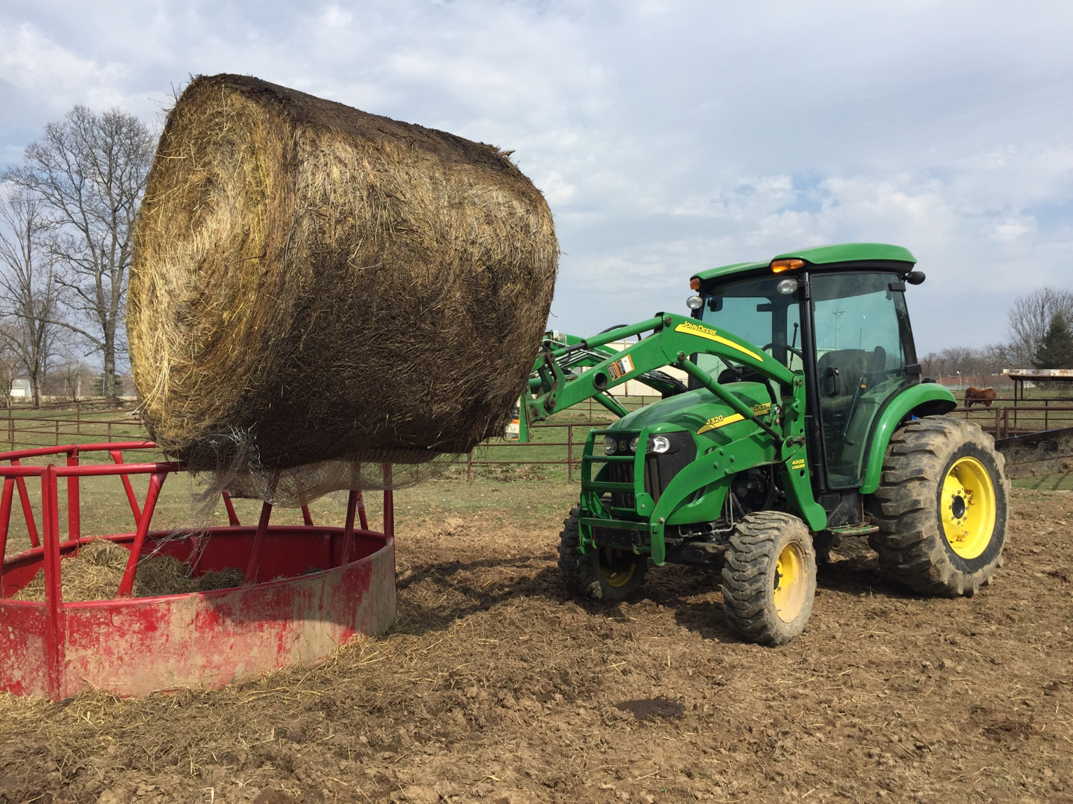

I have a 4 series and with big round bales I wish I had a bigger tractor for stability reasons. I suppose a 4 series would do it but would be pushing its limits. IMG_7252.JPGIMG_7250.JPGIMG_7255.JPG
Pallet forks on a 6x4 round bale, around 1200lbs maybe more, I haven’t bought another that big since and don’t plan to.
I have around 30psi in my front tires and 12psi in the rears, you can see how stressed the front tires were on that bale.

I have a 4 series and with big round bales I wish I had a bigger tractor for stability reasons. I suppose a 4 series would do it but would be pushing its limits. View attachment 525273View attachment 525274View attachment 525275
That tractor is rated to lift 2100 or 2300 pounds to full height at the pins. My tractor was rated to lift 1800 pounds to full height at the pins. Lifting a 1200 pound 42x48 pallet to full height was about all I could do. I don't think that tractor will ever load a 2000 pound pallet on a semi truck. ( I'm making assumptions here. The op never said what he was doing. )
Mine is 2368lbs at the pins at full height, 1742lbs 500mm from the pins. 500mm is only 20inches or so. 500mm is the numbers I look at.
My 400x loader to 1.5m at 500mm is 2181lbs, add the pallet fork weight on the 2000lb load and I don’t think I could load a flatbed semi trailer single stack. Would have to get the 400cx loader which prob could if you spend a fortune making the rear heavy.
I stick to the 5 series or larger size wise, not sure the comparable tractors in other brands.

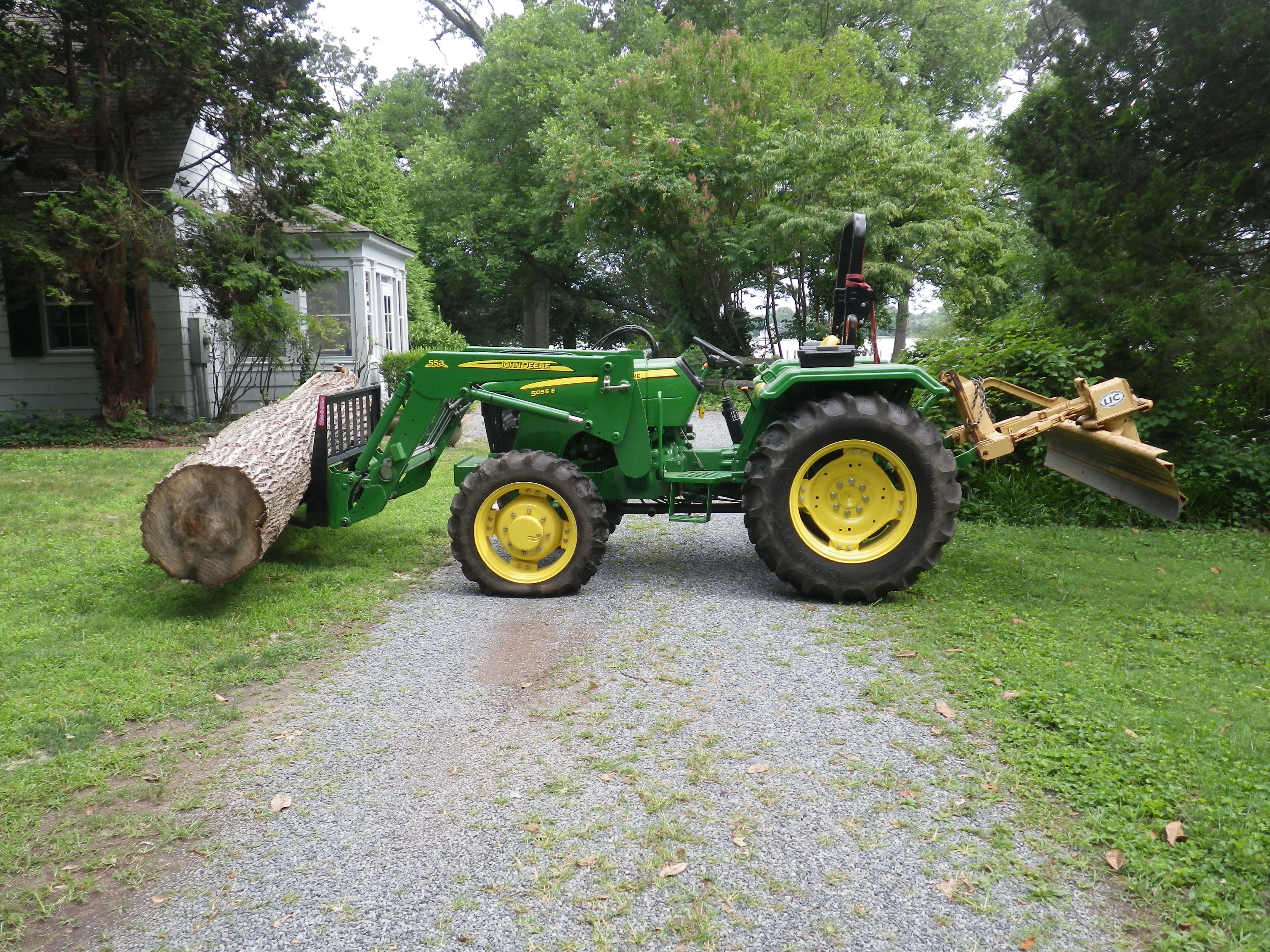

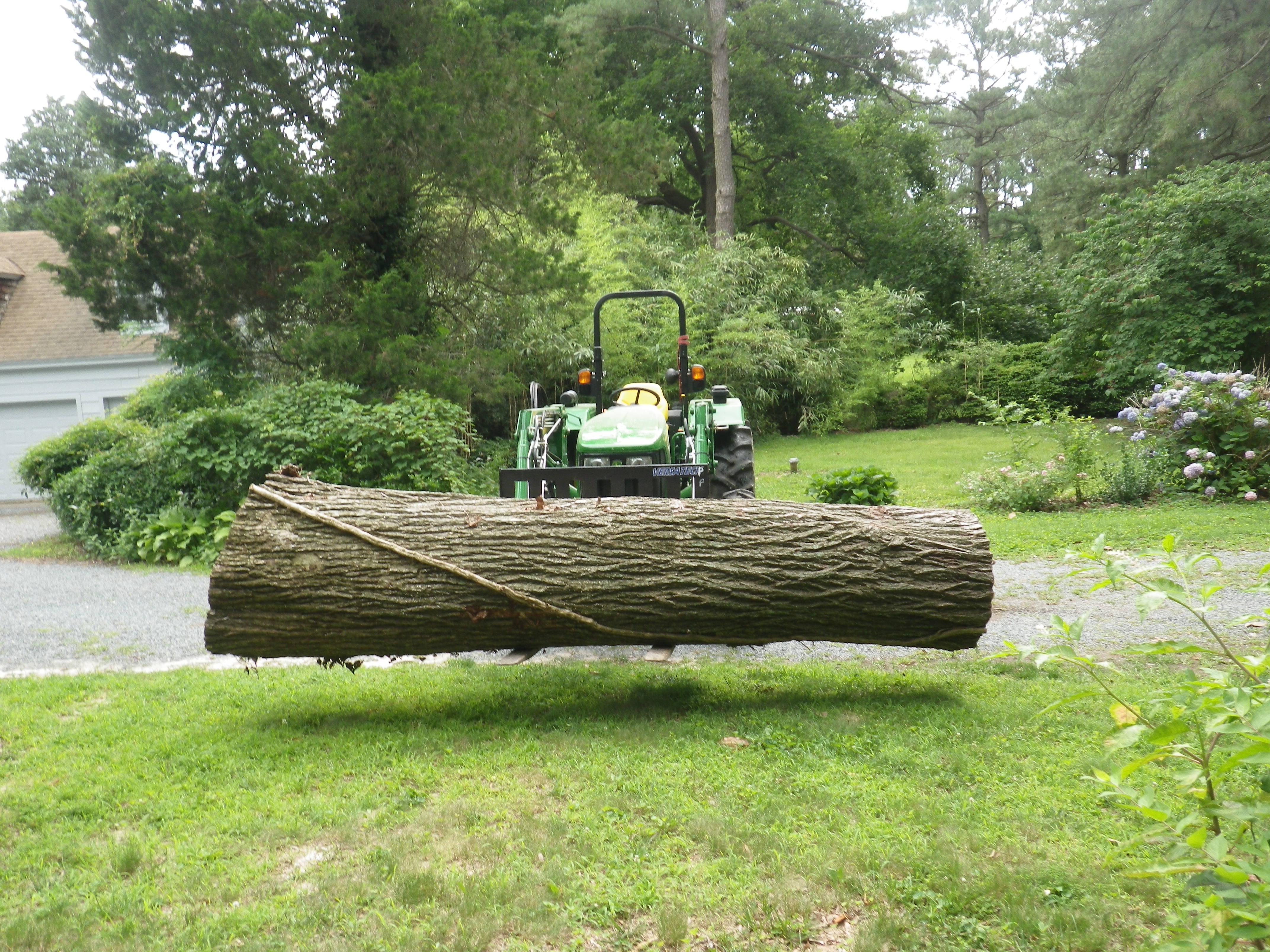

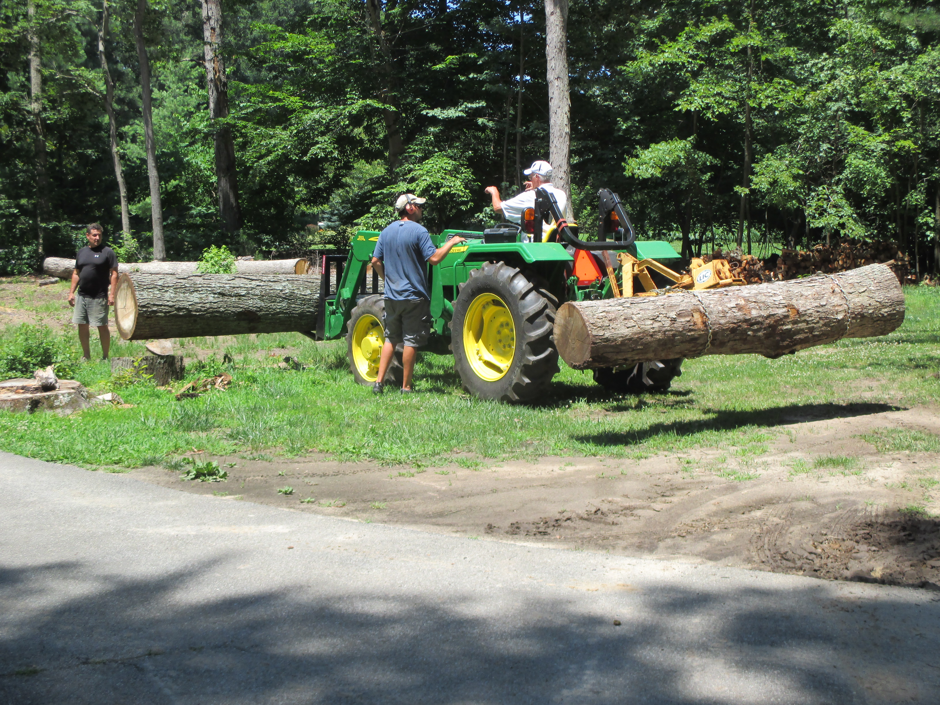

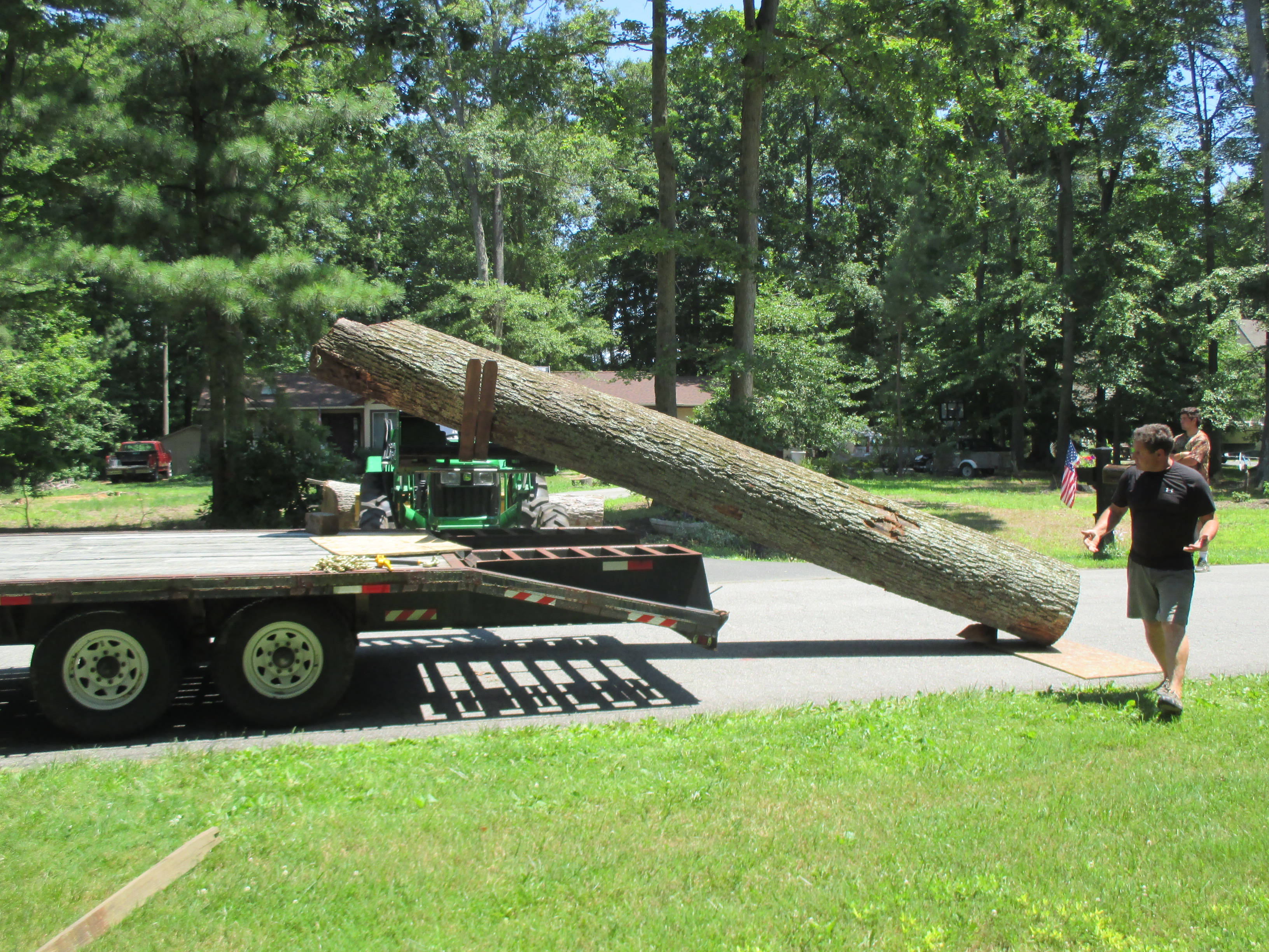

you don't need a 100hp tractor. the 5 series deere is plenty. i have a 5055E with the 553 loader. loader specs almost 3200lbs at the pins to full height and almost 5000lbs to 59" again at the pins. i can't remember what the measurements were 500mm and 800mm in front of the bucket, but i could check the owners manual at the office.
couldn't lift this log onto the GN, but it would lift it almost high enough. green white oak i think it was 15 ft long and 30" around
this was elm 34" on one end 40" on the other 13-14 ft long. had to remove the fender to loader it on my car trailer
Specs for your loader
Breakout force (at pin) 5,378 lbs [2439 kg]
Breakout force (at 800mm): 3,604 lbs [1634 kg]
Lift to full height (at pin): 3,133 lbs [1421 kg]
Lift to full height (at 800mm): 1,956 lbs [887 kg]
Lift to 1.5m (at pin): 4,008 lbs [1818 kg]
Lift to 1.5m (at 800mm): 2,891 lbs [1311 kg]
